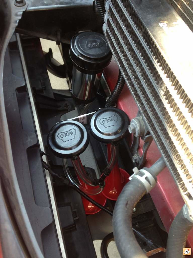

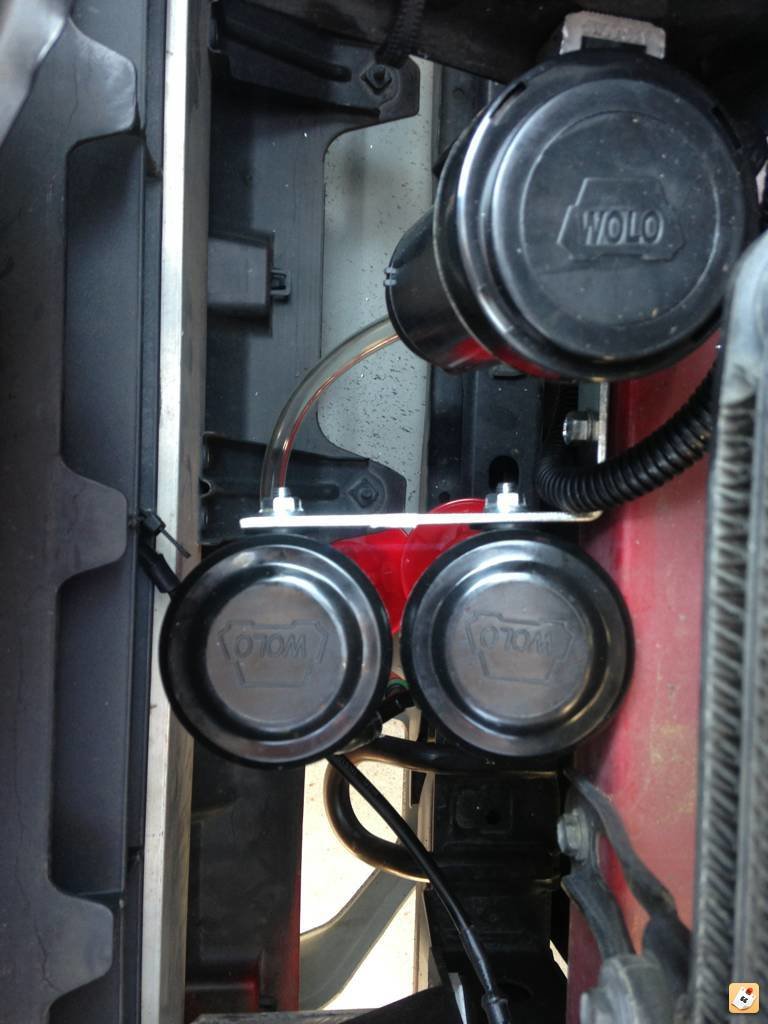

    Just a little cheap fun upgrade. Kit was $30 for two horns and a compressor. Wired it to work with factory steering wheel horn button. Definitely loud!

    Is it a simple PnP for the wire harness to work with factory Horn?

    Nice! How about a pic or two of the wiring setup?

    I did a similar thing with the bad boy air horn. I used the steering wheel horn wire to power a 12vdc relay and hooked the relay contacts to the 12v air horn. I do not think/know if the steering wheel horn switch could handle the current of a large air horn directly.
