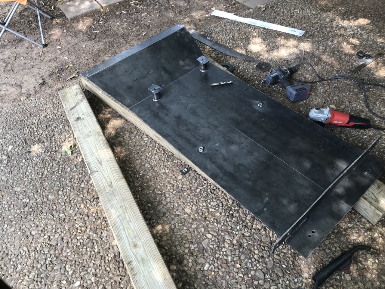

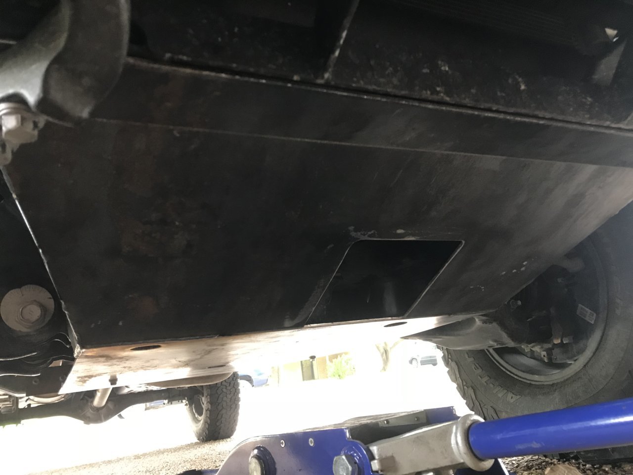

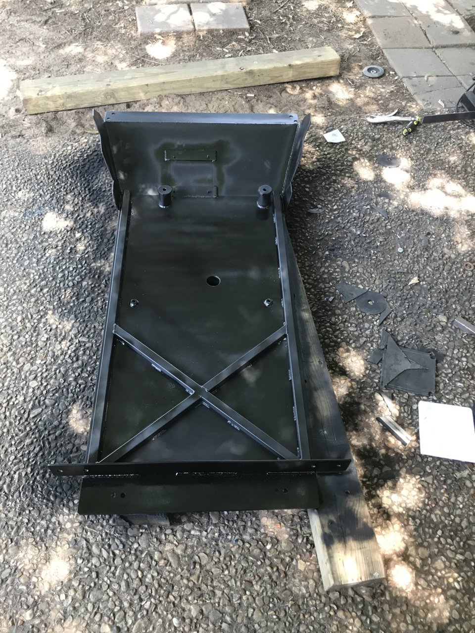

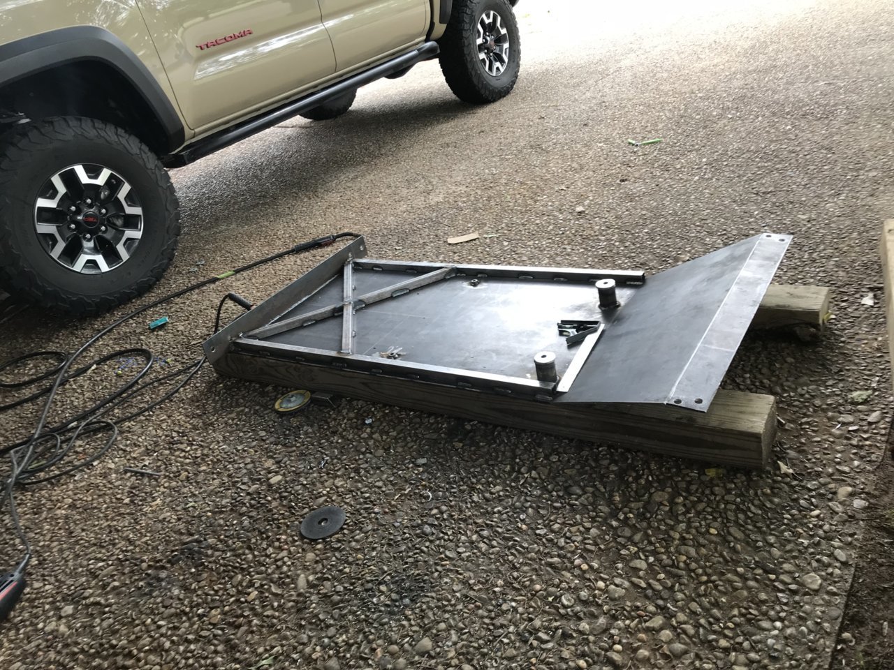

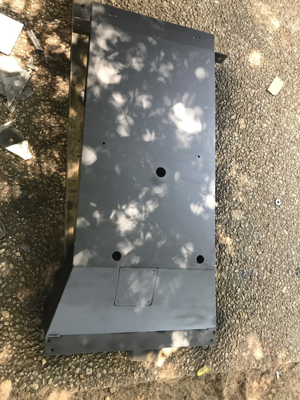

    Just curious why you didn't protect the cam tabs with the skid, seems easy enough to flare out a bit before them?

    I am planning on incorporating them into the control arm skids. Just haven’t gotten around to it. That way I don’t have to pull the belly skid for alignment and things of that nature. I can pull the control arm skid and I am good to go that kind of maintenance.

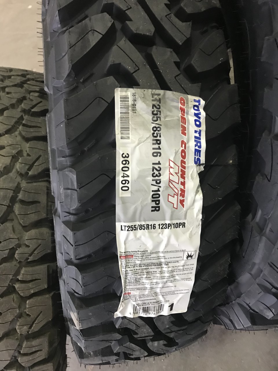

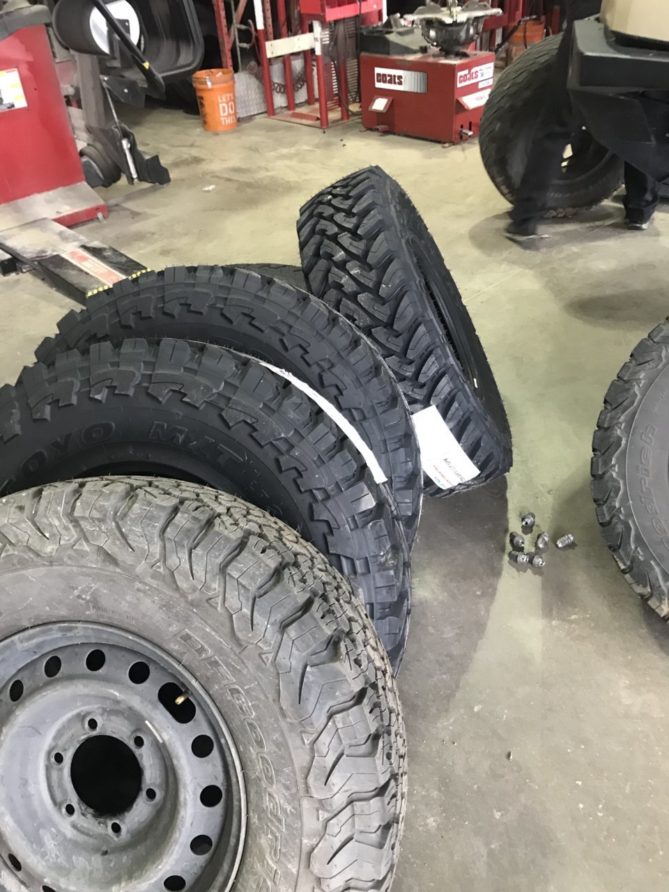

    New shoes today... got rid of the KBro2s and went with the Toyo open country MT in a 255/85r16. Pizza cutters FTMFW!4818DD75-78E1-466B-B74F-FF22EED71248.jpg35AA02FC-0FEF-43E0-8410-CD5478CB88CB.jpg11C55988-D881-41BD-8211-BF791BDA05B4.jpgEA4D9B95-90D5-4776-9661-9C13898D5B74.jpg

    Looking narly. Never see/hear much about Toyos so curious how they'll be.

    I have been running them for several years on my Cummins and I can normally get 60k+ miles out if them. Hopefully I can do the same with this size tire. I am running 37s on the Cummins so a lot less revolutions per mile. I am curious to see how much difference the smaller diameter makes on the treadwear.D345CEC3-7529-44A4-923D-EDF6214920F6.jpg

    I got about 40k miles out of mine and at the end they were loud and pretty rough. They still had plenty of tread but the ride wasn’t smooth anymore.

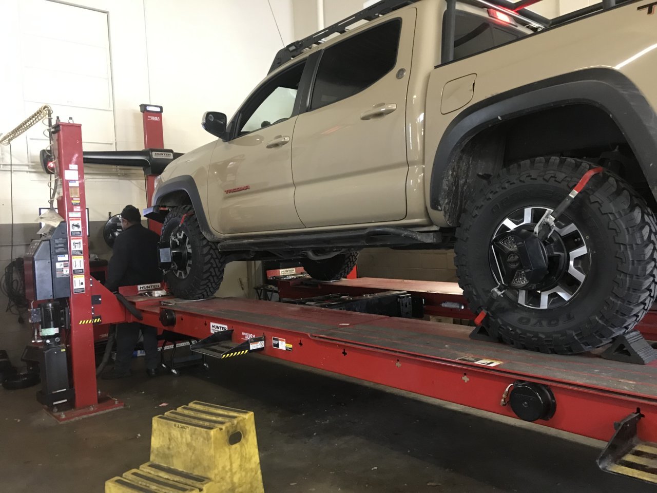

    Looks great. Do you have a lift? Any rubbing?

    Old man emu 886 coils, 90001 struts, LR UCA up front. Dakar heavy leafs in the rear. Caster set at 3.5* on both front wheels. No rub even with the front stuffed at full lock.
    My taco lean seems to show more with these than it did with the 265/75r16 KO2 they replaced so I will be adding a top plate spacer to correct that. I will actually be putting a 1/4” top plate spacer on the passenger and a 1/2” on the driver for now to get back a little of my lift. Bumper, winch, skids, sliders, dual batteries, roof rack and solar setup put a good load on the front axle. I am going to see how this does for a while but will most likely be swapping to the OME 2705 coils on the 90001 struts. The 2705 coils are 13mm longer free length than the 2886 coils and have a 720 lb spring rate as opposed the 660 lbs on the 2886.
    Road noise is no worse than my used up KO2 were for the last 10k.
