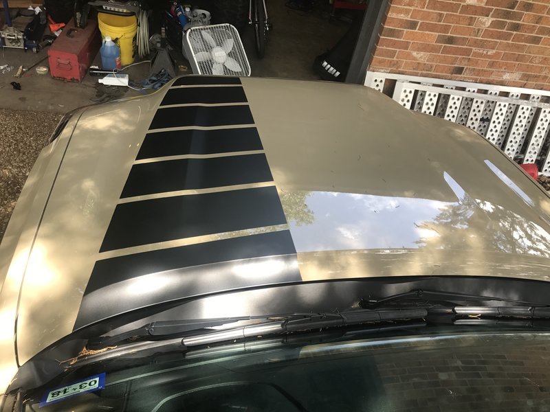

    Got my hood stripes put on today. I believe these are the first of this style to be installed on a 3rd gen. Thanks @crawler300 you did a bang up job brother.IMG_3478.jpgIMG_3479.jpgIMG_3475.jpg

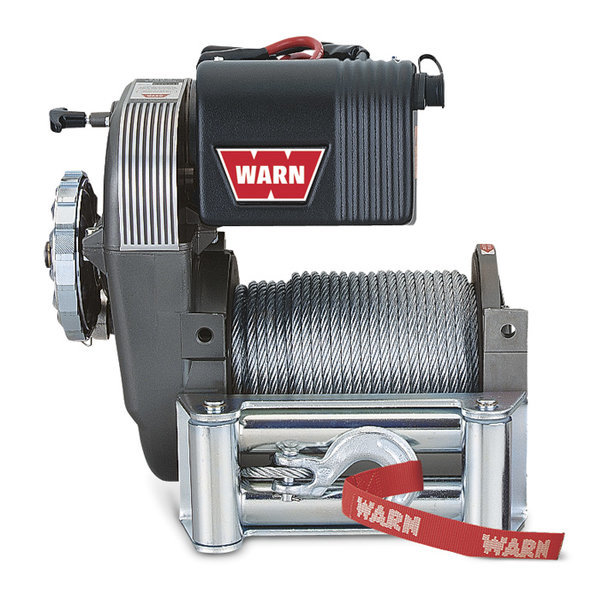

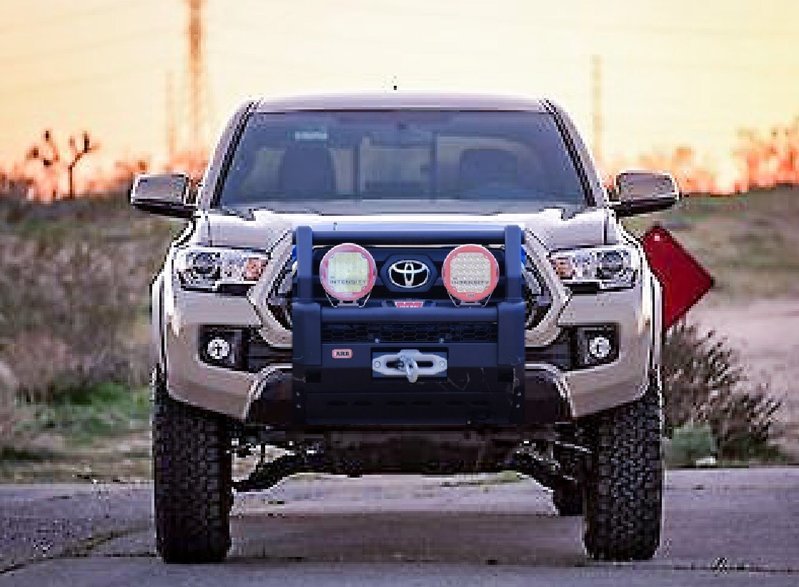

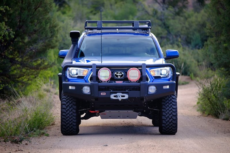

    Bumper planning stage 1.1
    I really like the look of the ARB but not the weight and decrease in approach angle. Not to mention the sections under the headlights and headlight guards are hindering in the tight trails that I commonly find myself on from my past experiences. The amount of protrusion in the ARB Summit bumpers just kind of sucks in general due to the built in impact zones in them.0A629D54-0980-47C2-B8C0-F5DD7CAF2DA5-282-000000710B9F4F03.jpg
    The slimline bumpers have an appeal to me as well but the lack of crucial component protection bothers me. They also lack a mounting area or protection for the ARB Intensity lights that I have collecting dust on my shelf. Use with a Hi-lift is also not readily available with these.D2CBFDC8-D080-43FA-832D-E2AF693055B3-8957-000002854C56E55D.jpg

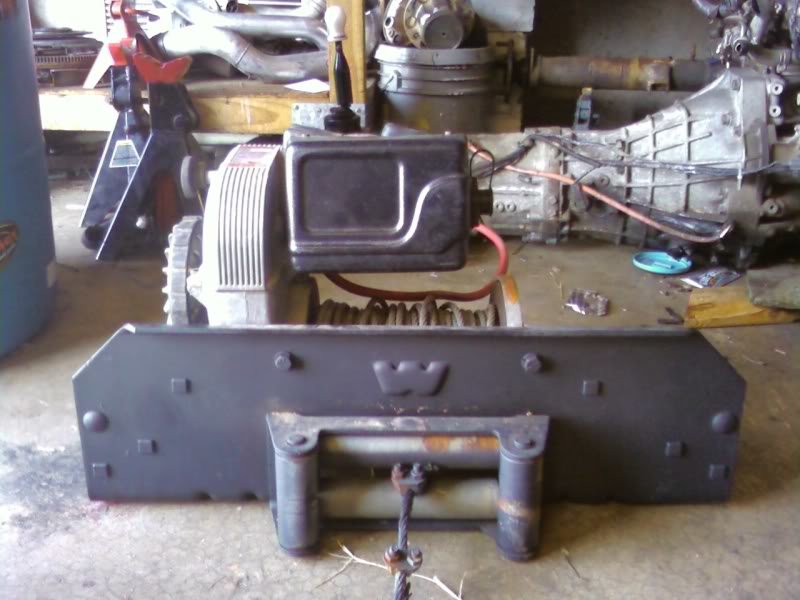

    I also used to run one of the old school Warn winch trays with a Warn 8274 in it and like the look of it on my old rig. I built a set of uprights and a top cross bar for it and it served me well for better than a decade. Functioned as a winch mount, radiator guard, light mount and push bar.27FFF2F6-45D3-4B16-9407-5808F6CF6E04-8957-00000286C4EF33EB.jpg
    I still have my 8274 (3 of them if you want to get technical) but will not be using it for this simply because they are not terribly reliable though they are strong and fast spooling. I do still love these damn things for the simplicity, strength and dashing old school looks though. I'll be running a planetary winch with synthetic line for this application for the lower profile.
    My plan is to run the three designs together and come out with a strong functional bumper that suits my needs. Winch mount, recovery points, Hi-Lift comparable, component protection, not to heavy, GARBMFL mounting location, ability to use as a push bar in a pinch, aesthetically pleasing to me and built out of materials I have on hand with my own two hands. Oh yeah and it will hide the massive grill that I am still not to fond of.
    Crappy photoshop of my insanity.

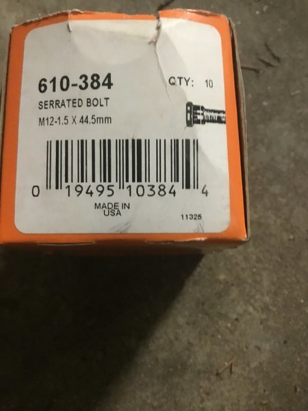

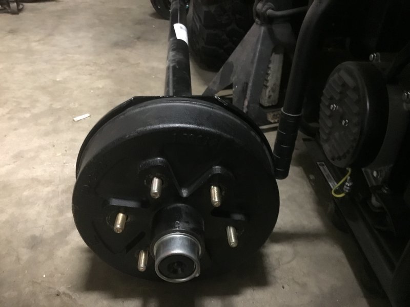

    Off-road Trailer build is happening. First order of business is this axle. Dexter 3500#, 67" hub face to hub face, 10" electric drum brakes.

    (6/17/16 Material picked up )
    Tacoma suspension

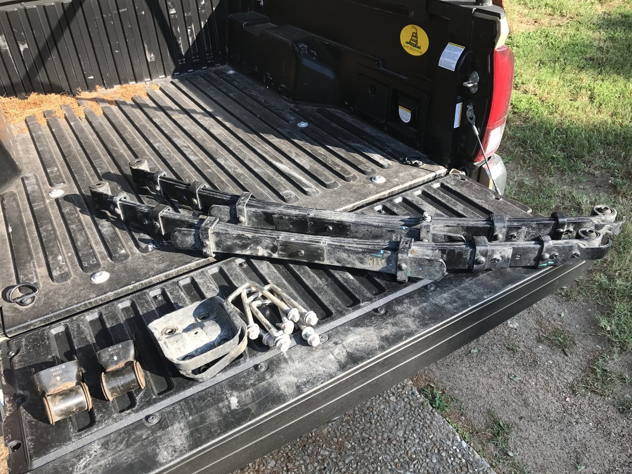

    (6/23/17 shackles received from @Texoma)
    (6/25/17 Tacoma springs, u-bolt plates and u-bolts picked from @riz_atx)
    High angle hitch coupler
    (Researching weather its cheaper to build or buy.)
    Full size tires same as Truck
    (6/19/17 Changed studs in trailer hubs to same thread as truck: Dorman 610-384)
    (6/19/17 assembled wheel hubs on axle)
    Wheel base matching truck wheel base
    Departure angle same as truck or less
    Hitch and truck frame level when loaded
    Adjustable height RTT mount
    270* awning
    (6/17/17 ordered 10yards tan 70d 2oz ripstop )
    (6/19/17made arrangements with http://www.ohenrytents.com/ For awning build)
    (6/23/17 canopy material is on site.)
    Lockable doors & gate
    3500w generator 110-220v
    (purchased before hand)
    12v dual battery setup with solar
    On board water 20-40 gallons, heated?
    Kitchen area with fridge
    Table storage easy access
    Detachable/folding/reversible tongue ?
    Stabilizers and retractable jack.
    Swing out tire carrier
    (Looking for Tacoma spindles have a crazy idea.)
    LED lighting end to end, area lighting
    Lift?/recovery points
    Rear winch?
    dry storage area

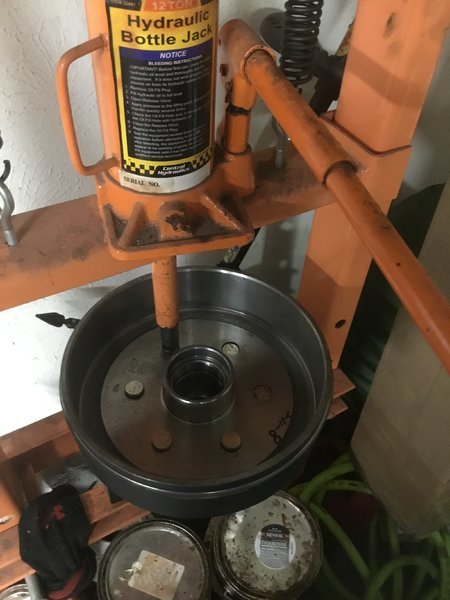

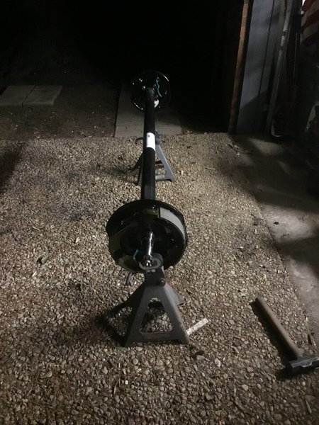

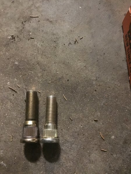

    Thinking things over today while in the waiting room at the doctor I realized the trailer axle had standard lug studs.... That ain't gonna work. Stopped off at the local parts house and brok out the books and schooled those kiddos on how to improvise. Located a Dorman 610-384 wheel stud that is a good fit for the Dexter brake drums I am using. The original trailer studs were 1/4" to long to use with the shank style lug nuts to begin with.
    Got the studs pressed in and then went on with the axle assembly. Brake backing plates torqued down, wheel bearings packed with Mystic red high temp and and fully assembled.

    Thanks to @Texoma and @riz_atx for the suspension components. Those should be in hand by Sunday. Still looking for a set of low mileage Stock rear Bilsteins.

    Trailer suspension parts are on site now. Everything but the Bilstein shocks for the trailer still need to find a lightly used set.

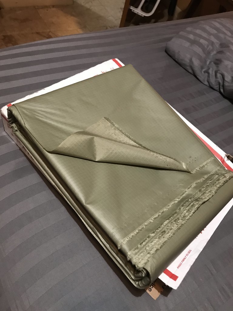

    Also my canopy material came in for my 270* awning. 10 yards of 2oz RipStop. If I can get more than a day off at a time to do something with this stuff... Yes I'm building my own awning. IMG_3533.jpg

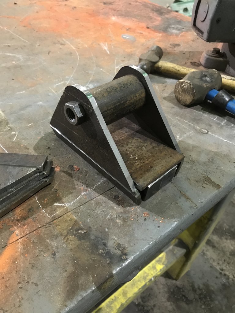

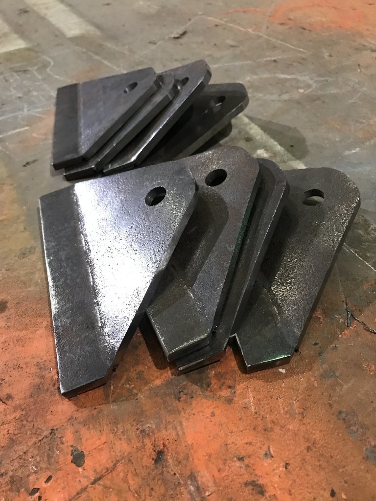

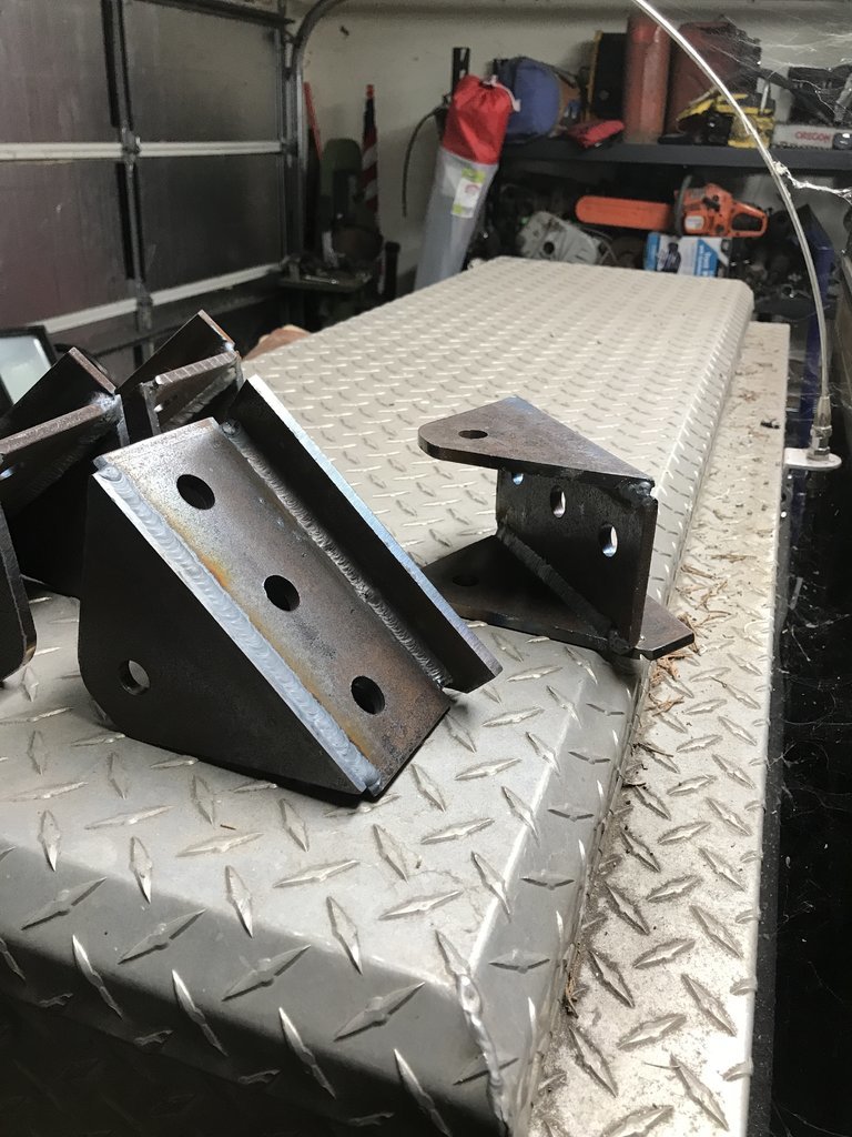

    So I got a little free time and got my spring hangers fabricated for my trailer.
    They still need some finish work done on them but they should be plenty stout for the trailer. The 3 holes in them are so they can be rosette welded to the frame on the bottom side.

    Little trailer update for y'all.
