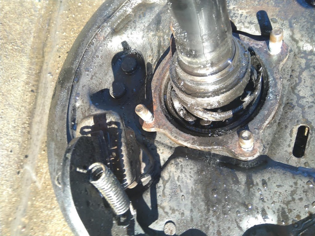

    Though I had an intermittent whomp whomp sound on mine that would come and go depending on the week. Didn't get louder when turning, have any play in the wheel anything else that made me really suspect a wheel bearing. Wasn't till I was 400 miles from home at the end of a 2 week trip that it really started making grinding noises and causing problems. Didn't realize how bad it was till I pulled it apart. The cage had fallen apart and the balls were free to move in and out of the race. They trashed the ABS tone wheel and rolled a grove into the axle. The whole time it had sounded like the noise was from the front, didn't realize it was the rear till the seal let go and it dumped all my gear oil.

    Wow! That's too bad! It seems like it was something pretty simple as the shop I took it too seems to have "fixed" (at least temporarily) the problem accidentally while checking it out. They might have been right about the caliper sticking, but just in poking around (which I'm not even sure they did much poking in there) they got it unstuck? Anyway, feeling good about it for now, keeping an eye on the pads and obsessively listening. I plan on replacing the calipers to make me feel better. I don't like it when I don't understand why something fixes itself.
