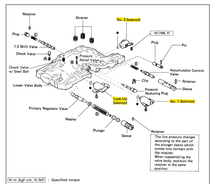

    Wow that thread has an abundance of info but I haven’t found much specifically on the solenoids unless it was brought up in the comments by other members.
    I’m surprised at how little info there is even on YouTube for these. I have found enough though to understand how to remove them (I think). Some info I’m still looking for is:
    1. How many solenoids are there? I believe 4?
    2. Are they all the same like fuel injectors and spark plugs? Or is each one specific? I’m starting to see them numbered now on rockauto and the oriellys guy was asking too.
    3. I’ve gotten two quotes on these from Napa and oriellys so far and even their numbers are expensive for me right now. What brand is preferred for these if can’t do oem? Shop mech said Denso should be ok for now. Anyone used Denso solenoids?
  13. May 5, 2023 at 5:05 PM
  14. May 5, 2023 at 5:09 PM
    Logans2001
    Logans2001 [OP] What’s crackin’
    Jan 23, 2016
    #175792
    1,974
    San Diego, CA
    2001 v6 4WD auto
    BINGOOOO. Thank you sir, I was having trouble downloading it for some reason.

    So as of right now this is what I have in mind.
    Drop pan. Test each solenoid, resistance test right? Find which one is faulty. Replace that one and pray it should be that easy. I’d replace all 4 but these things seem to be going for around 200-400 each. And that’s not even oem.

    FYI - updated doc attached. Supersedes TC009T04.
    For whatever naming reason, in toyota's infinite wisdom they decided to remove the "line pressure control solenoid" from the ID doc.
