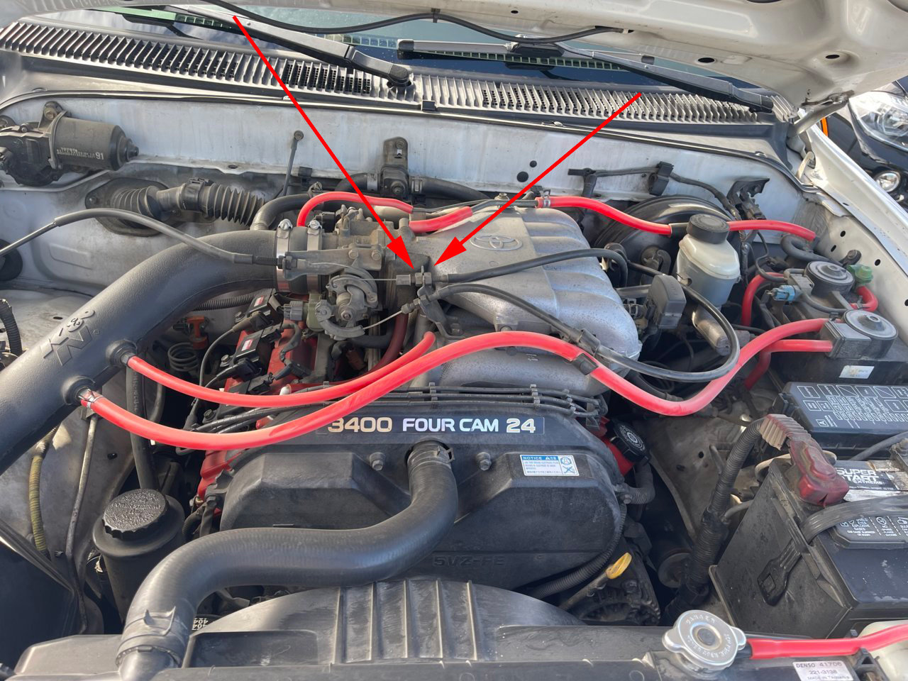

    Is there a cable on your throttle body going down to the transmission ?
    That cable tells the transmission where your foot is on the gas pedal .
    If the cable came off or went out of adjustment for some reason , your truck will not move well .

    I’ll double check the trans fluid tomorrow. I wanna say I do have a transmission kick down cable on the TB? I have 3 cables going to the TB. What sort of pressure gauge would I get and where would I hook this up to?

    Yep, you do. That didn't change until 03 when they did away with it.

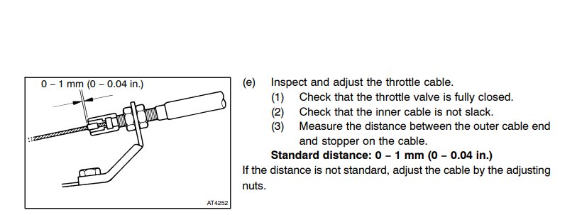

    I actually was just looking at this the other day. This video isn't a Tacoma but it gives you a really good idea on how to adjust. Below illustration and steps are for the tacoma.
    https://youtu.be/N_eNN_olgnA

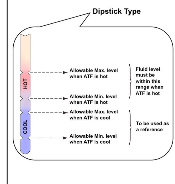

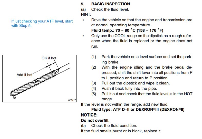

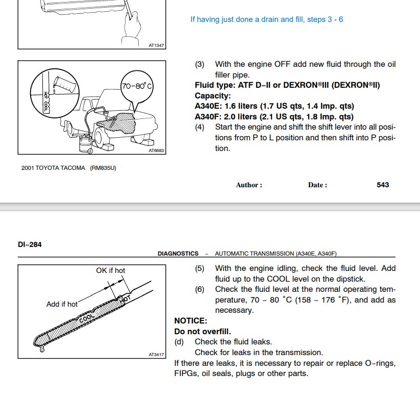

    100% agree with @gearcruncher that there is sometimes a disconnect on the proper way to check the trans fluid level. This is the process I follow based on the AT Precheck Info from Toyota.
    If doing a drain and fill of the ATF, start here:

    I would skip the pressure gauge purchase for now .
    With the information posted above this post , thats going to give you the tools you need to verify you are getting the correct pressure.

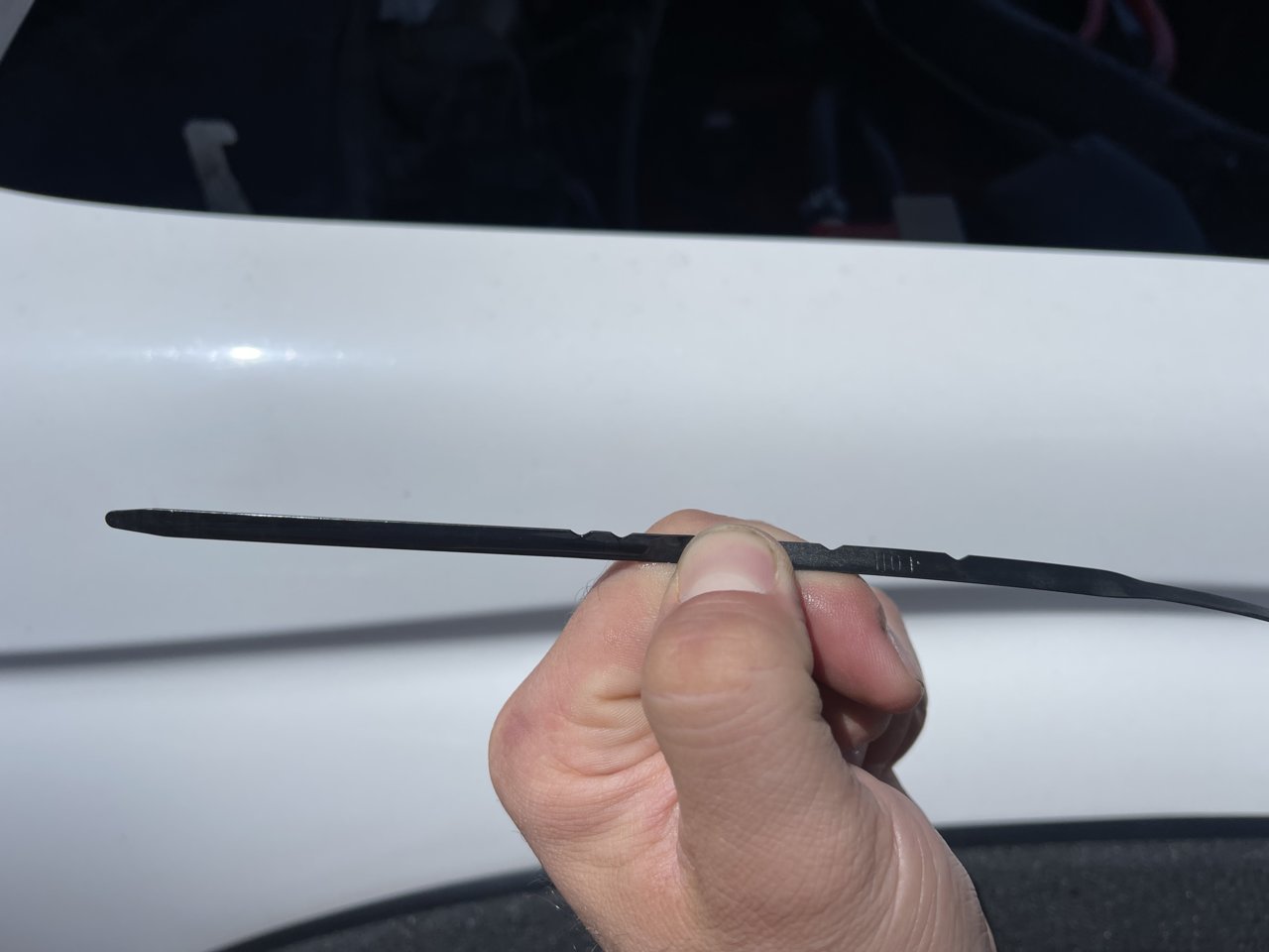

    Ok so this is my cold reading, right where my thumb is. Kinda weird. And I checked it 3 times.

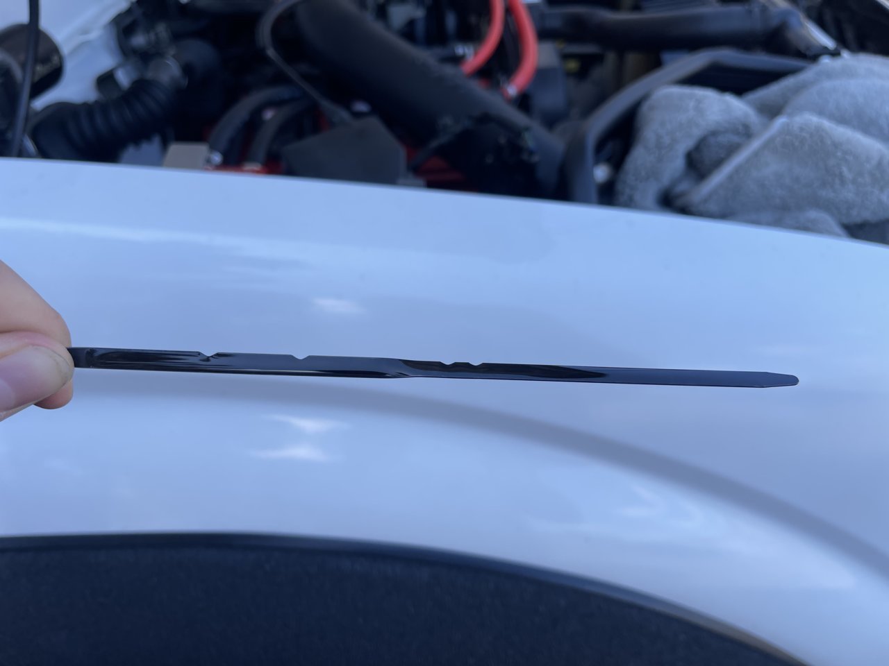

    This is the hot reading. And guess what! It drove around the parking lot just fine. Zero issues. But I’m still getting a weird hot reading. Again, it goes up to my thumb. Maybe I need to get it a little hotter?

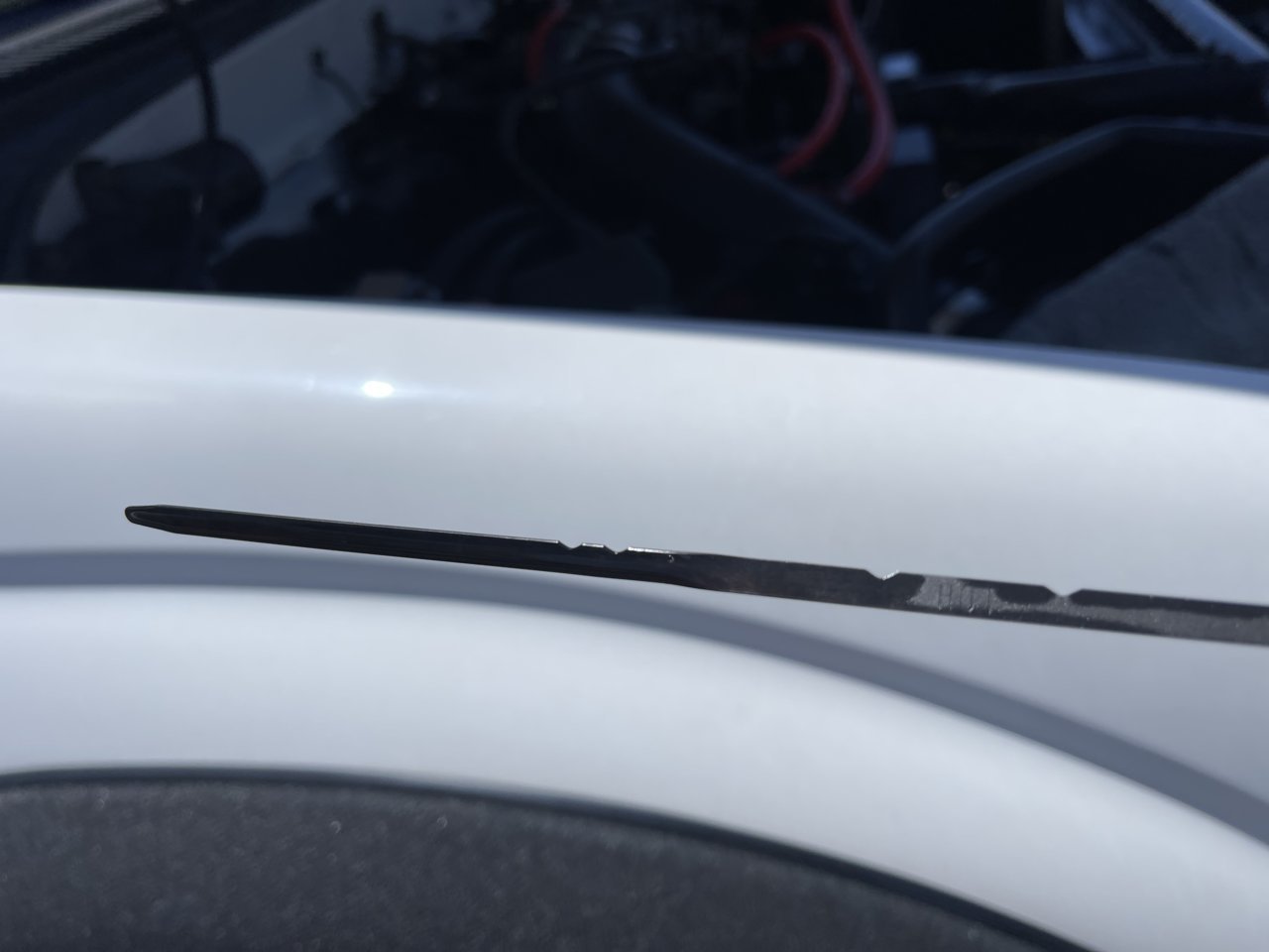

    Drove around a bit more and we now have a better reading. Even took it on the road and driving fine so far. I’m just stumped on what could’ve been going on.

    I'll revise what I listed (fluid check). I grabbed it from one of my other posts and just pasted. Your cold level with engine not running is fine. When you have it running, its going to drop since the system is running.
    If it were me, I'd add just a little more so the level is reading in the middle of both hot marks. Fluid level is good though.
    Not sure why it was giving you an issue the other day. Did you check your throttle cable (aka kickdown cable) yet? How's that look?

    Ya I checked it and the nuts were still on their tight. And it’s never given me a problem before. I didn’t measure them to see if they were in that 1mm spec but I will. Took it on the freeway, ran some errands, now just drove it to the gym. So far so good. I am perplexed
