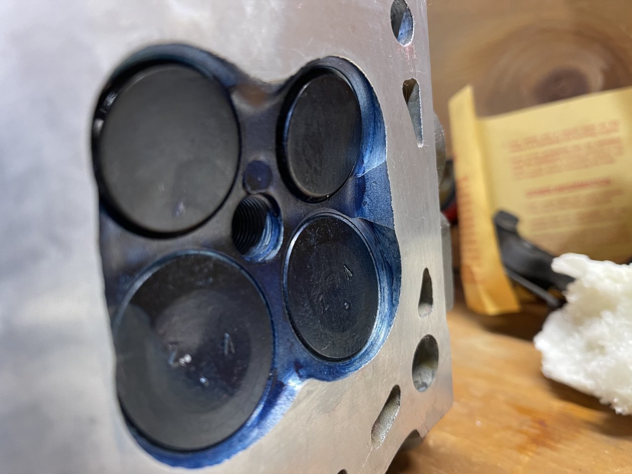

    Side question. I see two of the valves look slightly open as compared to all the rest look sealed flat. Is this ok or am I worrying over nothing. These are the new heads.
