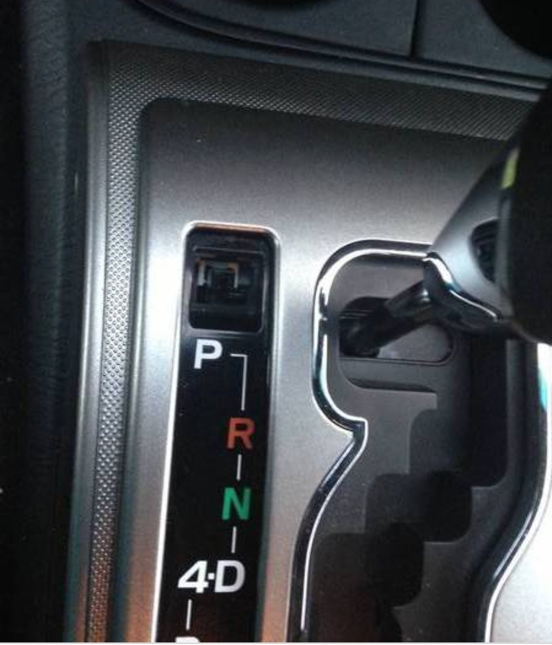

    You can pop the little tab out next to the shifter and push down the neutral park release so you can shift it from park.
    Thatbassguy likes this.

    Tried that and it did not work.

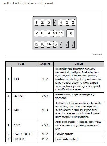

    check the fuse panel under the dash check fuse number 4 that's the shift lock fuse. I think that could be it, I had something similar in my 3rd gen after disconnecting the battery to do some electrical work some how that fuse popped and I couldn't shift out of park either.

    Will tell him to check to fuse tomorrow. Thanks.

    Not the fuse, the shifter can be moved sideways only, he says it's the box on the tranny where the cable goes in.
