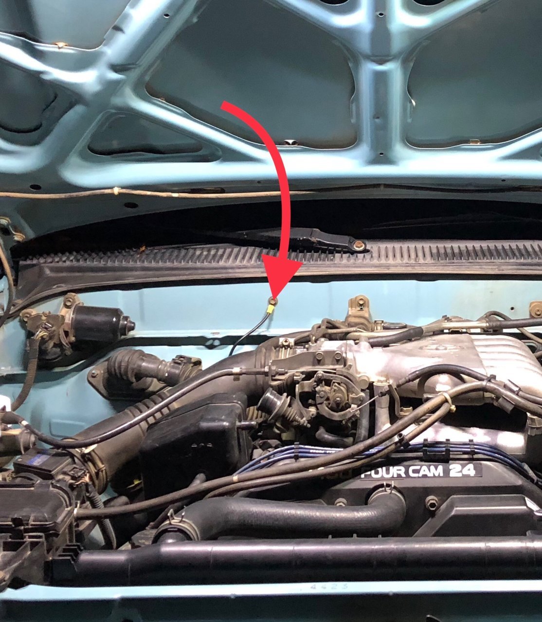

    hey I had a similar problem at one point, I thought it was my battery, my starter, my ignition cylinder, everything under the sun.
    Turned out to be this damn ground wire,
    Just a thought to check all your grounds, if they are in bad shape they can mess with your electronics in weird ways. I also replaced my positive terminal connection with OEM factory terminal connection, its much thinner and not thick lead (this was BEFORE replacing the ground wire, didn't fix the problem but its nice). Just a thought, maybe save you some headache that I went through if this is your problem as well. sounds very similar. A little gremlin of a problem, it was down by the engine that the wire was bad, oil and dirt and s__t had corroded the wire.
