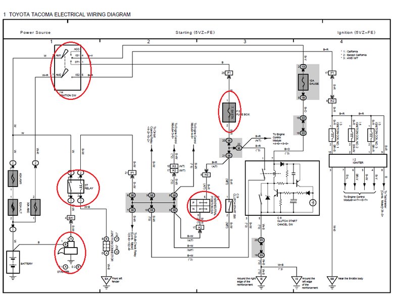

    My front left running light wasn't working. So I took the light out and the two wires that go in the socket were broke (me not thinking I didn't turn the lights off) when I grabbed it the wires touched and blew the fuse. No big deal I fixed the wires and changed the fuse. The lights were working. Get in my truck to crank it turn the key on everything electrical inside and out works. When I turn the key over all I can here is the relay click one time. It doesn't even try to turnover. The starter solenoid isn't clicking or anything. Prior to this morning I haven't had any problems with anything. I didn't have much time to mess with it but what I did check was battery connections. All the fuses in both fuse boxes. Tried jumping it off another truck. Checked the wires running to the fuse box. The only thing in the fuse box I'm not sure about are the relays idk how to check the them. I'm new to this forum so if this is in the wrong spot just let me know. I have searched and searched for answers this morning any advice will be greatly appreciated.

    There's only a few things in the start circuit.

    Ok guess my next question is how would the parking light circuit have any affect on the equipment circled in red in the picture ol above. Battery is about 8 montgs old I guess

    Ok I wasn't as lucky as I thought. It happened again at the same damn Walmart. I did find out that I can jump the starter and it will crank. So does this mean I have a solenoid problem or maybe the neutral safety switch?

    As it sits right now not jumping anything just turning the key to start it like normal. I turn the key to the on position everything inside and out comes on like it should the lights, radio, heater blower, etc. but once I turn it over to crank position it does nothing. You can here the relay in the fuse box click but that's it no starter clicking no cranking over nothing. Now if you turn the key to on position and get underneath and jump the starter it cranks over and starts. Now the part that has me stumped is it doesn't do it all that. In fact it's only happened twice and both times it was on my way to work so that's an issue. I think the part in my original post about my running light blowing a fuse when the wires touched together was a coincidence I don't think it had anything to do with my issue I have now.

    tap on the starter with a hammer while holding it in the start position. If it starts then your solenoid is getting weak. New starter.

    Sounds like the plunger in the starter is bad. Pretty common and easy to fix.

    Put the shift lever in N position & wiggle it while trying to crank it over, I have to do that in real cold weather sometimes.

    No it shouldn't take much wiggling. If the relay outside i mentioned is clicking. The park/neutral switch is ok.
