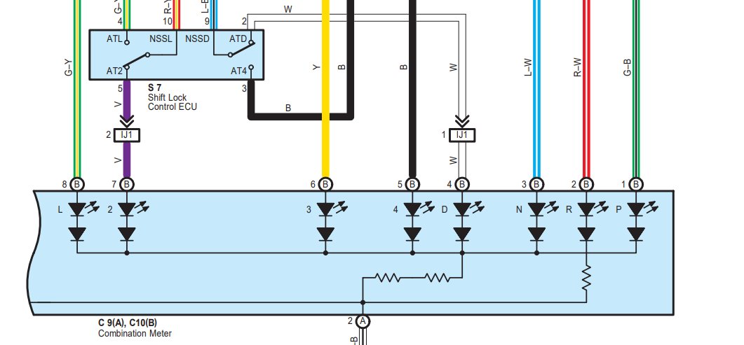

    If the brake lights lights work I think the next step is to dig into the console down by the shifter and see if release mechanism is getting a command.
    One of these guys should have a schematic
    @Dm93
    @6 gearT444E

    Ditto above.
    Drawing: NOTE: The White Wire with Black Stripe that goes off screen is the ground wire.

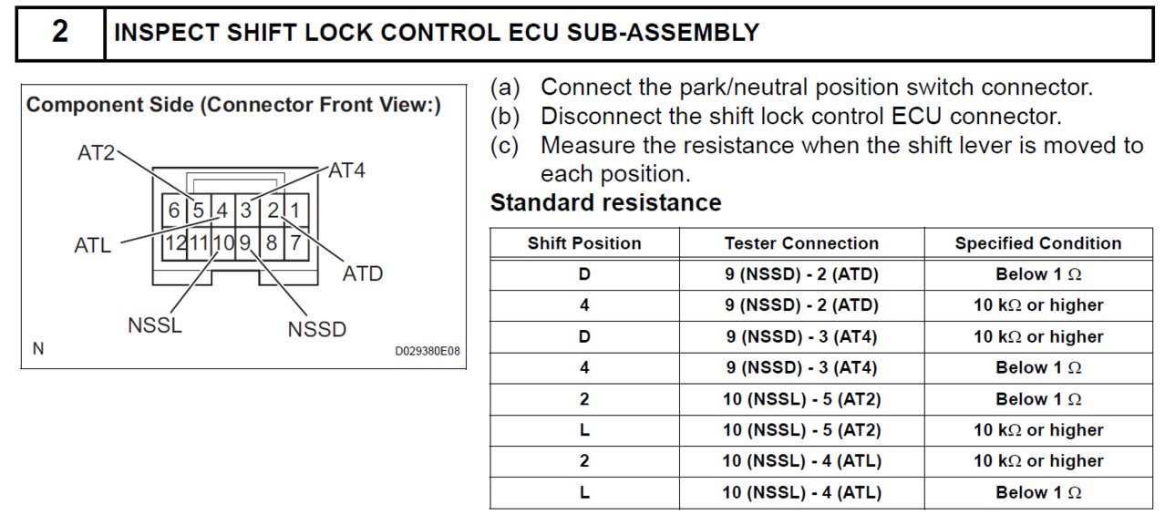

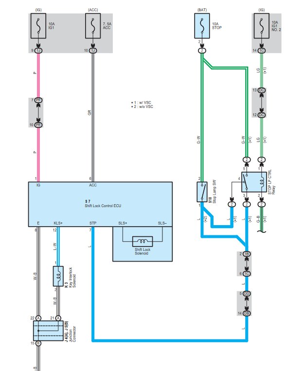

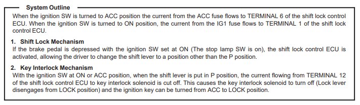

    Here's some additional info for your TS&R

    The shift lock ECU also interfaces with the transmission Park/Neutral switch, be sure to also check it is receiving the proper signals from there.

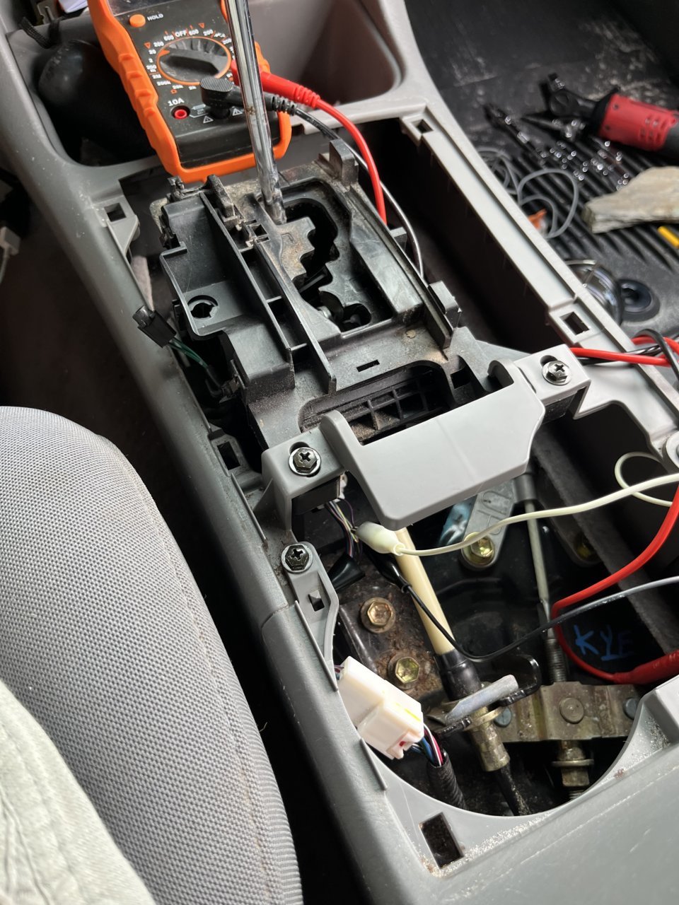

    Pin 1-8 I get nothing with key to acc
    Pin 8-9 nothing when pressing brake in any key position
    4-8 nothing in any key position
    6-8 12.24 V
    5-8 nothin in off or on

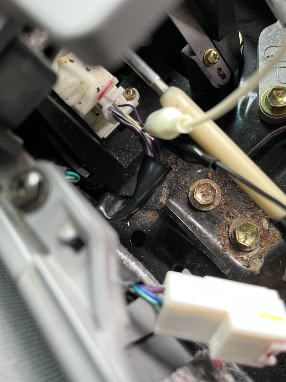

    here’s the harness I am testing from.

    Do you have power on pin 1 (Pink) with the key on?
    I just looked more closely at the testing chart and they have the terminal numbers wrong, the designations are correct though.

    Here’s the shift assy removed.

    Ok, here's the proper designations according to the wiring diagram.
    Pin 1 (Pink) Ignition power (12v with key in run)
    Pin 6 (Grey) Accessory Power (12v with key in accessory or run)
    Pin 7 (Blue) Brake switch input (12v with brake depressed)
    Pin 8 (White/Black) Ground (0v at all times)
