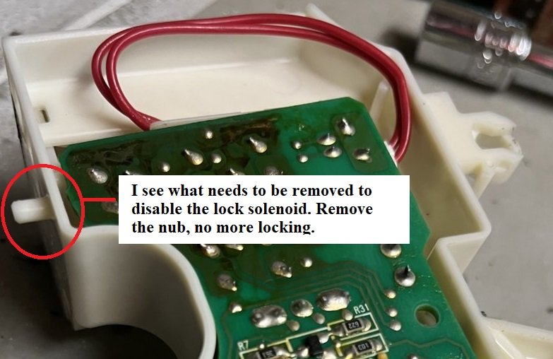

    Looks like it’s coming apart one way or another. I can’t tell OP what to do, but I know a guy that would pull it apart and see if I could “delete” the lock. And then don’t touch the shifter while the truck is moving.

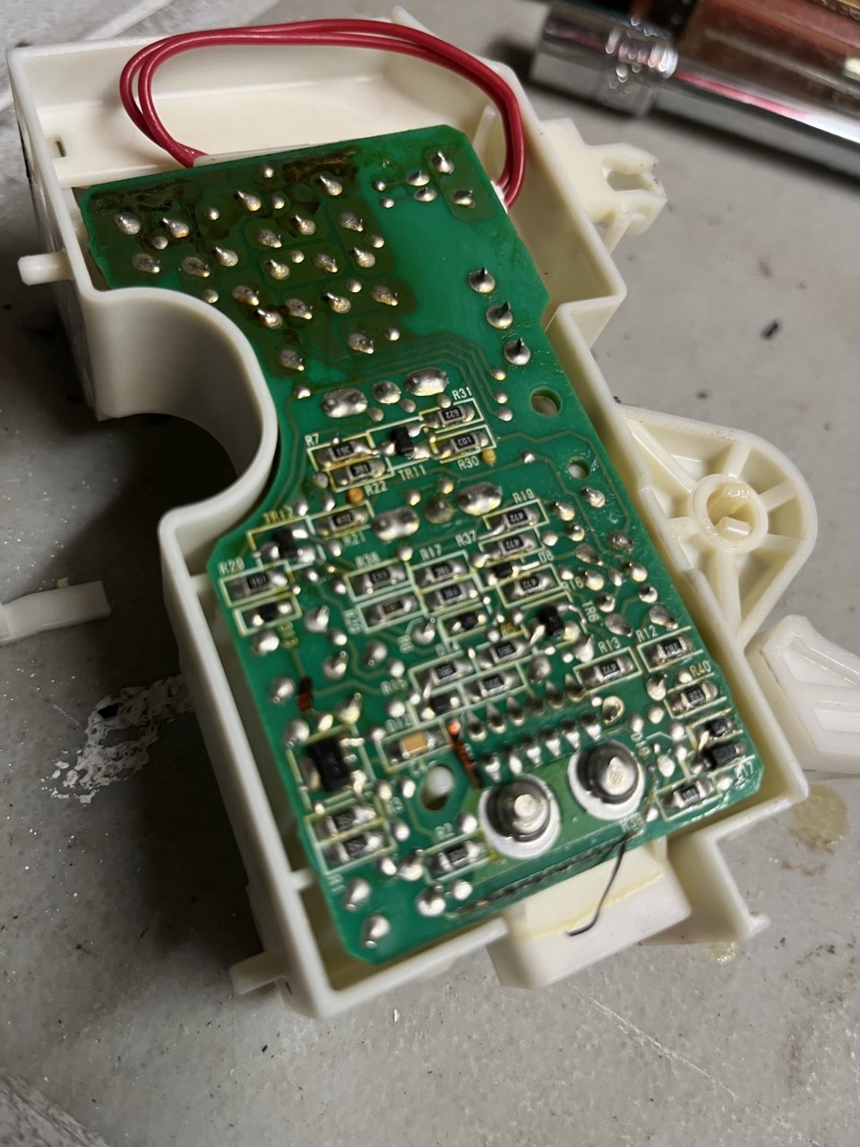

    here’s the shift lock ecu, if you look at the board by the connector there’s a solder line that’s disconnected. Don’t know if that’s what’s causing the issue but prolly not good. This ecu is $400, may try to solder this and try again.

    Yea looks like it got something spilled on it, looks like a circuit trace has corroded away. You can try soldering a small jumper wire in place of it, can't hurt anything if the module is junk anyway.
    You may be able to get the whole shifter assembly with the module from a salvage yard much cheaper than a new module.

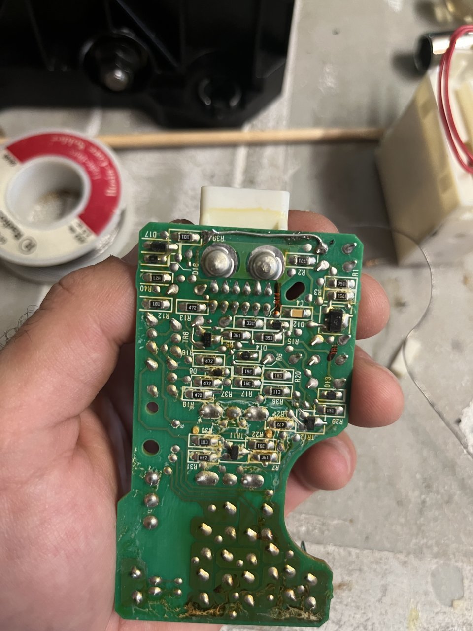

    *FIXED*
    I soldered a new wire onto the board to fix the connection and it worked! Really appreciate all the info provided, it guided me to the fix. Also saved some $$.

    Dm93 - thanks, i tried working with the needle leads and in that tight of a space was driving me nuts lol. Taped each wire up so they don't short. Also cleaned that board real good before re installing.
