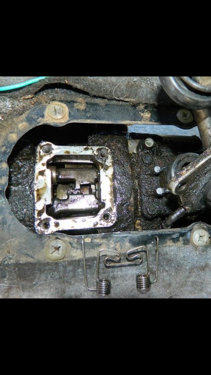

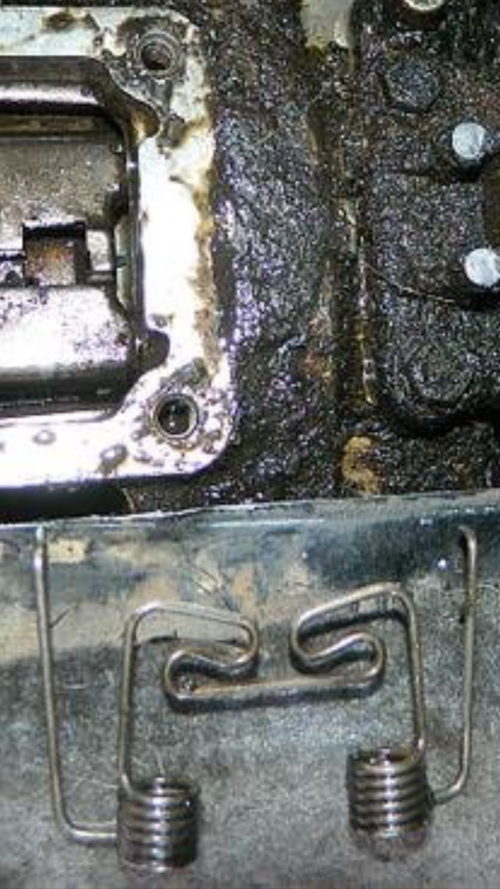

    This is where you can take your shift lever out. I don't know if it's the exact same on automatic tacomas but I would think.
    There are 4 bolts (10 or 12mm) holding it down. There is a gasket between there and the square spring in the second photo.
    Check and see if it's in the proper place. It's supposed to be holding onto the bottom side of the lever. I believe this is a "return spring"

    Subbed. I just ordered a new oil slinger gasket for the 4WD shift base since mine is seeping a bit... though nowhere near as messy as in the photo. Nice to see what kind of trouble I'll be getting into when I open it up.

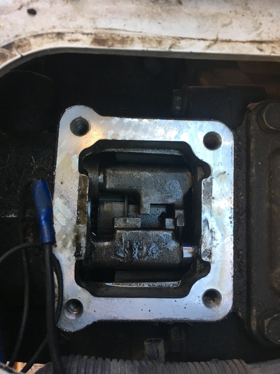

    Changed the oil and that didn't fix it so I just dug into the linkage.
    It looks like this:
    Any suggestions on how to get to back to how it should look? Am I hosed? Thanks.

    Use a large flat screwdriver to see if you can get it back into the neutral position . Looks like the detents are messed up .
    Go to my transfer case page and identify your transfer case . From there you can find an exploded view of your transfer case . Locate the detent balls and springs , remove the detents , then place the shifter back where it belongs . Then put the detent balls and springs back . I am willing to bet you have more issues within the transfer case
    tacopashka and Dalandser like this.

    Do I need to drop the transfer case to do this...?

    Not just yet .
    Try prying the linkage back into the neutral position first .
