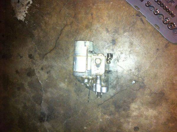

    Just replaced my starter Saturday night. Same symptoms.

    I did my starter on Saturday afternoon!!! Same exact truck, year and everything! Just ended up replacing the contacts and started up right away.
