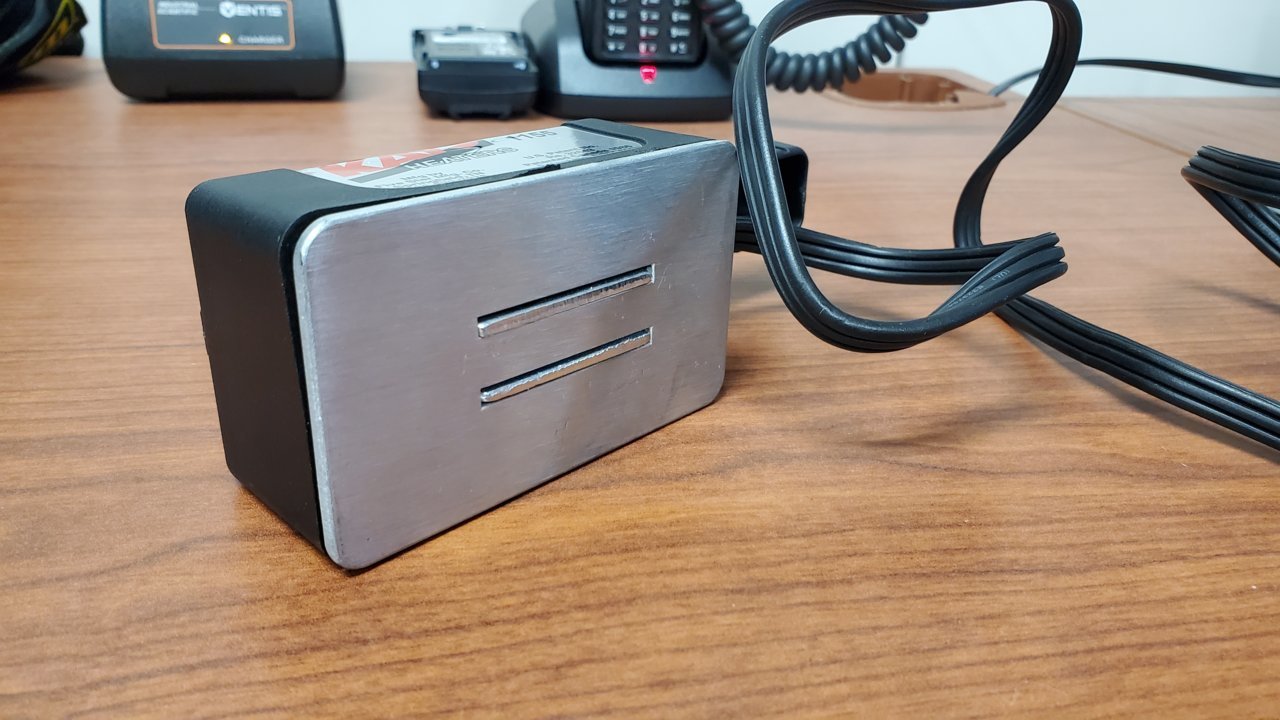

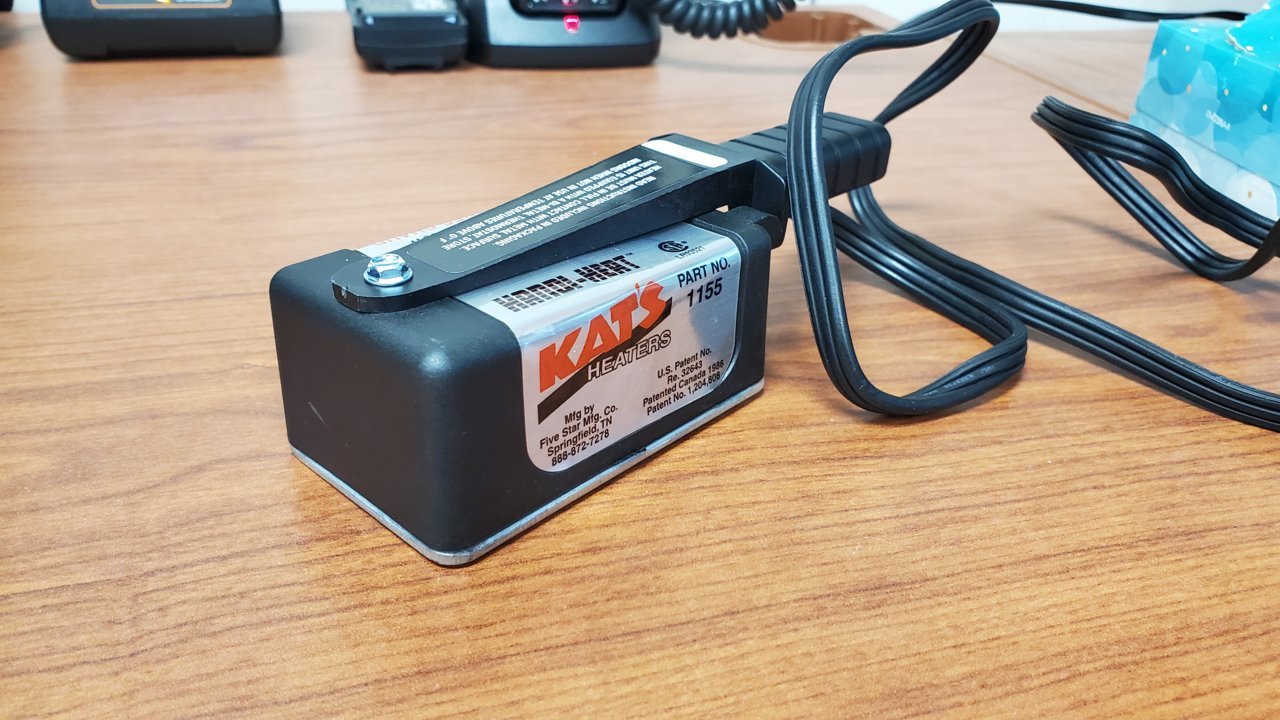

    My coworker finally got his car running this morning and went to town. He acquired two magnetic oil pan heaters for tonight.
    Unfortunately they look like something you'd use on a lawn mower. I did my best to stick them on, but of course the Tacoma has an oil pan that looks like it came off a 1.0 litre 4 cylinder car and is mostly round. The flat ish part on the back I was eyeing has the cross member right next to it and there isn't room. I couldn't see this before because my skid plate curls around the cross member blocking it from view. The only place it would fit it's hardly touching the oil pan at all. The second one I stuck on the exhaust manifold. I wanted to just lay it flat on the engine somewhere but the frozen extension cords are like coil springs and just pull it till it falls off so the magnetic exhaust manifold is the next best thing that it can stick to and still get some heat into the block. I'll try it after 6 hours and see what happens. Otherwise I'll have to drag the truck to a building somewhere overnight.
