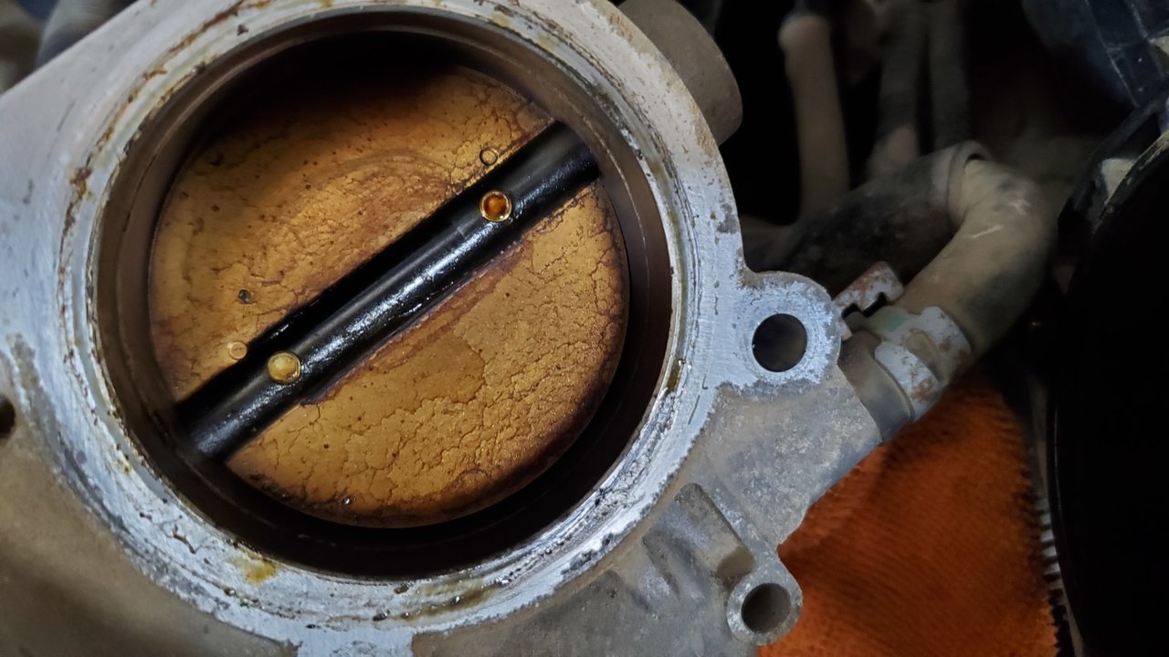

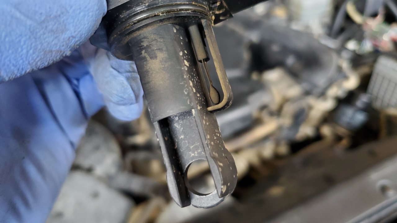

    Holy shit that throttle body though! Plugs really weren't too bad, the MAF was definitely gross, but i feel as if that would be more of a running issue than a starting issue. You say you offroad. My starters contacts are gunked up packed up from mudding. If i go through lots of mud the starter will click. After a few clicks it starts fine and drys out and its fine but a little bit slower. This is my first winter after it started doing that, winter mornings is definitely a way harder start. You can rebuild these starters for like 12$ its not too hard if you are handy.

    That poor girl was crying...

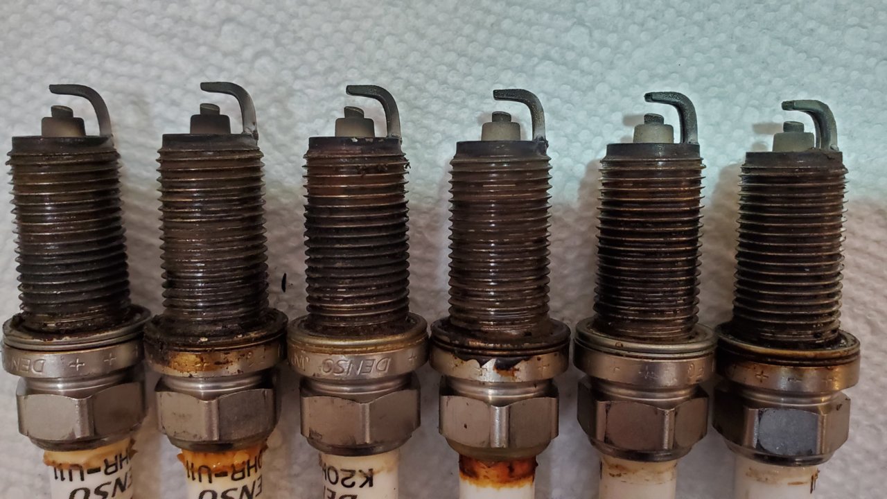

    I had some OLD, neglected plugs in my old Corolla that were giving me some trouble once. I just loosened each one a quarter turn, hosed a bunch of WD-40 down into the holes, and went back into the house to eat lunch. They all came out pretty decent after that.

    I'm sure there wouldn't be much of a perceptible difference in it running once it got running, but if those gaps got much bigger it would have. If nothing else, your changes probably increased your power and MPG a bit. But I have to imagine that stronger spark will do nothing but help when the fuel is very cold like that. Try and stick to the maintenance intervals or get iridium plugs.

    Can't tell from the pictures, are the old plugs 3 denso and 3 ngk? If yes, then that means they're most likely original, converts to 201000 miles on the original plugs so, they don't look that bad considering how long they've been in there.

    They aren't original I changed them 113,000km ago. It's not a hard job at all except for some reason my socket would lock on after I tightened some of them, and I had to loosen the spark plug, pull the socket out, and use a different socket to torque it.
