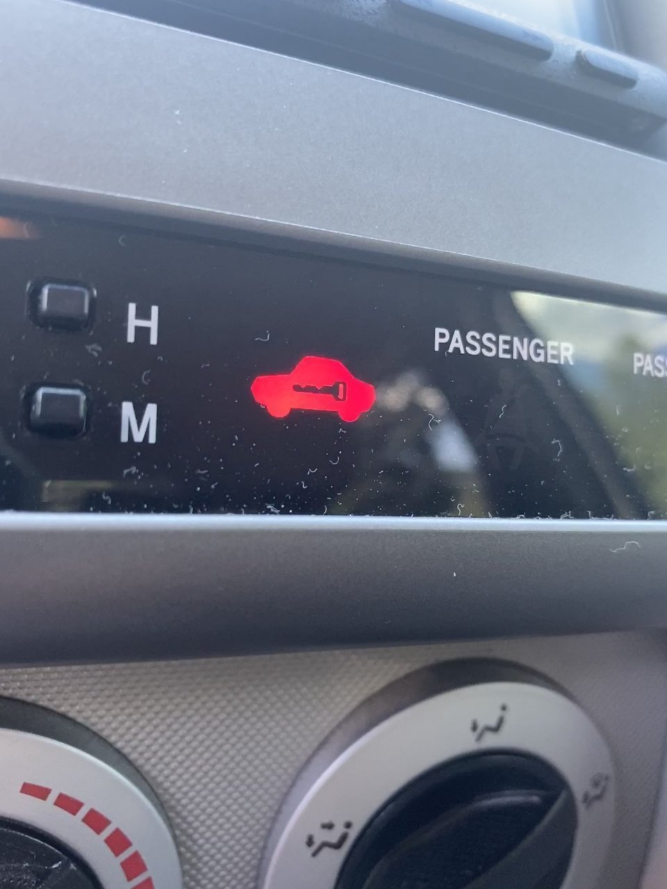

  9. Jan 22, 2022 at 8:30 AM
    oakcity
    oakcity [OP] Well-Known Member
    Jan 26, 2020
    #317343
    478
    Jesse
    Raleigh, North Carolina
    2009 Grey Tacoma AC 4x4
    Money Pit
  10. Jan 22, 2022 at 8:32 AM
    Dm93
    Dm93 Test Don't Guess
    Mar 3, 2015
    #150066
    13,020
    Texas
    2014 DC OR 6spd 4x4
    Predator tube steps, Ranch Hand grill guard, Magnaflow CatBack exhaust, Toyota tool box & bed mat, 2LO Module by @Up2NoGood, Rearview Compass/Temp Mirror, Tune by @JustDSM.
    i meant with the key on and/or cranking.
  11. Jan 22, 2022 at 8:33 AM
    oakcity
    Jan 26, 2020
    #317343
    478
    Jesse
    Money Pit
    Nope
