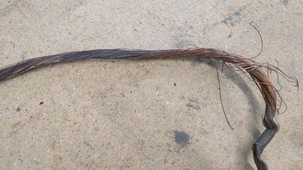

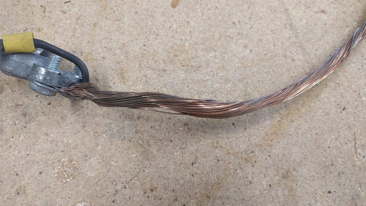

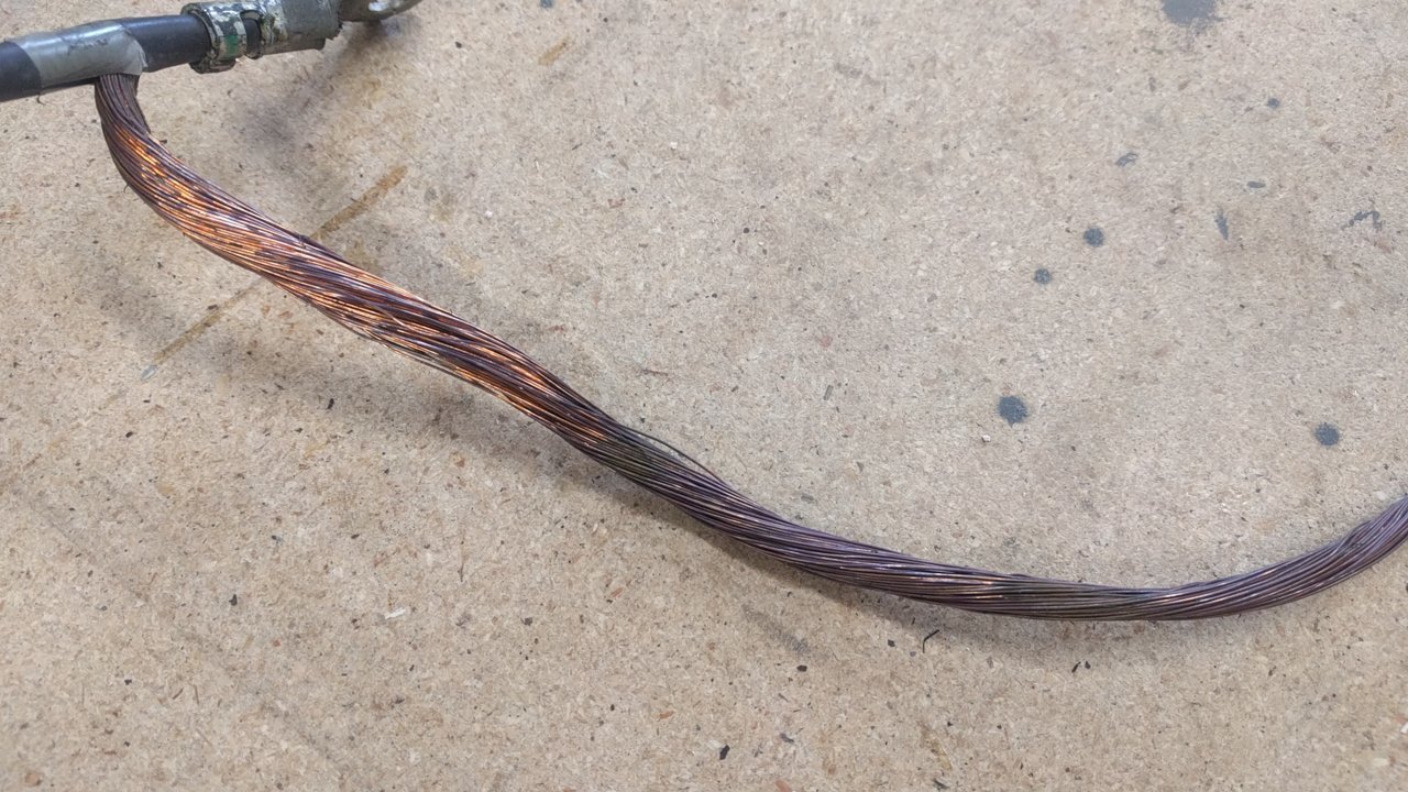

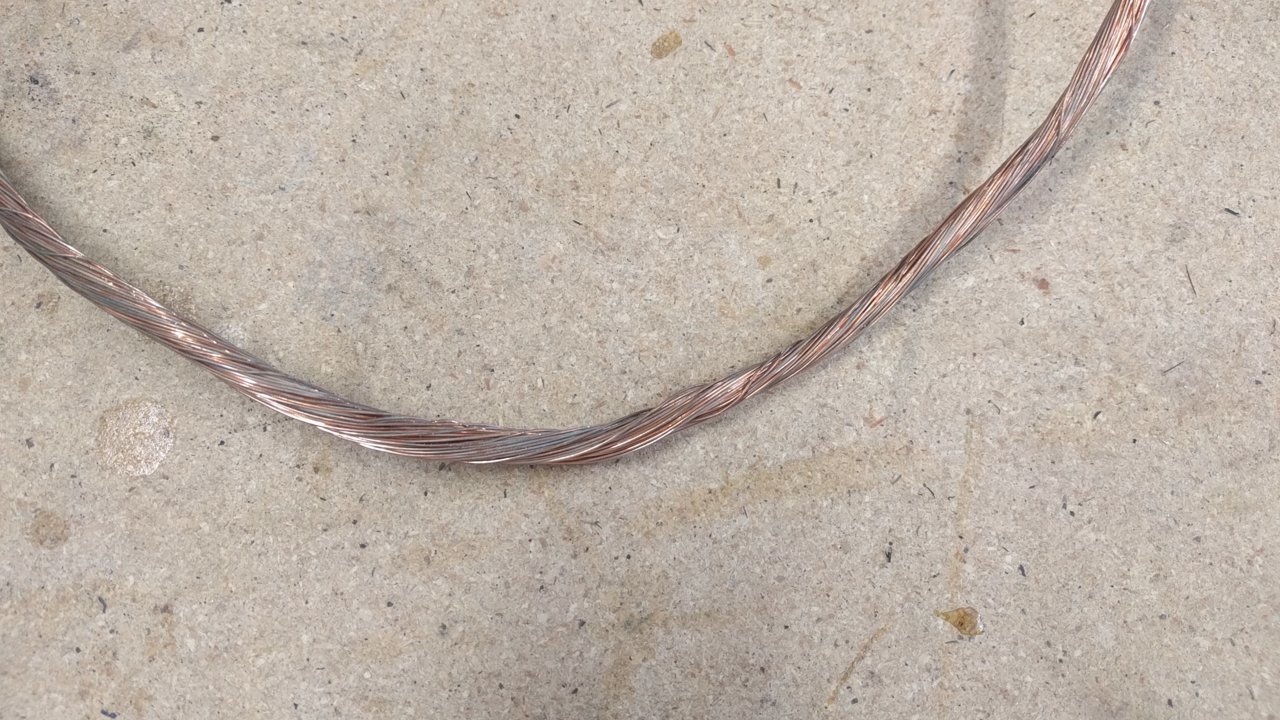

    HuckleSmothered
    HuckleSmothered [OP] Active Member
    Nov 9, 2011
    #66740
    43
    95 Tacoma Ext Cab
    Yes, everything looks good where the ground wire connected to the block. Quite clean.
    Here are the cables that I just cut the insulation off from. The insulation itself was in great condition.
    Two pictures of the negative cable:
    And two of the positive cable:
    The positive definitely looked much more discolored. Some green patina was even in there.
    Would this level of corrosion cause problems?
    The first time it occurred was about 3 weeks ago. Which was about 2 or so weeks after the latest repairs. Related? The problem that was fixed during the last repair hasn't happened again. While there have been several "starting" issues, each one has been different from what I can tell.

    2-week update. Everything has been fine. No failures like before. It appears the cables were the issue.
    I'm curious how this happened? The worst discolorization was on the positive cable near the center. But the insulation looked perfect. Is there something I could have done to prevent this? Or can do to prevent it from occurring on this new set of wires?

    New wires should last years to come - spritz the battery terminals with WD40.

    Those terminals you have cause more problems They are made for a emergency get me home not for long term use.
    Check out the Marine type terminals
    Quite possible the code was tripped by losing a ground on the O2 sensor circuit no real way to prove either way.
    It is gone and that is always good.
