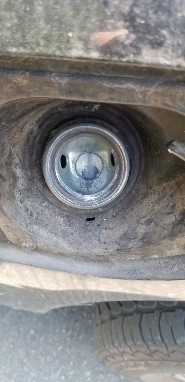

    Check the fill site... do you still have this metal flap?
    I had a mazda tribute that had the spring break and the metal flap fell down the filler neck and was sitting on the anti siphon screen. I could only fill about a 1/2 gallon at a time, major pain in the ass when filling up 20200731_123825.jpg

    This pic is not of Tacoma rollover valve. DKW @Abeyancer posted it.
    Tacoma rollover valve is at bottom of fill above gas tank20200731_123825.jpg

    I only posted it cause I was shooting in the dark based off past life experiences. Missing that little metal flap was the cause of my issue in my old mazda
    I honestly had no idea we had an anti rollover valve in our fuel system
