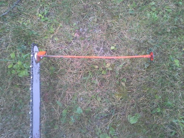

    Anyone else like me, hates to find a piece of stovewood just a little bit too long or too short for the stove? Here's my fix for that.
    5/16 rod, thread the end or weld to a neo magnet (case) to stick to the saw bar. Cut the rod to the length you want your firewood minus 1/2 inch or so. Other end has a washer welded to it. Start at one end of your log with the washer at the flush face. Do a little zip cut (just through the bark). Take a step to the left or right (magnet goes on either side of the bar), let the washer slip into the previously made zip cut and do another zip cut...and so on down the log. All your cuts will be the same length. Ready to buck the piece, just pull the measuring bar off the saw and put it in your pocket. Mine is painted flourescent orange so I can see it where I put it down...most of the time.

    I use my chain saw to know where to cut. Lay it on the wood, then cut. I know where 24" is on my chainsaw.

    I used to do the "lay the saw out" measurement, but the saws get heavier, the patience less as the years go by. And I find that the larger the diameter of what's being bucked the more likely it is to end up with a longer length cut if I don't mark it. Must be the size of length relative to the log diameter or something...or it's just me.

    Same idea as a quick stick, then. I used to use one, but I've gotten pretty good at eyeballing my cuts; they're almost never more than an inch or so different. Practice makes perfect, though; the reason I got the quick stick was because at one point my cuts were varying as much as 6-8 inches, lol!

    6-8 inches, I can relate. I had a large pile of "16" inch pieces I had to set up a sawhorse to re-cut to stove size. Lots of 4-6 inch chunks to daytime burn. Doesn't happen anymore, usually. The over-length ones all came from a 26-28" diameter white oak. Sometimes cuts through big bruiser stuff squews at the end of the cut and you end up with a few inches more than you bargained for. But it all burns.
    Now I keep a check stick out at the wood shed so if one is suspect i can check the length quickly before bringing in to the house and finding it doesn't fit the stove.
