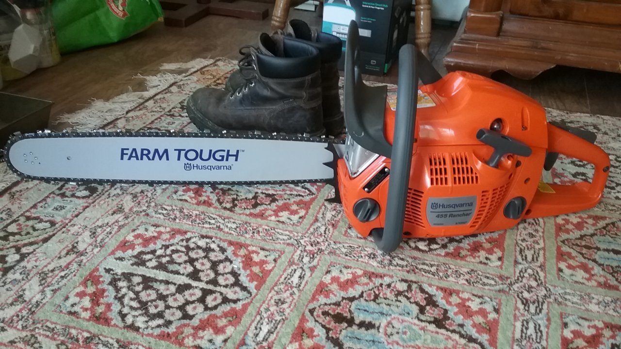

    Bought a new noisemaker yesterday. My 51 managed to vibrate the bar tension screw out somewhere on Saturday and I didn't want to wait the 'up to two weeks' for the replacement to come in. Since I'd been toying with a newer, larger saw for a while now anyway this followed me home.
    Cuts nice, too.
    I'll still use the '51 as my primary, I think, but this will be handy for the larger stuff.
