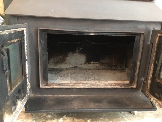

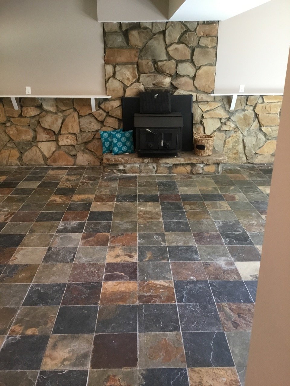

    I am not sure what it is exactly.. It's definitely pre epa. Here are 2 pics I have. There are turn dials on each of the doors for the door dampers and not pictured as it's above the visible section inside the box, but there is a piece welded in. I am not sure what that is for.... maybe to control the backdraft some? I am usually burning hickory and maple.
    EDIT: I replaced those rope gaskets... these pics are from last year and I replaced the gaskets in October.
