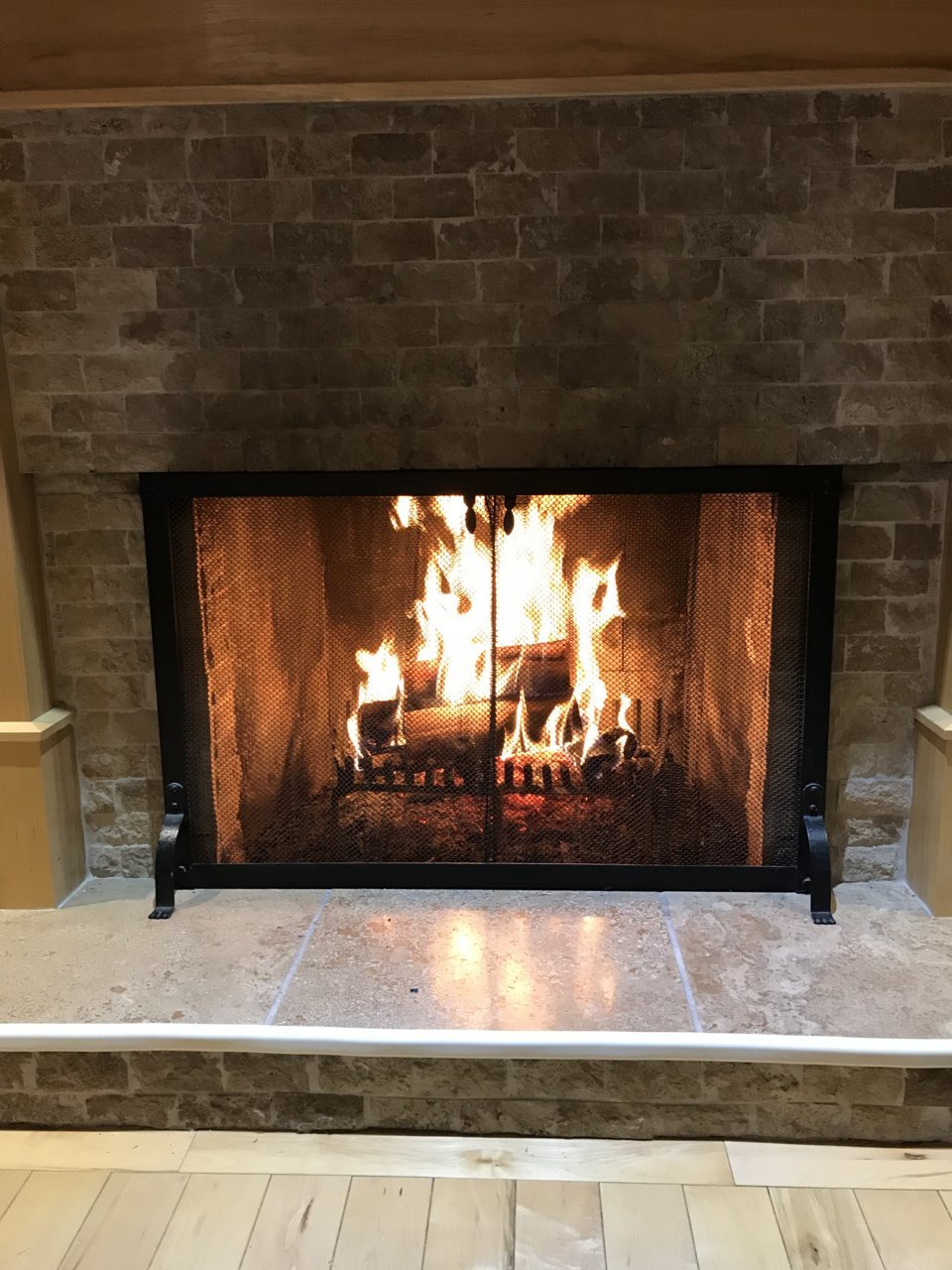

    Big storm in Calgary tonight but that’s Pine by me!0E1627B6-6662-4A5A-B0A7-C4F830DCB6EA.jpg

    :rofl::rofl::rofl:
    Good one!

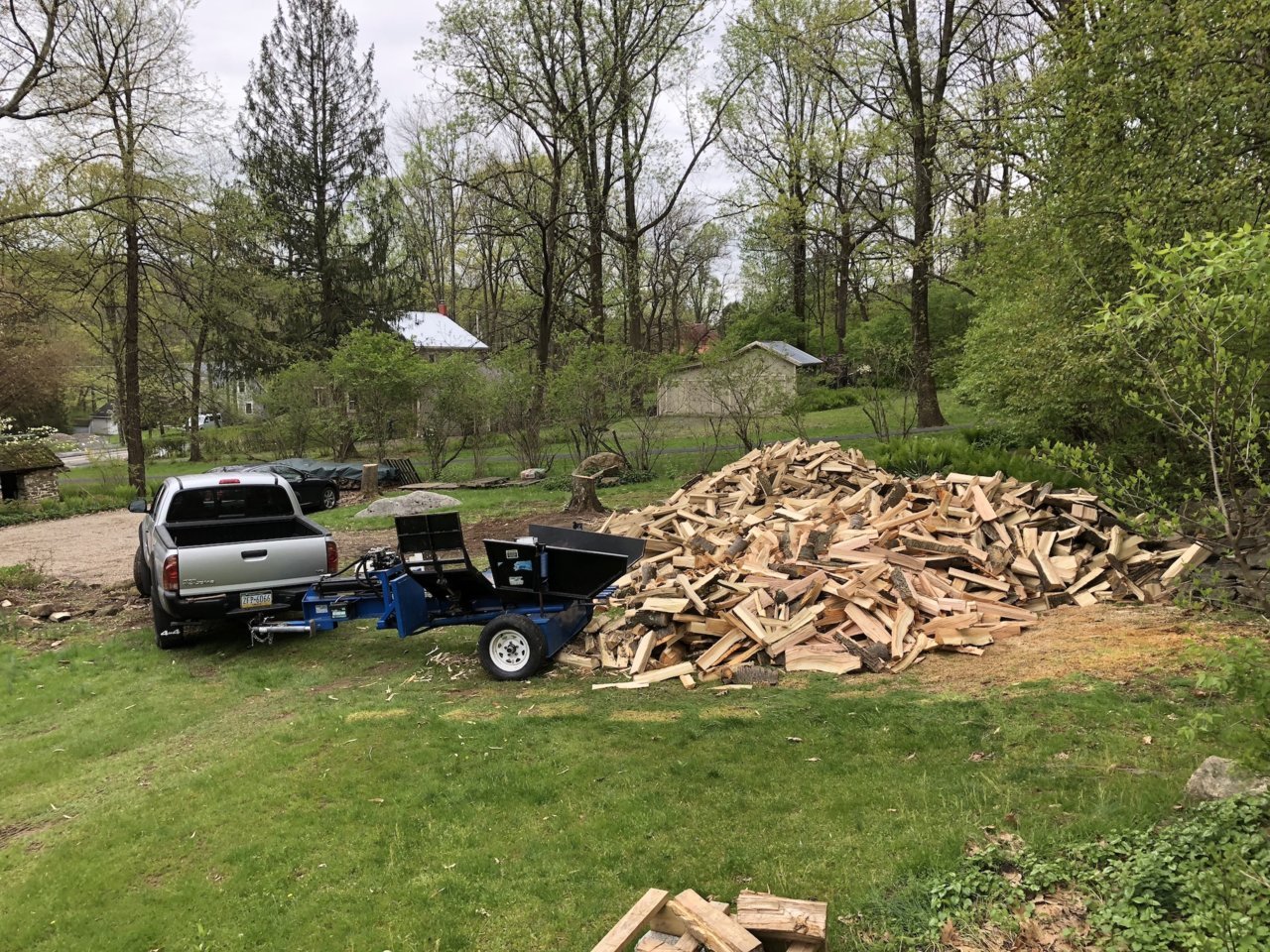

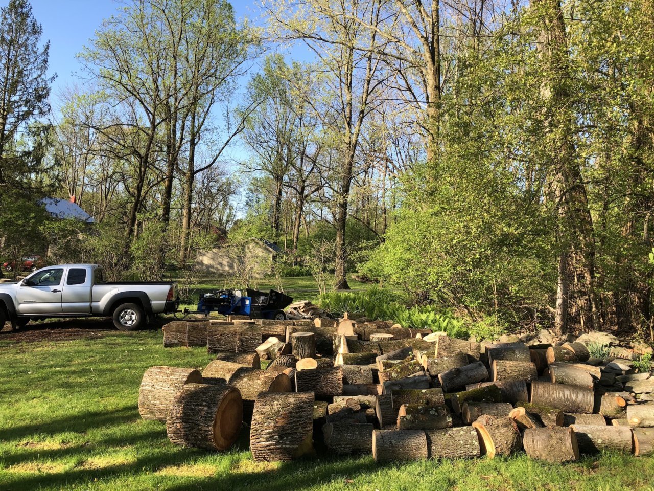

    Had some trees cut down recently. Then this happened. The tree cutters left us with logs. We sliced them up and then split them. Mostly poplar with some cherry, oak, walnut, and mystery fruit tree mixed in. The poplar was a twin trunk monster, ~100 feet tall!

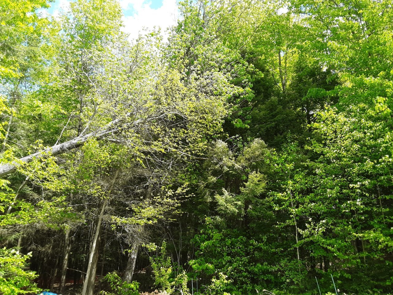

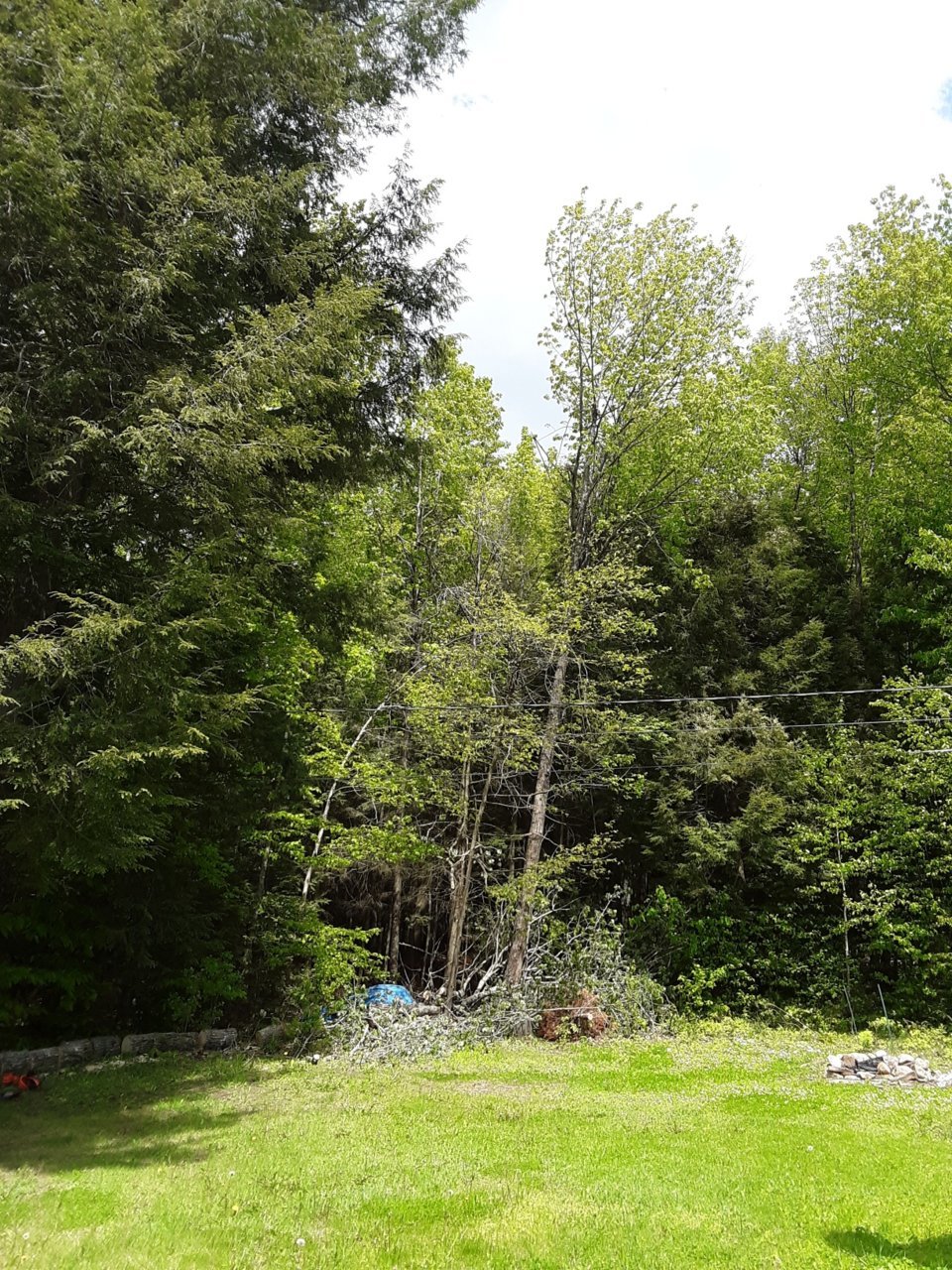

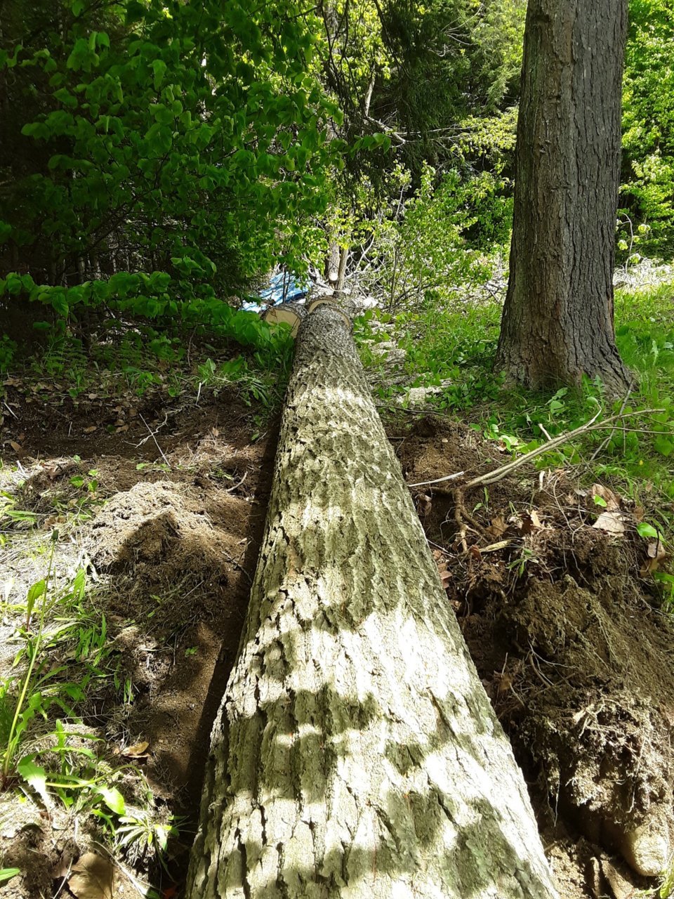

    Stopped over at a buddy's house last night to drop a leaner for him. Big Silver Maple that got blown over during a windstorm this spring. He got quoted almost $500 from a local arborist JUST to drop it, because of the proximity to the power lines that feed the house. I think that was a "go away" quote, honestly, since the tree was 30 feet and leaning roughly 30 degrees away from parallel to the lines, but whatever. :notsure:
    Took me 10 minutes to set up my rigging gear and 5 minutes to drop it, easy peasy. Maybe I'm in the wrong business, lol.

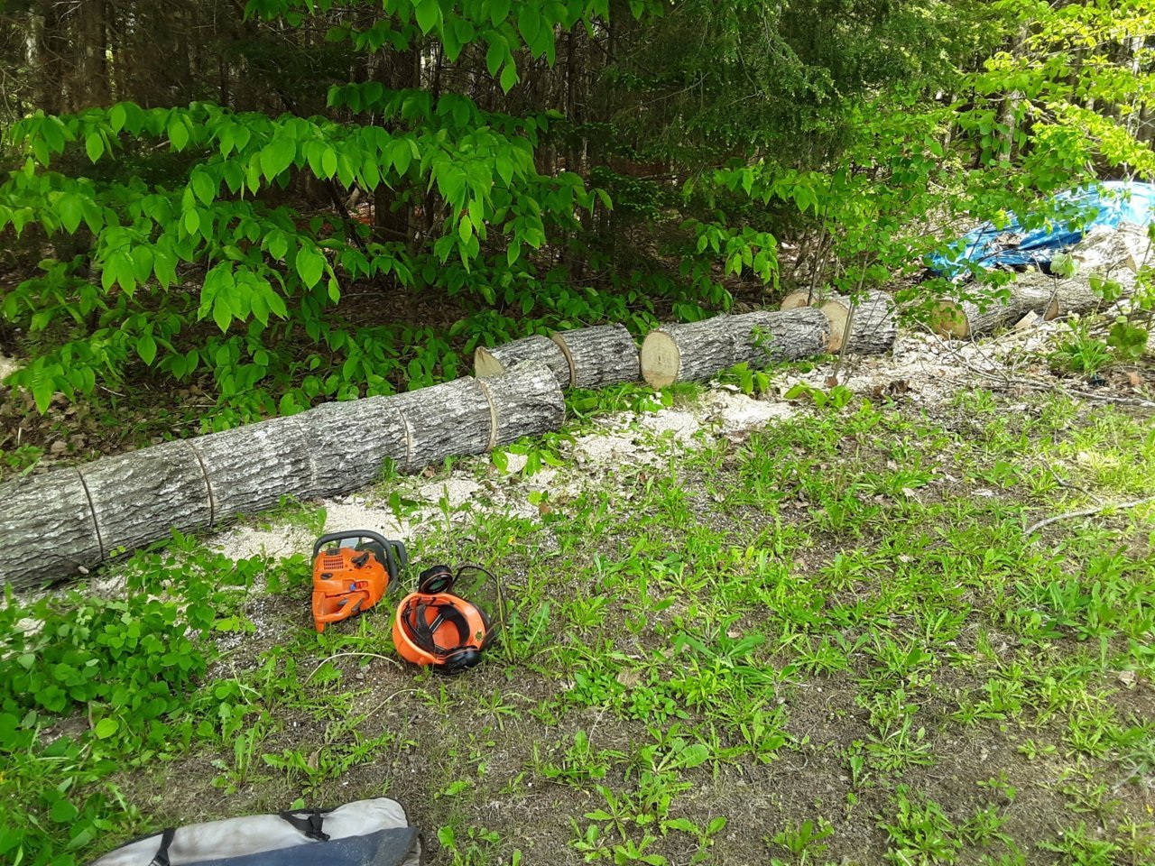

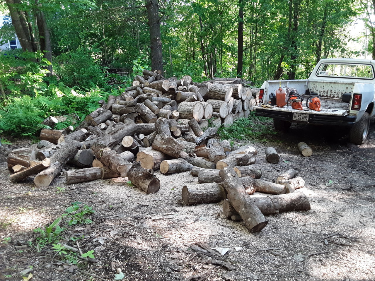

    Did a little firewood work this afternoon. These 5 footers are mostly Maple with some Cherry, and they're a lot lighter now than they were when I put them here roughly 20 months ago. :laugh:

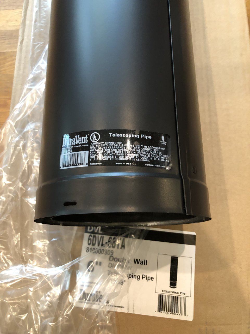

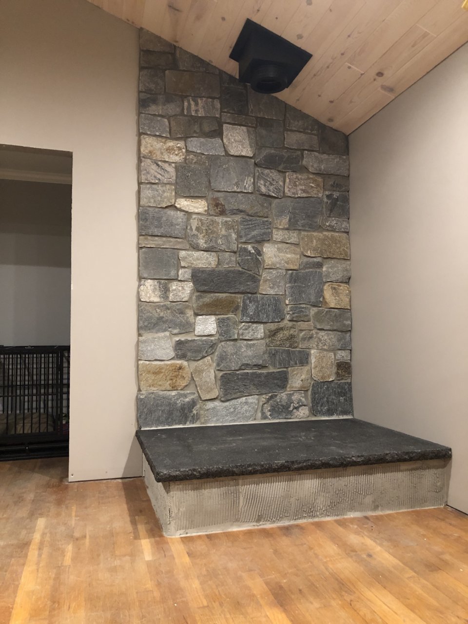

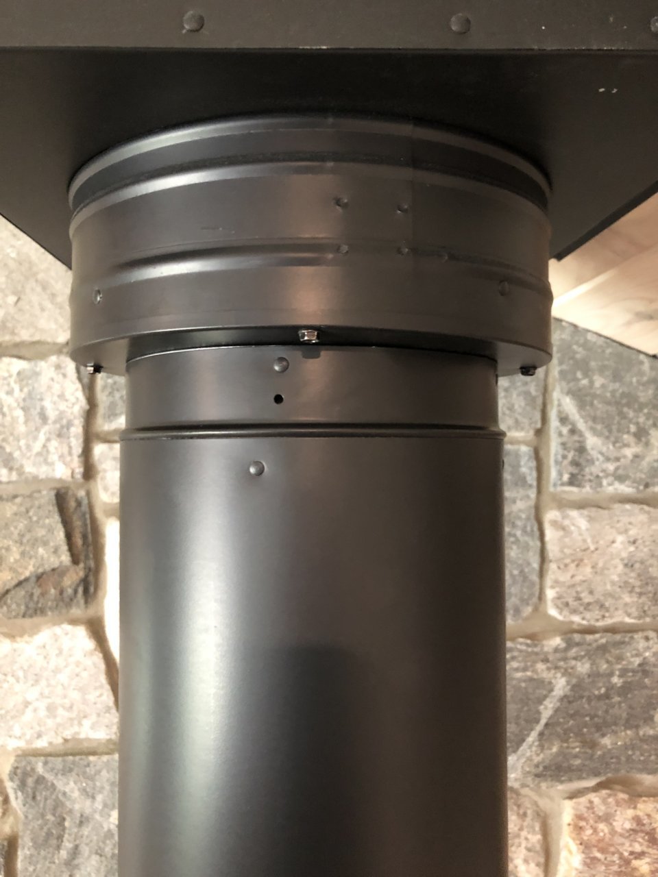

    Hey guys.
    Been working on installing a wood stove in my living room.
    Just finished the stone work.
    Today I started messing around with the stove pipe and came across something.

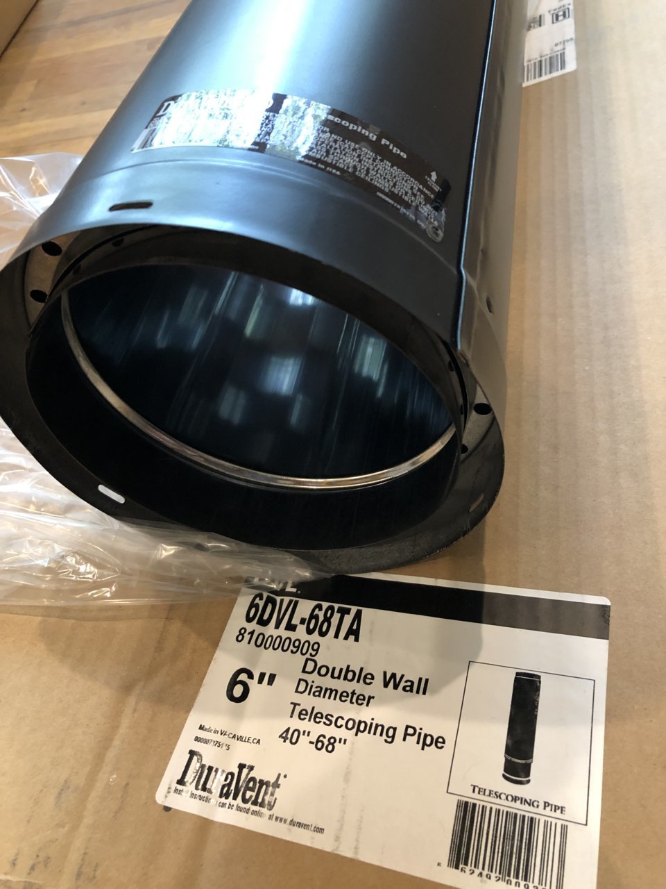

    I’m using duravent double wall stove pipe. It’s a telescopic section from the top of the stove to the ceiling box.
    I ordered it from woodland direct. I told the guy what I was doing and we pieced together everything I needed. However when I went to assemble it, they wanted me to use this-
    Which would be fine for single wall stove pipe, but when I slide my double wall pipe over it, it looks like this-
    Which didn’t look right to me, so I called them and did some research while I was on hold. They insulted me and told me I didn’t know what I was doing, and kept repeating that this can’t be installed by a home owner, that it has to be installed by a professional...
    I found this piece online, which is designed for attaching double wall stove pipe to the ceiling box-
    There are even a few videos from Northline express showing how it connects to double wall pipe. But I can’t find any videos anywhere showing double wall pipe connected to the original connector they sent me.
    So this new piece will be here Friday, and I have no doubt that this will be exactly what I needed, and those guys from woodland direct can go suck it.

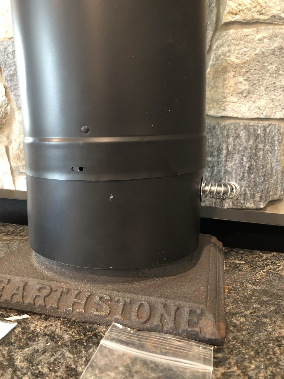

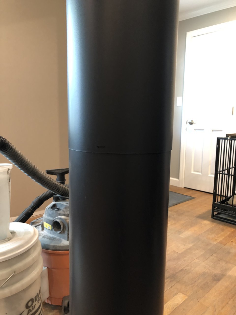

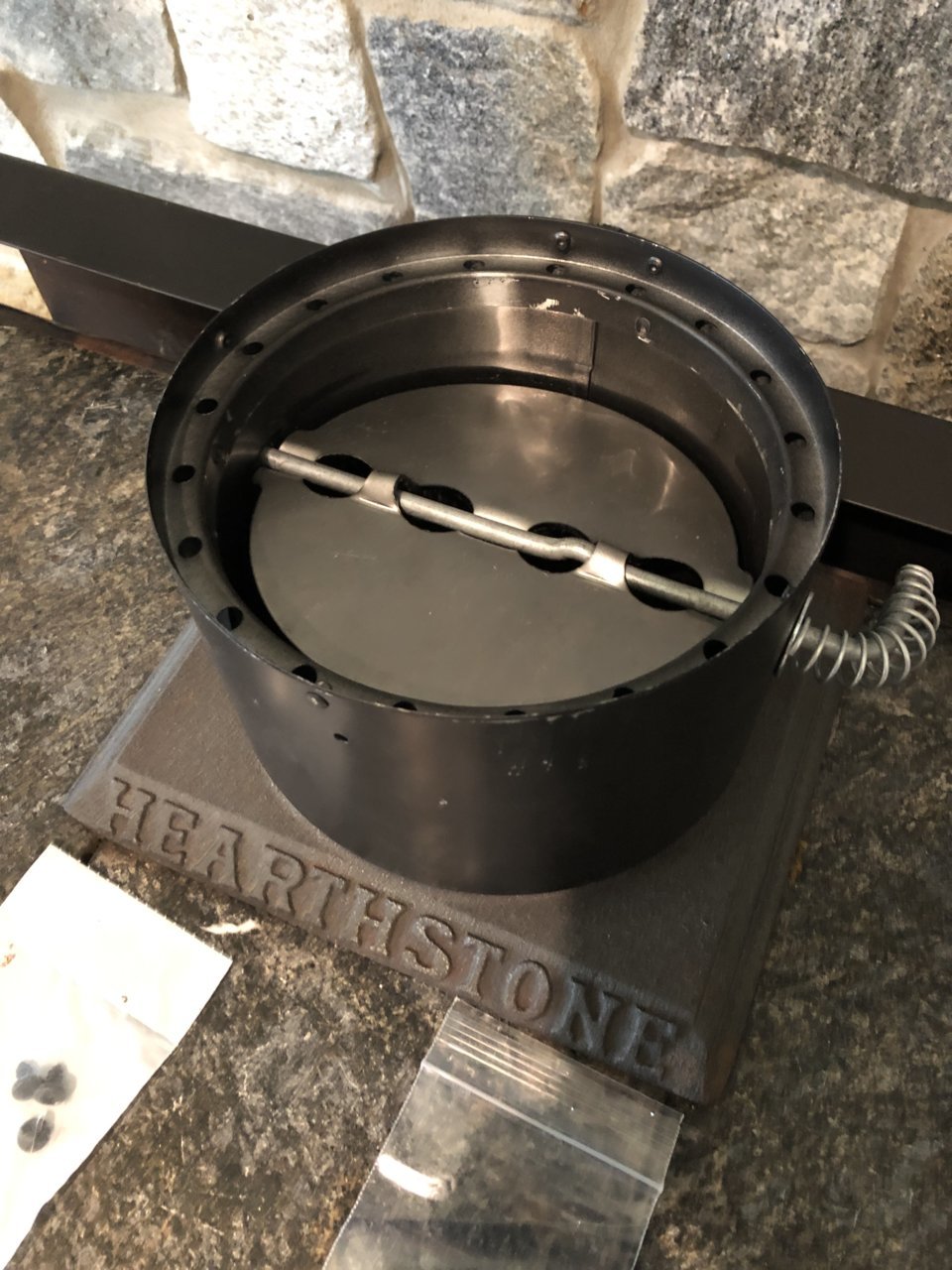

    And to give some more pictures incase anyone thinks I have the pipe upside down...
    Bottom section- I have this on top of a damper, which is attached to the stove flue
    Telescopic sections together-

    Looks really good. The new flange definitely looks like what you need. I'm sure the other one will work but it doesnt look good or right

    Thanks man!
    I wasn’t sure if the air between the 2 walls needed somewhere to go, but didn’t like how it looked anyway.
