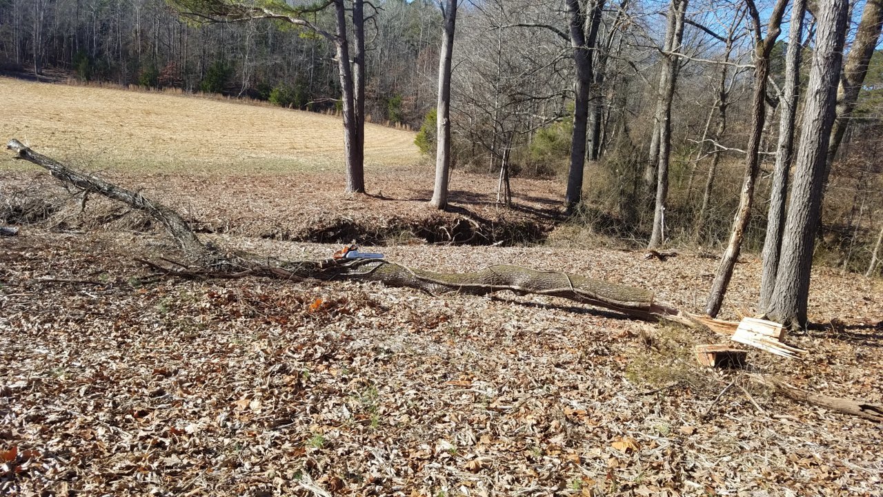

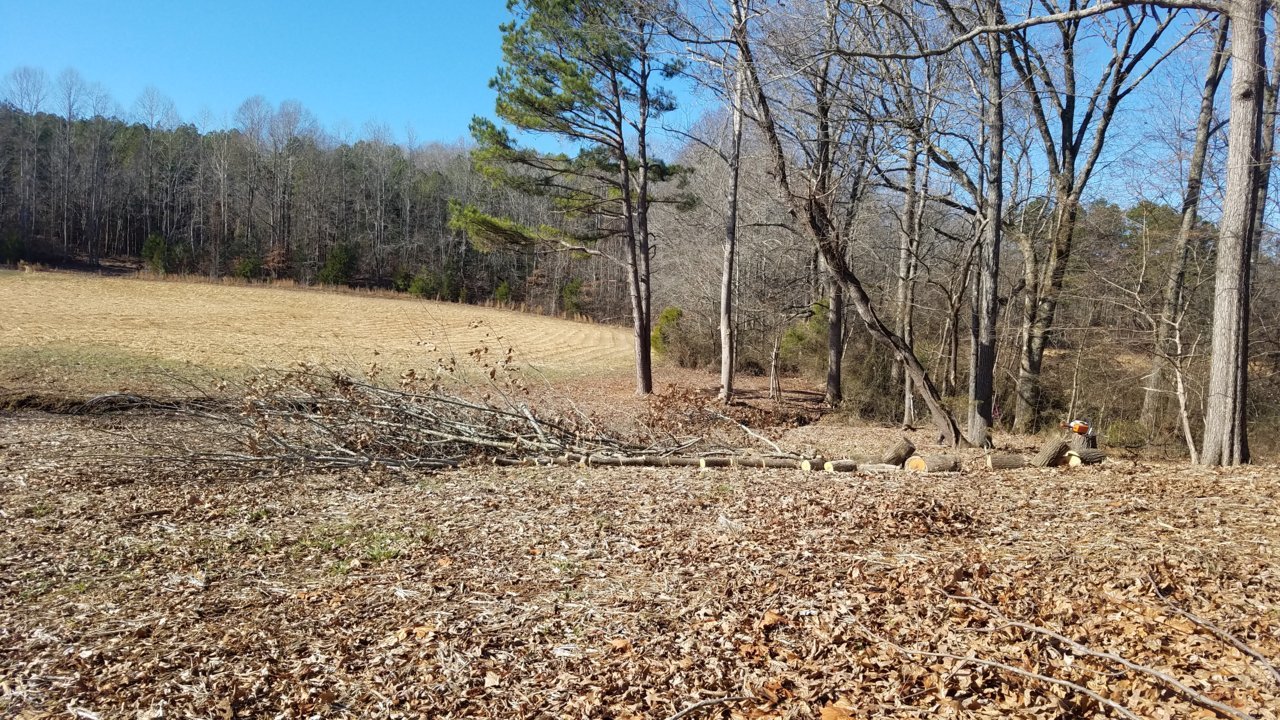

    I used my chainsaw for the first time today to cut down a couple of oaks at my parents' house and cut them into pieces for them. I won it in a raffle last year.

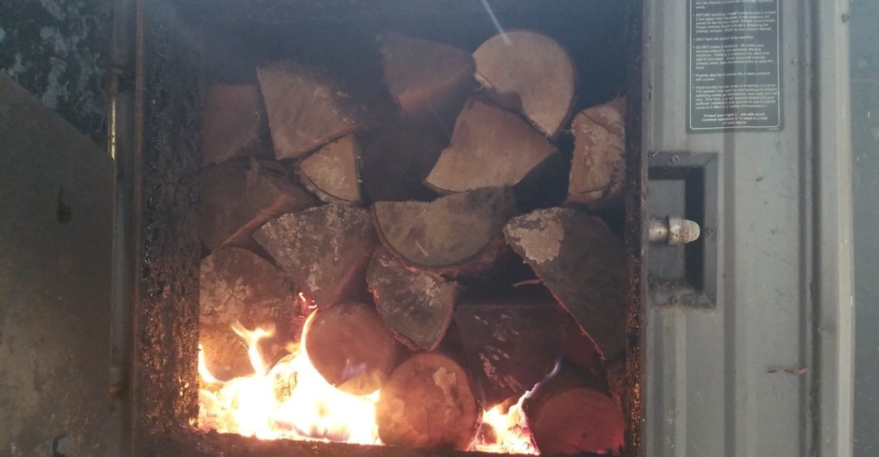

    Cold night? Pack that fucker full.

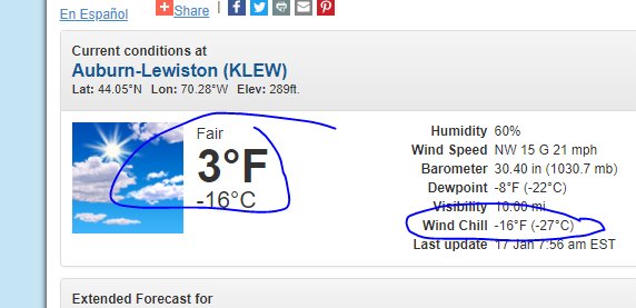

    Current situation:
    But, the house was still 72 when I got up this morning. :notsure:
