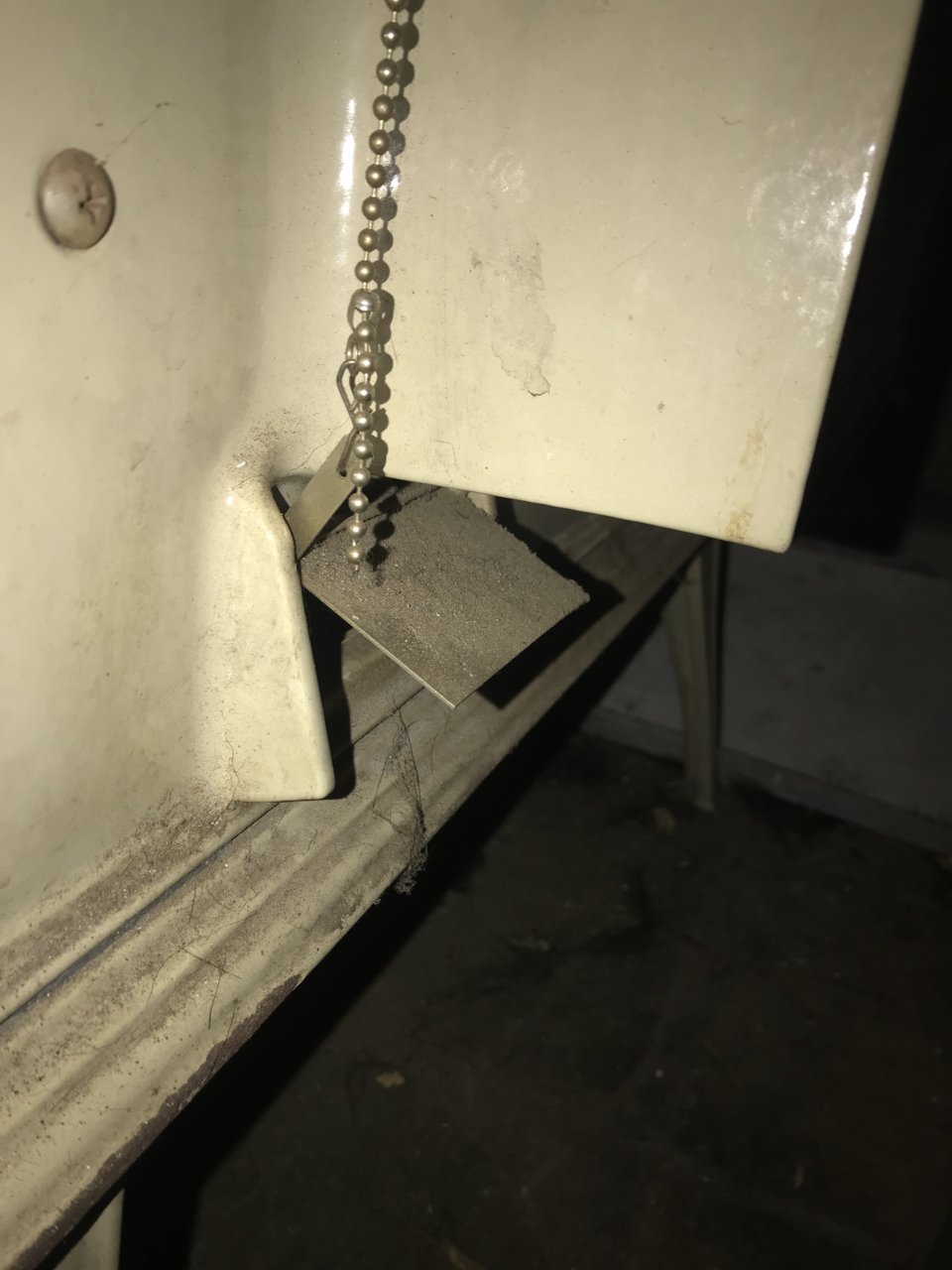

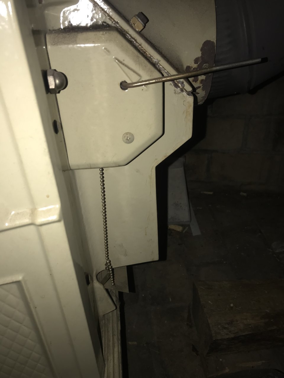

    Here’s the back of the stove. The air flow intake is the square flap on the chain connected to a lever that’s attached to the stove and thermostatically adjusts the flap for flow control but I keep it open all the way or it will smother out. 01314949-EE1F-4336-BE7A-6CB4C97393C0.jpgEA0E4507-CF53-41E2-B7A6-3227AE6BF83C.jpg

    If you're keeping it wide open all the time you have bad draft. Is your house really tightly insulated? If so you may need to open something to allow some outside air into the room where the stove sits.

    Sort of. There has to be air to go into the stove and up the pipe.
    I cannot say I have seen a stove like that.

    Post some pics of the whole stove. From what you posted -the stove looks like it may be a well-constructed unit. This is not to say that there may be things that have worn out or need repairing. Include some pics of your flue system as well.
