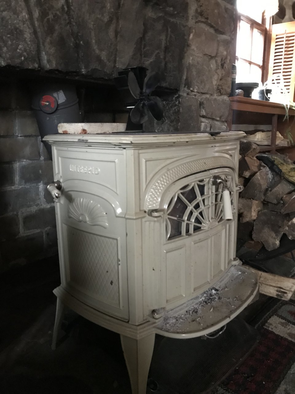

    I think I see (maybe) the problem!!!! If that stove pipe is just loosely stuck up in that fireplace flue, then most of your "draw air" is being sucked up the opening around and outside of the woodstove flue pipe. If you could somehow tightly seal the opening around the outside of the stove's flue (remember it has to be with something non-combustible, as that stove flue gets super-hot), I bet your little "Intrepid" would work much better. Any "standard" fireplace opening is always notorious for wasting energy, as they act as a great big vent sucking air out of the house. I know this because we have a standard fireplace in our home and we always have had doors on the opening.
    Air when rising, will always follow the path of least resistance -which in this case is around your stove and not through it. When this happens it sucks what heat your stove has put out, right up the chimney, not letting it heat your room.
    Check out the design of any fireplace "insert", and you will see they shut off any air flow up the chimney so that all of the chimney draw is restricted to only thru the insert's air intake.

    Hey TW,
    Could anyone tell me what this stove might be worth?

    WRONG -- check out various websites that specialize in values of old stoves. Not too many years back I had an old "pot-Belly" stove that I bought at an auction on the 4th of July week (it was 95 f that day) for $5.00. Two years later I sold it for $275.00. Moral of the story- don't sell without thoroughly checking what you have. I actually bought mine to heat my garage and only sold it to get something more efficient.

    Google the EXACT description of your stove -as you stated in this post, and you will find out what a good stove you have! Now if you could get installed correctly, I am thinking you would be a "happy camper"!
    Keep us informed how this comes out - "inquiring minds" want to know -also me to.

    I have been told many times how good the stove is. And have had an offer of $3000 for it..lol. Works too good, when it works properly, to give up. I'm hoping just a proper lining of the chimney will do it.
