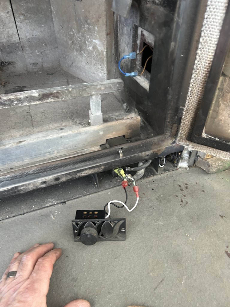

    IMG_8560.jpg IMG_8561.jpg I bypassed the thermostat fan control on my Elite. It’s not difficult. The thermostat is located behind the first brick to the right…

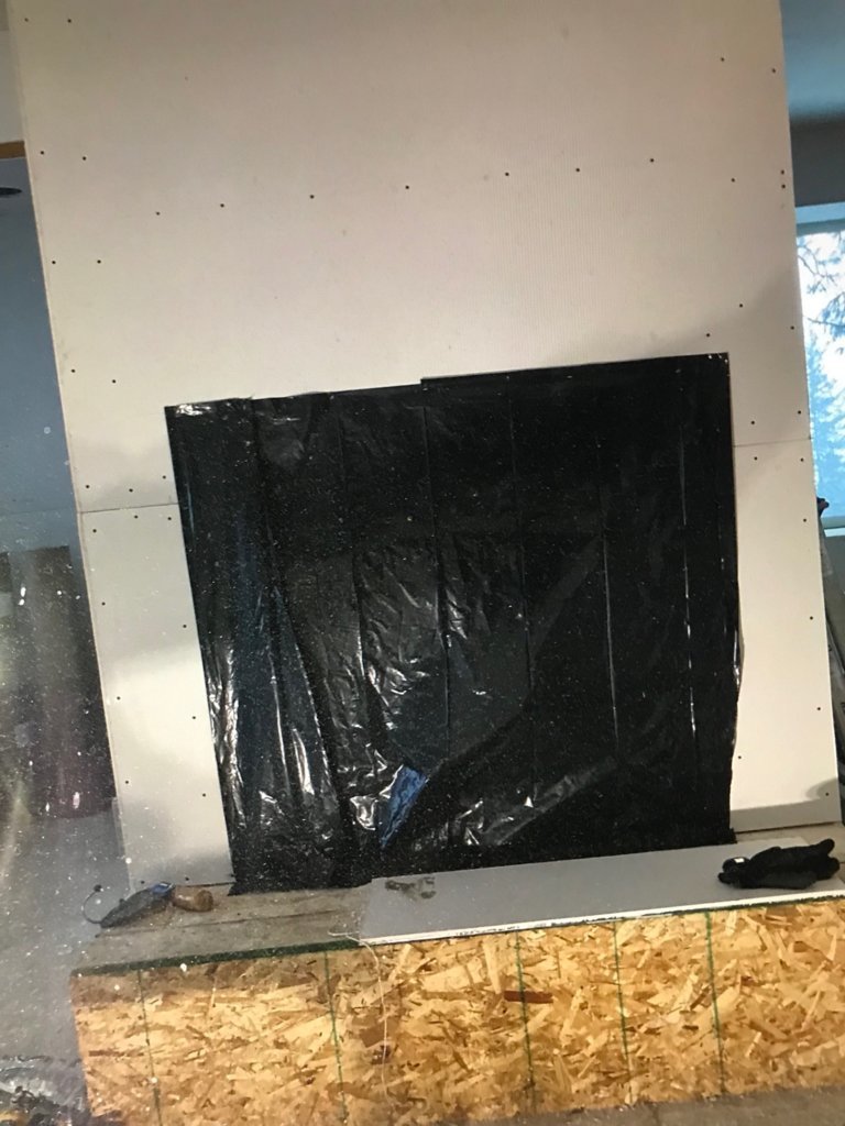

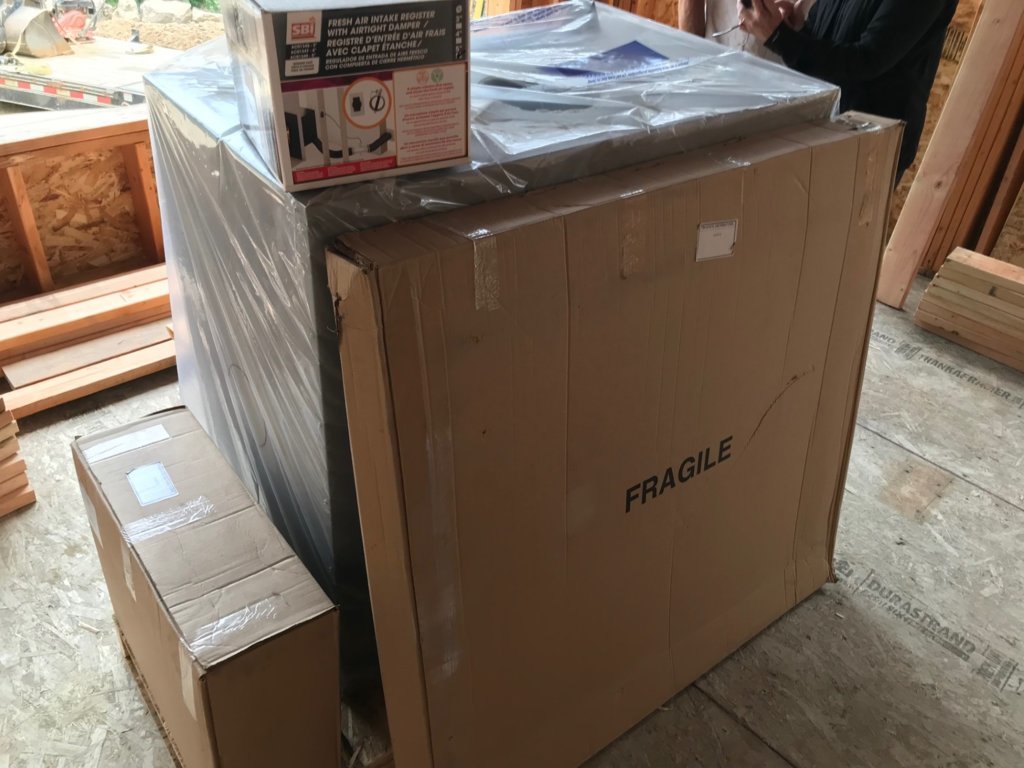

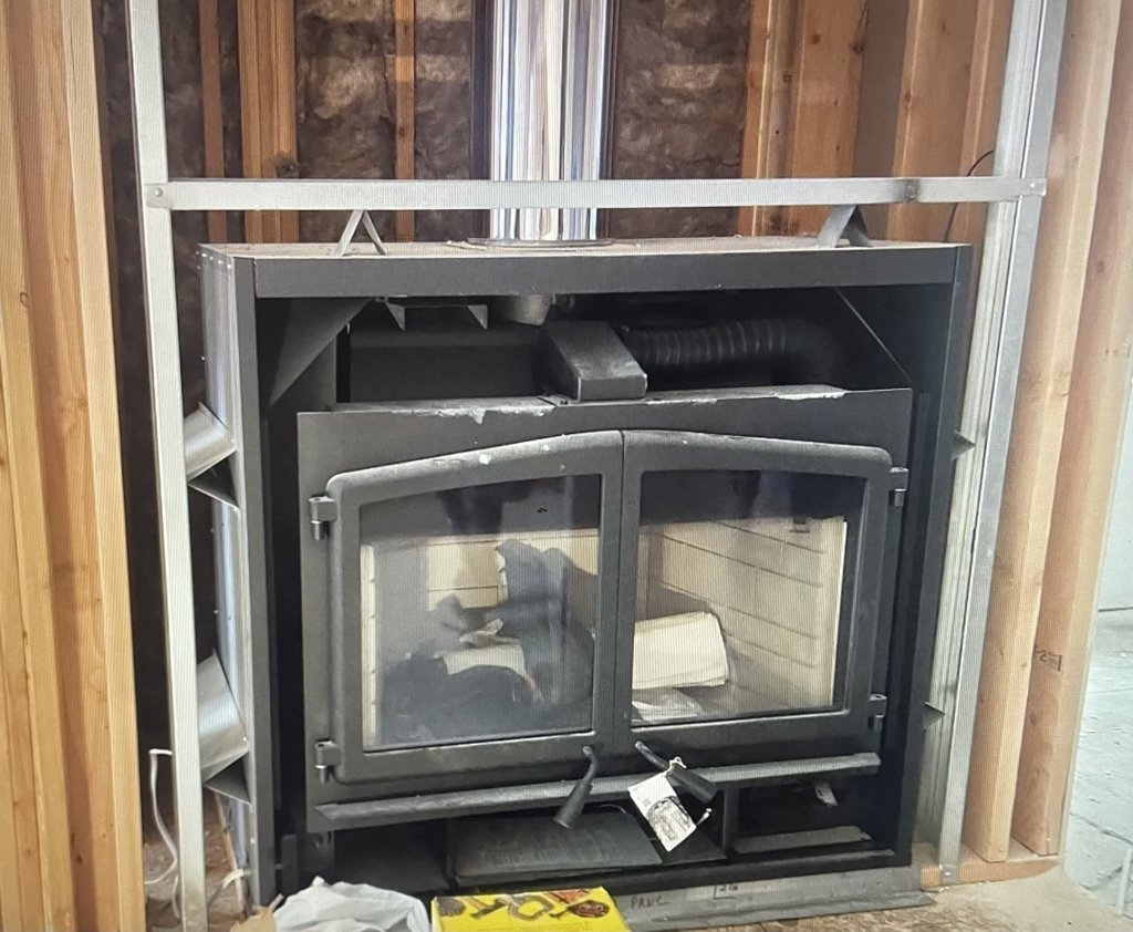

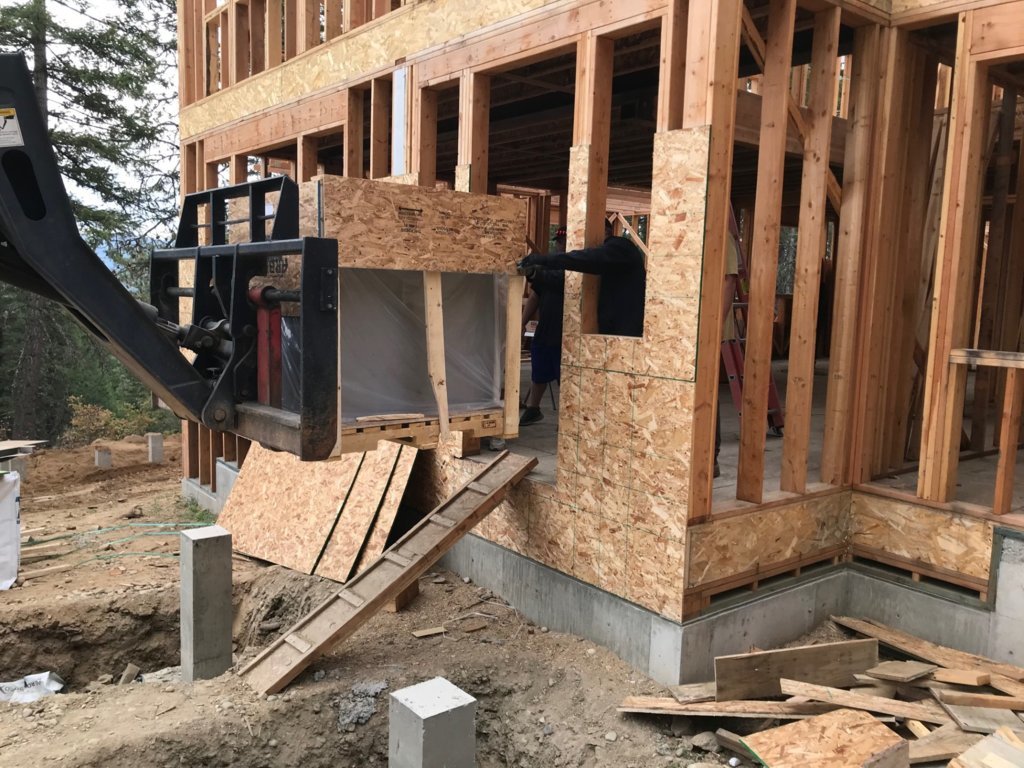

    Getting the big OsBurn Horizon ZC in the front door of the Idaho build
    Stone hearth & either quartz or tile surround.
    Rheostat blower switch on side wall.
    8 " triple wall class A with a 25 ft run in insulated chase.
    Stove is set up 18 inches
    Buttoned up with the Durock

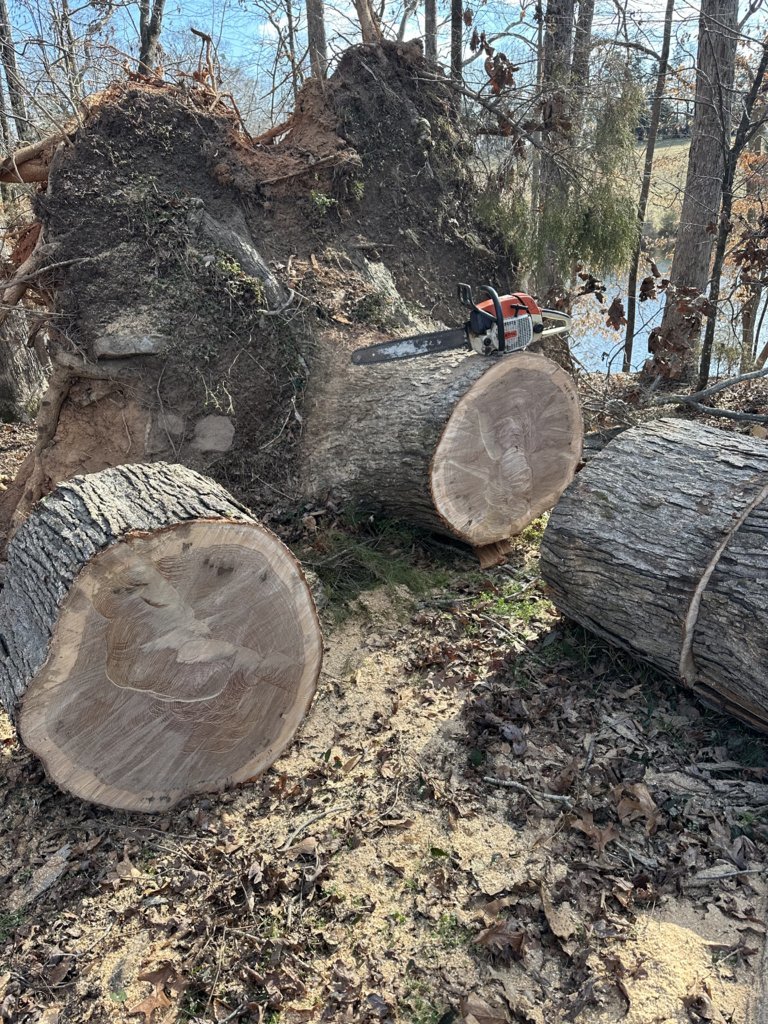

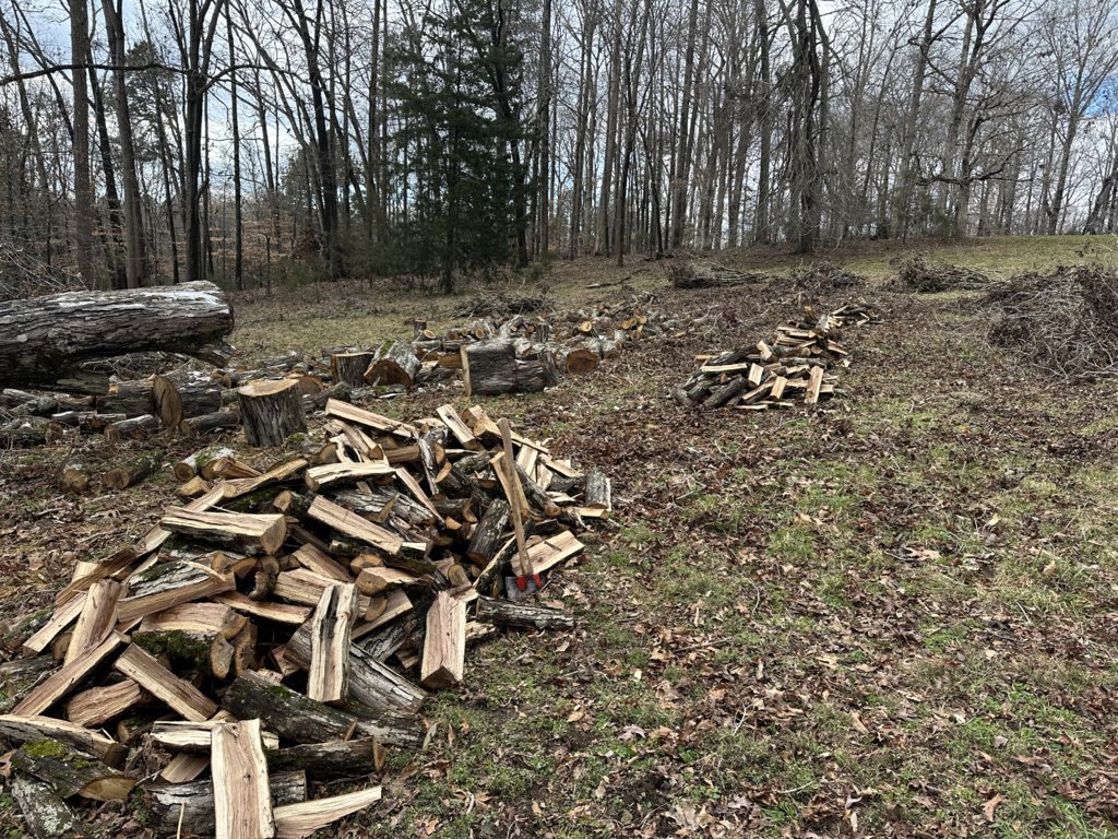

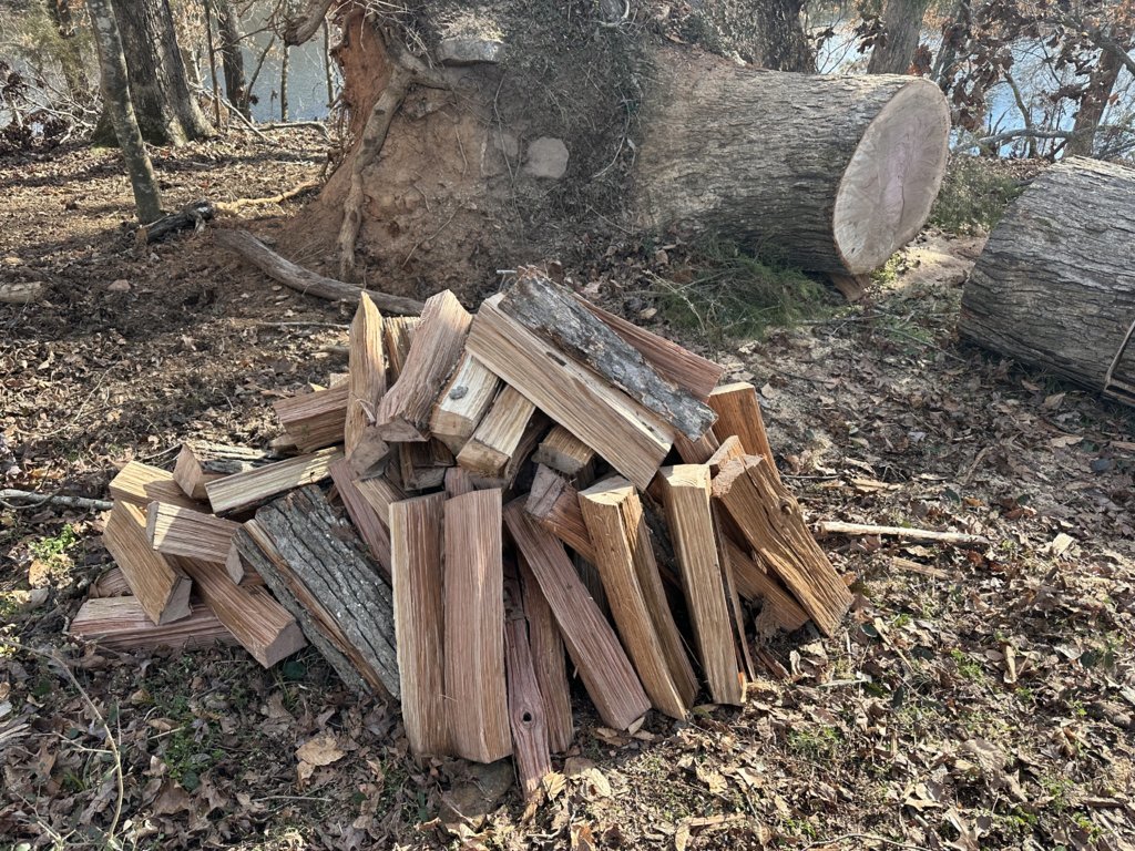

    Took the splitter and finished up what I couldn’t axe. Around 3 1/2-4 cords I think. Hauling starts next weekend maybe.
    70pcs out of that one wafer.

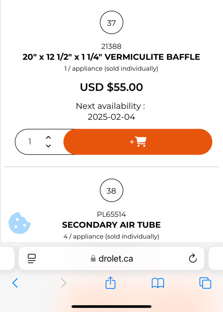

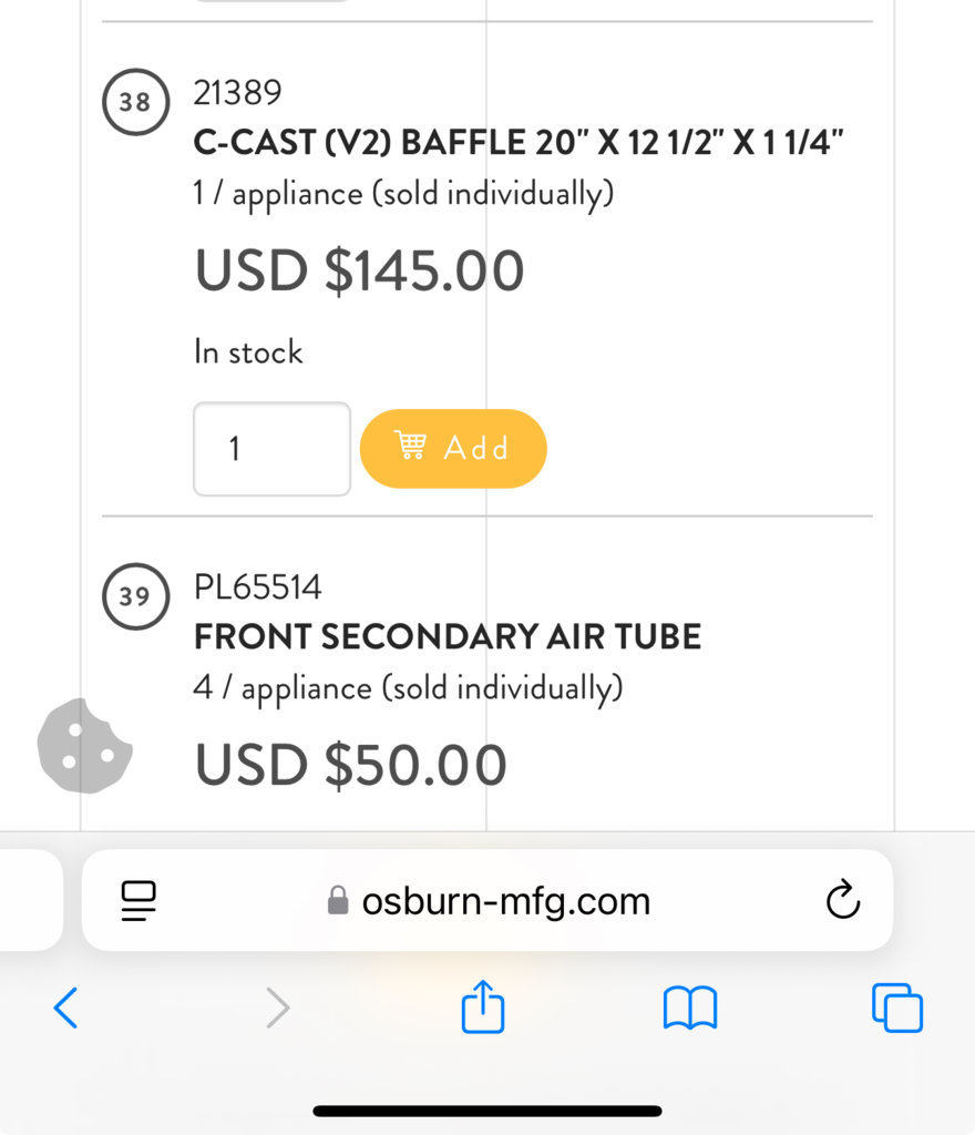

    Question for the group, hopefully easy to follow and thank you for your time:
    I have a drolet 1800 wood insert, the vermiculite baffle is/has been cracked since I purchased the home (cleanly right down the center so i have still been using it moderately) from what I can see on the interwebs it happens pretty easy as this is a somewhat fragile material.
    Also on the interwebs I see that I can potentially replace the vermiculite with a c-cast baffle? is this worth it, last longer? What’s more efficient?
    C cast is considerably more expensive. So I can go through a few vermiculite for the price of one. also if I’m missing something and these materials aren’t interchangeable shoot this down too.
    (Any luck with knock off from Amazonn? :anonymous:)
    The c-cast baffle seems to come from maybe a sister company from drolet, “Osburn” but the dimensions are the same..
    Also I guess I could reach out to drolet but TW is more fun of course..
    Link to my stove/replacement parts https://www.drolet.ca/us/en/parts-and-manuals/db03125/
    Osburn stove with same dimension https://www.osburn-mfg.com/en/replacement-parts/parts-list/?productId=OB02016
    prices from manufacturers:

    These baffles are a rather recent introduction to wood burners. Yes, they increase burn efficiency, but,....how much.
    I would run the split one until it fell out. Then I would replace at and be careful while loading wood.
