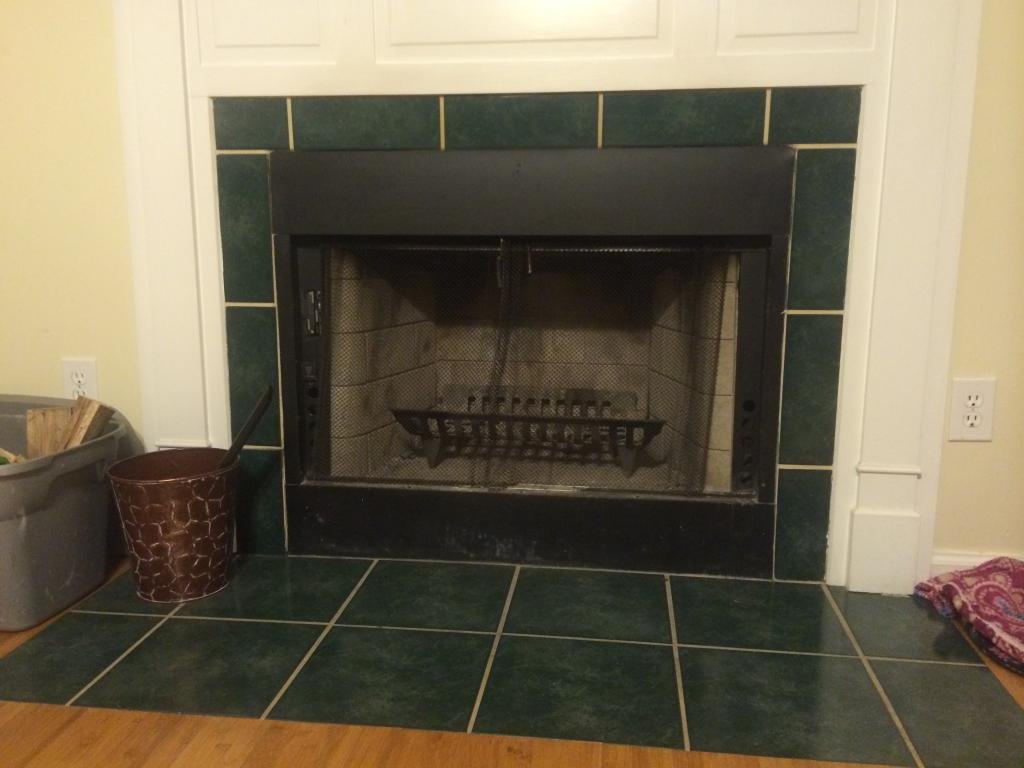

    Looking for advice with for a prefab'd fire place.
    Yeah, it sucks, but the house I bought has a prefabbed fireplace. So an insulated box with a wood-burning insert stuck in there. Doesn't even have real brick, just ceramic molded sheets with the lines etched in to look like brick that cover the sheet metal of the insert.
    Anyways...... What's the best route to go about get this swapped out for a wood stove? There is one fireplace store in town but they have absolutely terrible hours, aren't open weekends, and I can never seem to catch them on the phone. I'd really like to have a stove versus the terrible in-efficient fireplace that I might be losing more heat out of than generating. I still burn the hell out of some wood in it, but it's starting to take its toll as there are cracks starting to develop in the fake brick sheets inside of it.
    Anyone have any experience with something like this? At least here in NC, I have plenty of oak to burn which is a good change from the pines/fir back home in Idaho.

    Any pictures so we can see what it looks to be? Is it a prefabbed model like what you'd see in mobile home or something similar? Is it built into a corner/wall or is it free standing?

    Pictures as requested. It is built into the wall. Made by Superior Fireplace.

    Masonary chimney ?

    No, it appears to be just an insulated rectangle with the stainless chimney tube up the middle. It has the same vinyl siding on the chimney as the rest of the house, I don't believe they would throw vinyl over brick.

    You'll have to pull the existing clearance unit and reconfigure the bottom section of the insulated chimney to come out the wall , extend your hearth , fix big hole in the wall

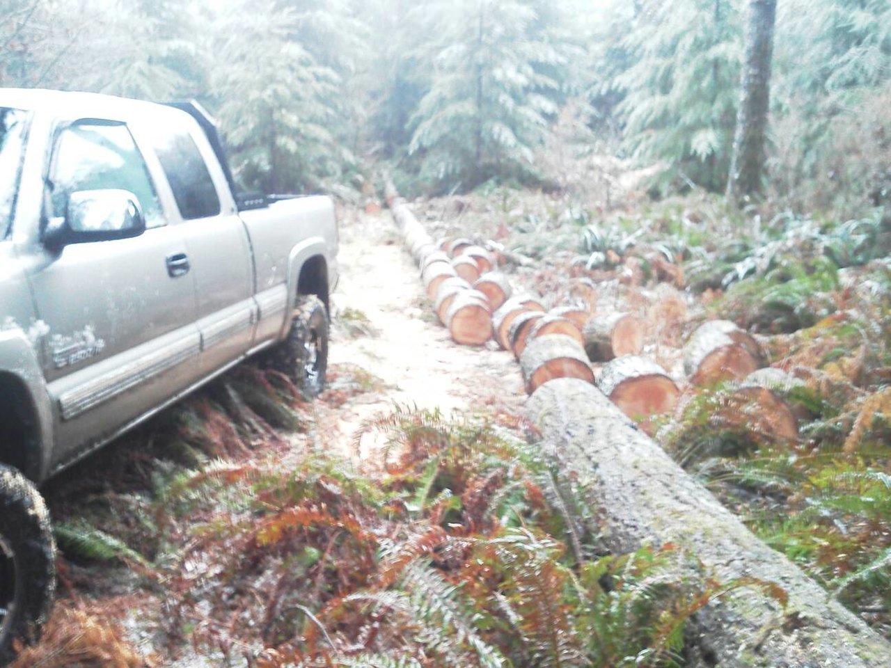

    Love cutting wood. Picture of last winter cutting up a downed fur tree on the back 40

    X2.
    Unfortunately there's no easy/cheap way to retrofit one of those units, unless you mickey mouse it. I've seen them before where people have ripped the doors off the fireplace, extended the hearth, put a woodstove on it and shoved a round stovepipe up the existing square clearance unit.
    Technically it works, but by no means does it meet code. For very good reasons. NOT a safe setup.

    Well I certainly appreciate the insight. That's all depressing to hear as all I see are dollar signs in those words. I'm thinking it would just be much better to keep being inefficient with burning wood in the current insert more for atmosphere than actual heat output. I would absolutely love a wood stove, but I'm not sure I would love it $3000+ compared to keeping the fireplace.

    Beautiful straight tree... could have been a ship's mast.
