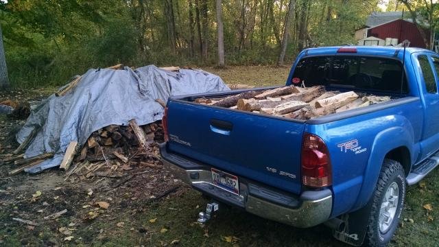

    Trucking wood home from the stash spot. #Ineedsomedakars

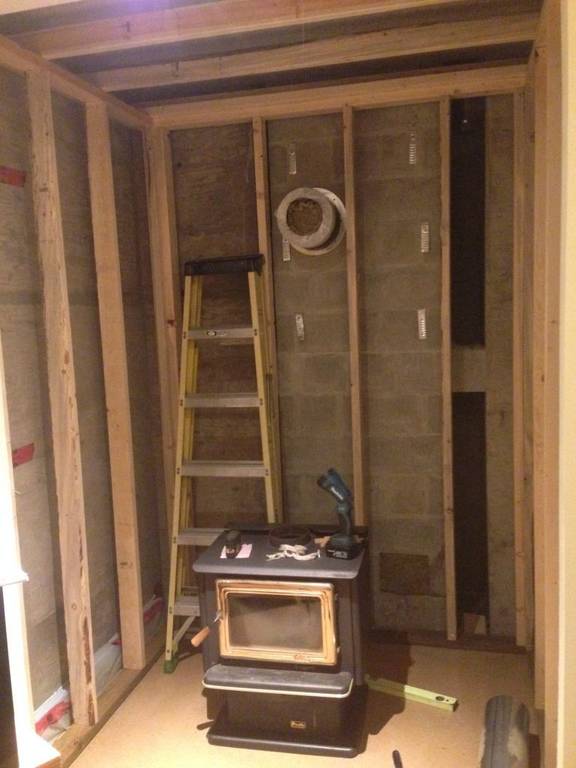

    I have some questions, not trying to thread jack. I'm looking to get rid of my gas stove and replace it with a wood stove. I have a terra-cotta lined chimney and sleeve that passes through the wall. What I'm wondering is, what spacing dimensions are required for wall studs and insulation from a stove pipe passing through the wall. I'm not sure if this was built with the house originally. The sleeve is 8" in diameter. Don't mind all the dust. I'm in the middle of remodeling this room.

    Here at least , there needs to be a minimum 2" clearance to combustibles from the masonary chimney , that will be greater to the black stove pipe

    Ok, so if I had something like a 6" pipe running through the sleeve, that should be good to go. Assuming codes are similar. That makes me feel better. I didn't want to have to pay an inspector to come and check it if there wasn't any chance of it passing or being safe.

    Here you would need an insulated thimble to be able to enclose the pipe in a framed wall , I just did this at my own house

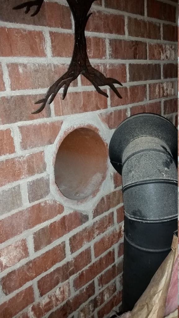

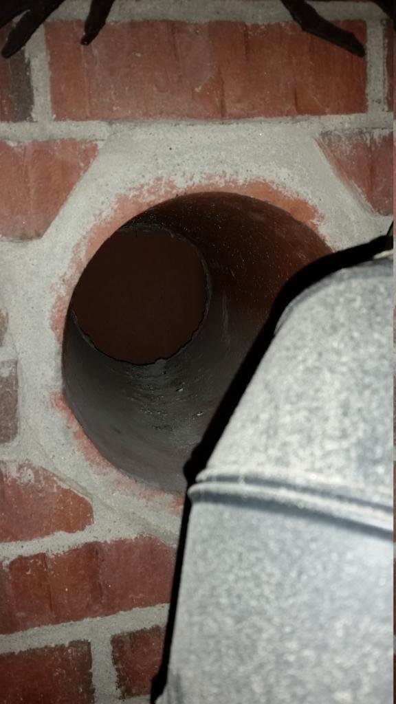

    This is what I used. The box passes through the wall between the studs. Outside the chimney comes out In the middle and the fresh air intake is just above it with a hood.
    Don't mind the frost, it was -15F outside when I took the pic:D
