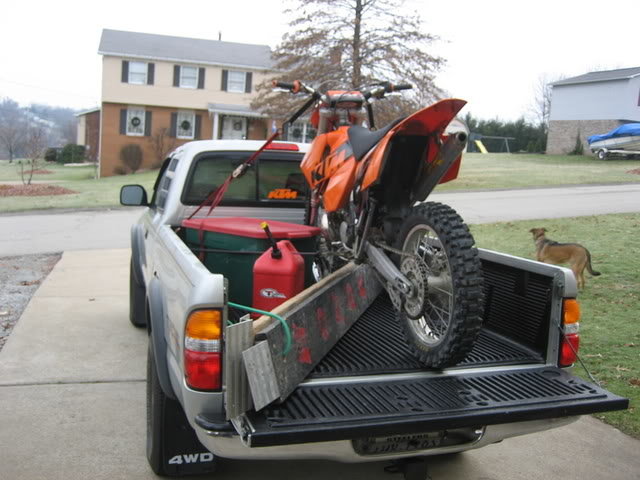

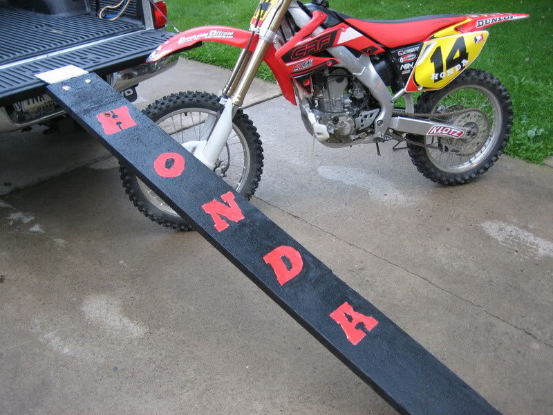

    I have used 2 2x10 boards to load a CRF250r and a 200exc. I purchased the metal pieces at Lowes for $25 (2 in a pack). The boards are very sturdy and I walk up one as I push the bike up the other. They flex a lot and my bikes only weigh 250ish. I wouldn't exceed 400# on them.
    If you can spend the money, get an aluminum ramp. If not, put a support board under the ramp. Maybe tack a 2x2 along the length of the underside of the ramp.
    I would prefer the aluminum ramps but they run about $250+.
    If you do use the wooden ramp, waterproof it with paint. I also added kitty litter to my paint to give it some grip. It's heavy but doesn't flex as much as my non-painted ramp.
