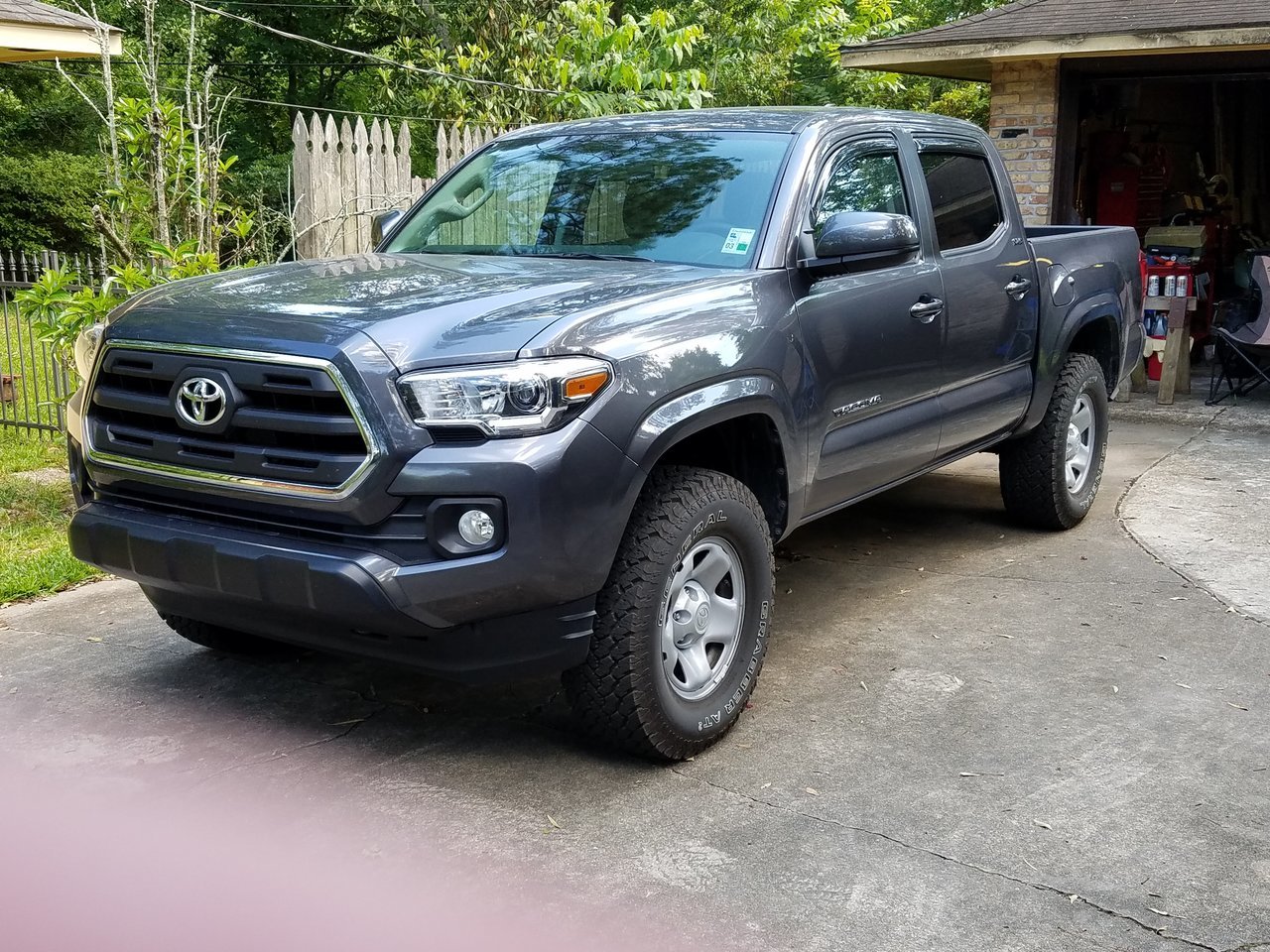

    Here is the truck shortly after I bought it. Pretty simple.... Hankook Dynapro 245/75R16 on steelies and no fender flares.
    First thing was to upgrade the tires with General Grabber AT2s in 265/70R16. Close to the same diameter, but 20mm wider. Tires were only a touch louder in the beginning, but after 35K miles they have gotten louder. Otherwise, they have been great and look good. I hope to upgrade to 255/85R16s and do a lift when these wear out.

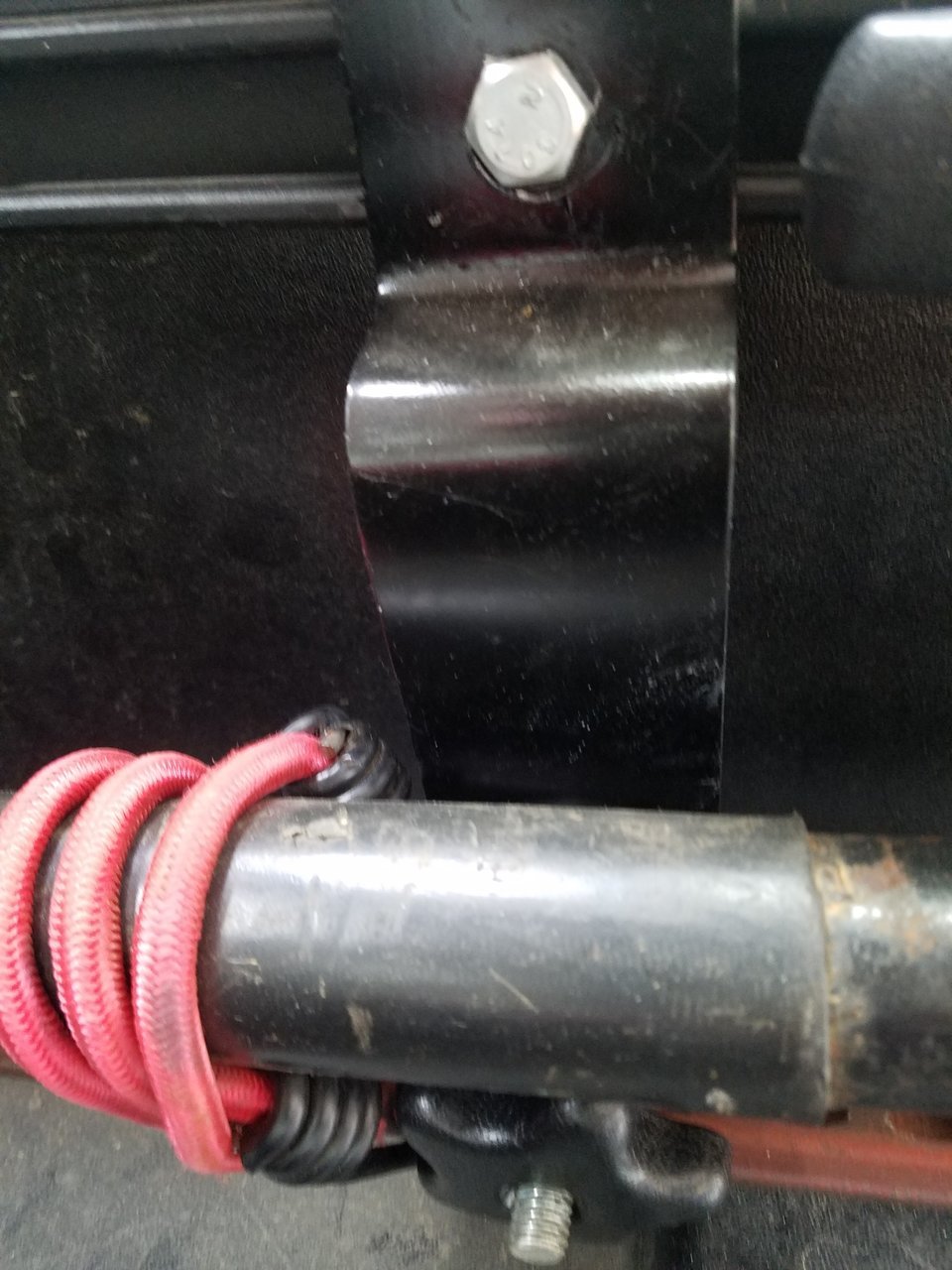

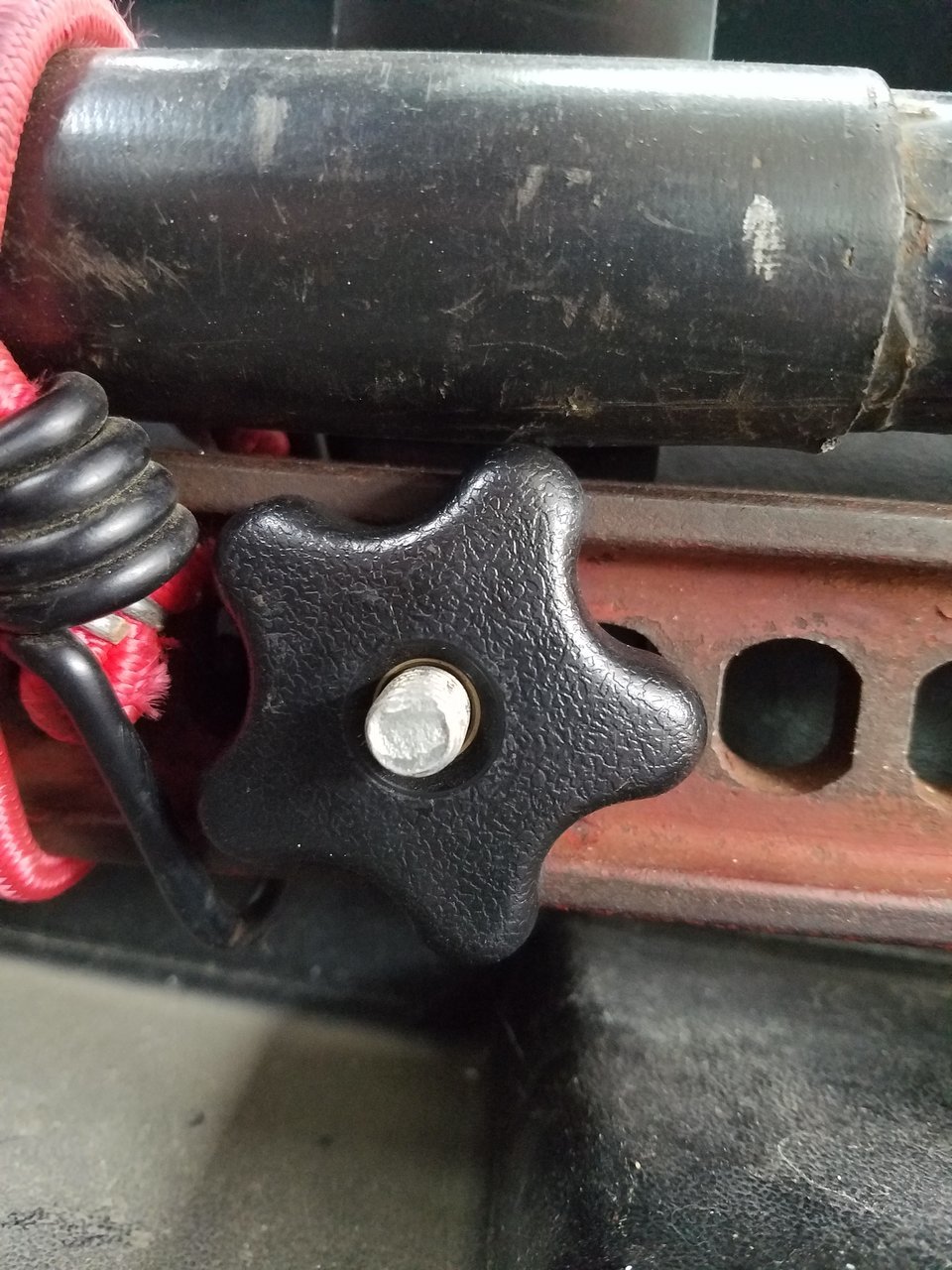

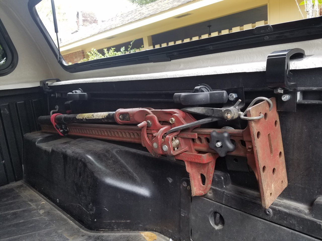

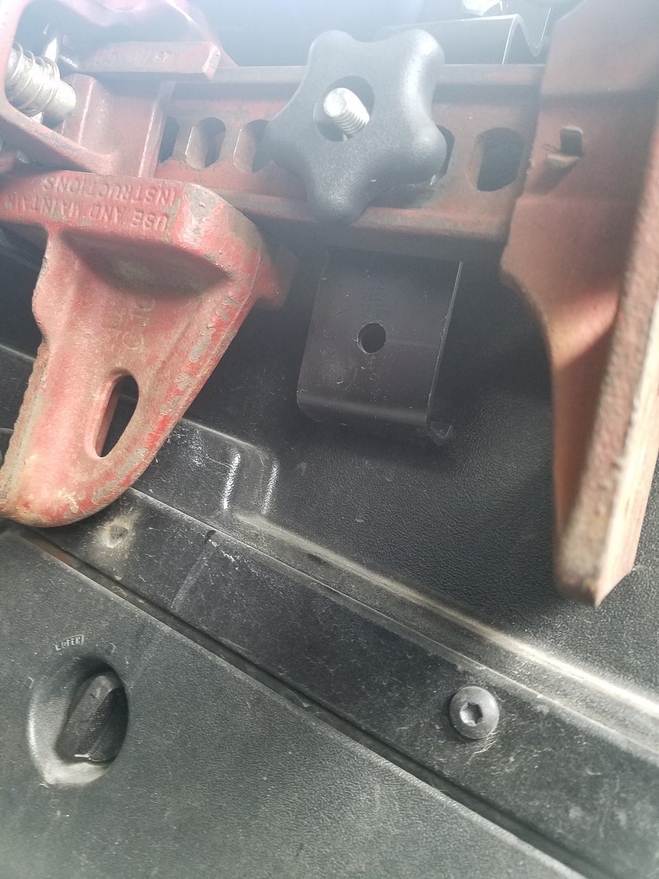

    High lift Jack mounts....
    I bought some T-slot nuts for mounting. I cut some bar stock I picked up at the hardware store and bent it to fit. Drilled some holes, got some bolts and nut handles and put it together after painting. There is an extra hole that was my first try. Bungee cords just reduce rattle.

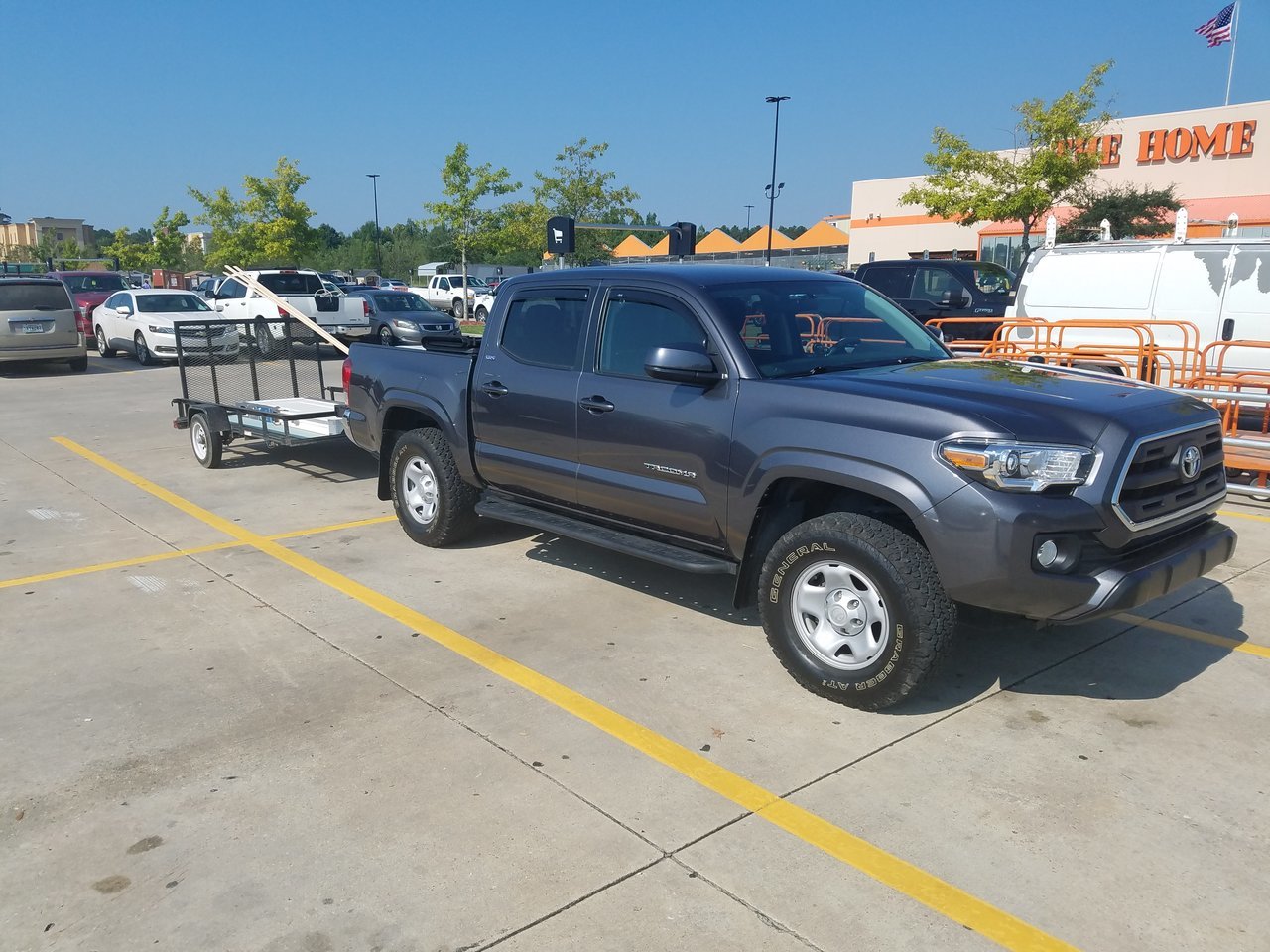

    Got some new shoes. General Grabber X3s in 265/75R16s
    I wanted to try some MTs and was hoping these would be a good set. The AT2s were a great tire, but they needed a little help in the mud.... just when it got a little mucky.
    Pros:
    They work great in the mud.
    They look great.
    No rubbing in the 1 inch larger diameter
    Cons:
    About 23lbs heavier than the AT2s.
    Definitely hitting 1-2mpgs worse.
    Definitely talks a little on the highway.
    I had a little squirreliness on the highway, but that seemed to settle down after coming down from 40psi (installer pressure) to 32psi
