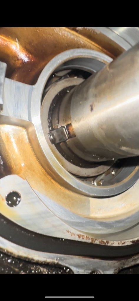

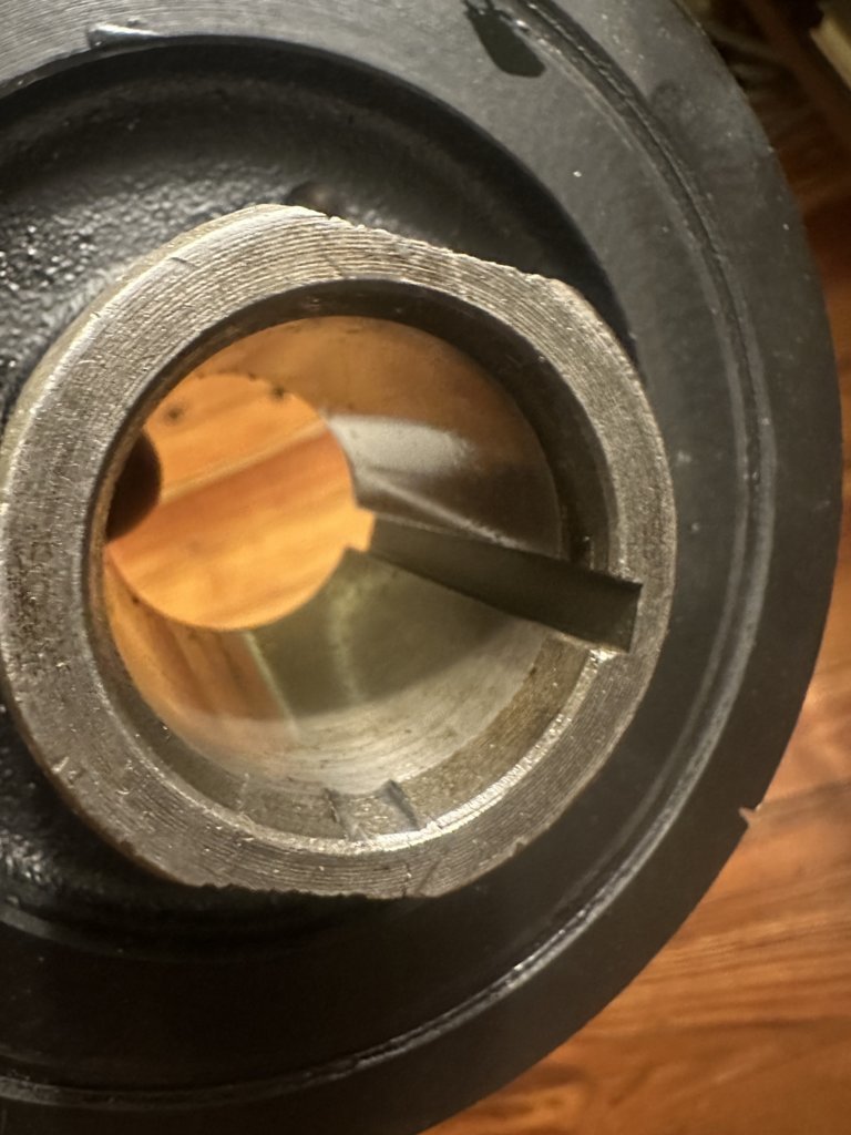

    Had a big oil leak, so I replaced my harmonic balancer and front main seal. After the job I ran it for a bit and all sounded good -- no issues. I then noticed another leak behind oil pump cover, so I went back in to fix that. When I removed my new harmonic balancer, I discovered that I'd messed it up -- I evidently didn't have it aligned on the woodruff key properly, so when I torqued it down, I put a hairline crack in the new harmonic balancer and pushed the woodruff key further down into the keyway. Not good.

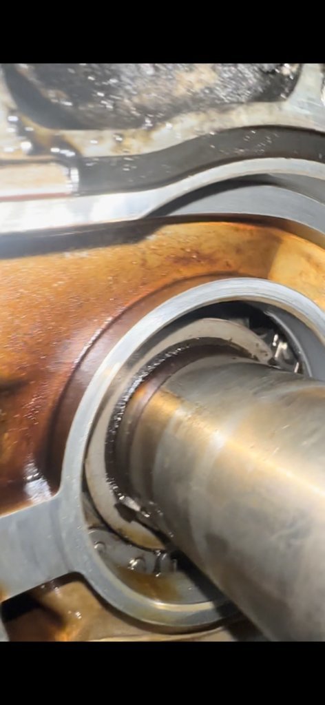

    Taking a look at the key, it appears that it wasn't necessarily "grinded down" (like what happens when the HB spins on the crankshaft), but rather it was smushed/flipped down further into the keyway. I've now got a brand new harmonic balancer, and when I slide it on there's enough material on the existing key that it will "lock" into place like it should. However, I can't see what things look like on the back side of the key, which is mated to the timing gear. I'm not sure how much key is left there, or if the timing gear potentially cracked because of the pressure when i torqued the key into it.
