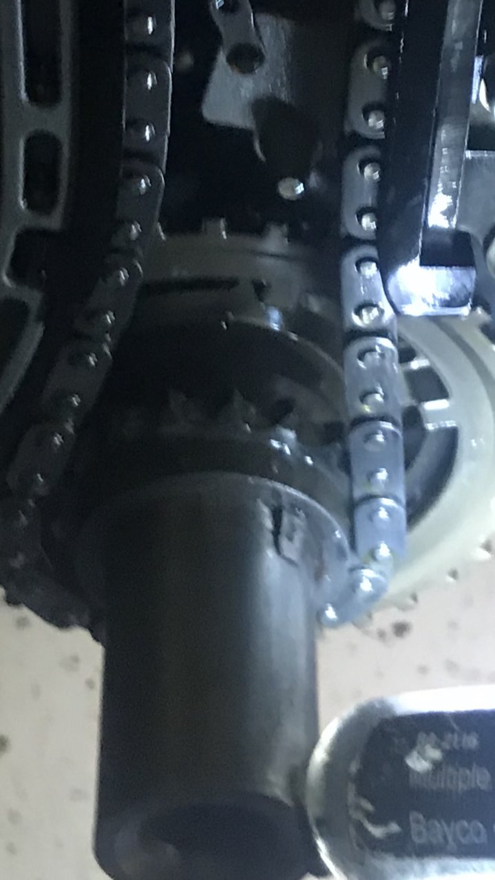

    So in removing the oil pump to a newish to me 2.7 (I just finished rebuilding the top end) I noticed the key was a bit sketchy. With that said I don’t have much to base my assumption on. Based on the pic, should I pull the gear and do a new key or just slap it back together? C857480C-CB78-4474-AE75-A66A1B7E5BC4.jpg

    I'd get a new key. Your there already. Better safe then sorry.

    Yup. That’s what I was thinking.

    If the key is flat on top and clean, without burrs, I would not replace it. It looks like it has been filed (or maybe replaced, or maybe it came from the factory that way), probably to make it easier to put the gear and crank pulley back on. BWDIK

    It’s not too flat, more of a moon.
