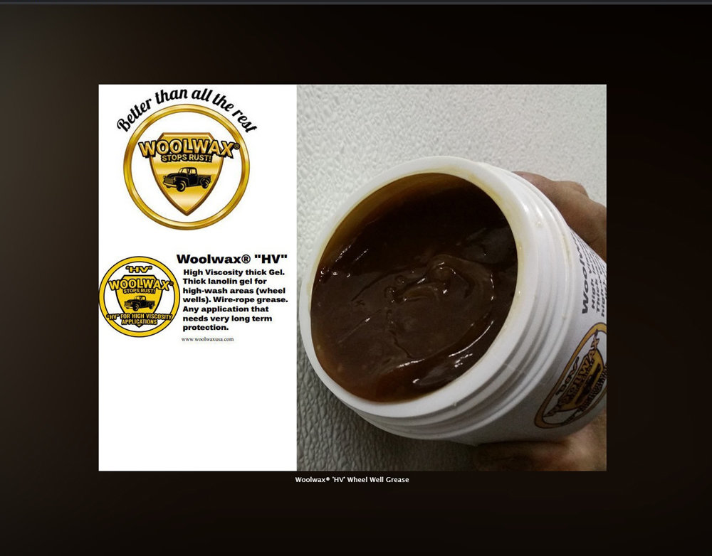

    gonna try me some of this as well
    have you used this, whats it like? is odor a non-issue?
    i have some new(ish) wheel molding bolts needing protected from wash off and maybe apply to leaf springs idk

    I love fluid film , it’s done a awesome job under my truck . This could only be better imo . I sprayed about 10 of the aerosol cans and it’s held up great . I’d like to clean it off and try the wool wax . I’m on my second year after application also

    Like a wool sweater covered in vics put in the microwave
