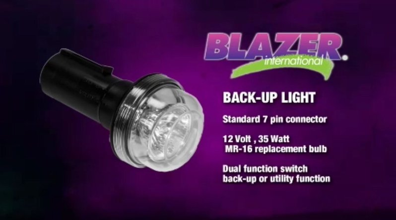

    I have seen one before, I'll do some searching again.

    Ha I didn't even see the price. They have tons online.
    Very easy to make also.

    thats a possible way to go but then you would be adding to the amp load on that circuit. keeping it to pin 4 would also keep the overall electrical load as small as possible on the battery unless it was running.
    come to think of it.... i think the pin is only energized with the truck on.
    OP... you may consider just running a seperate (Manual switch) power and ground wire from the battery and add a quick disconnect for the work light.
