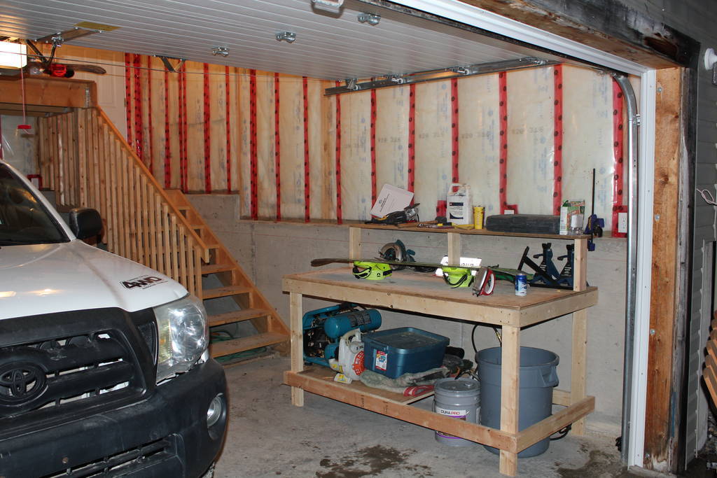

    I built this one two years ago, cost me nothing as I took scraps from construction sites I worked on. Just used pine 2x4 which is plenty for the legs, doesn't need to be pressure treated if its in your garage.

    FYI mine is 3/4" ply, last week I had an all pro bumper with a 10k winch on it sitting on the bench and no sagging. The thing is solid!

    Looks very similar to the plans I have drawn up, except I plan for the benchtop to overhang the legs by a few inches so I can put a vice on that sumbitch.
    Just curious, how high is your benchtop?
    How deep is the top?
    Is it held together with woodscrews? I was thinking about drilling holes and using uber strong hex bolts or something. Not sure how feasible that will be as I do not have a drill press. I do have a cordless drill, but it may be difficult to keep the holes aligned right.

    Will get measurements when I get home tonight. Wood screws will do fine, 4 in each corner on mine.

    Off topic but what's the deal with the vertical Tuck Tape at every stud on your vapour barrier ?

    Keeps the vapor barrier continuous, covers the holes put in it from attaching it to the studs.
