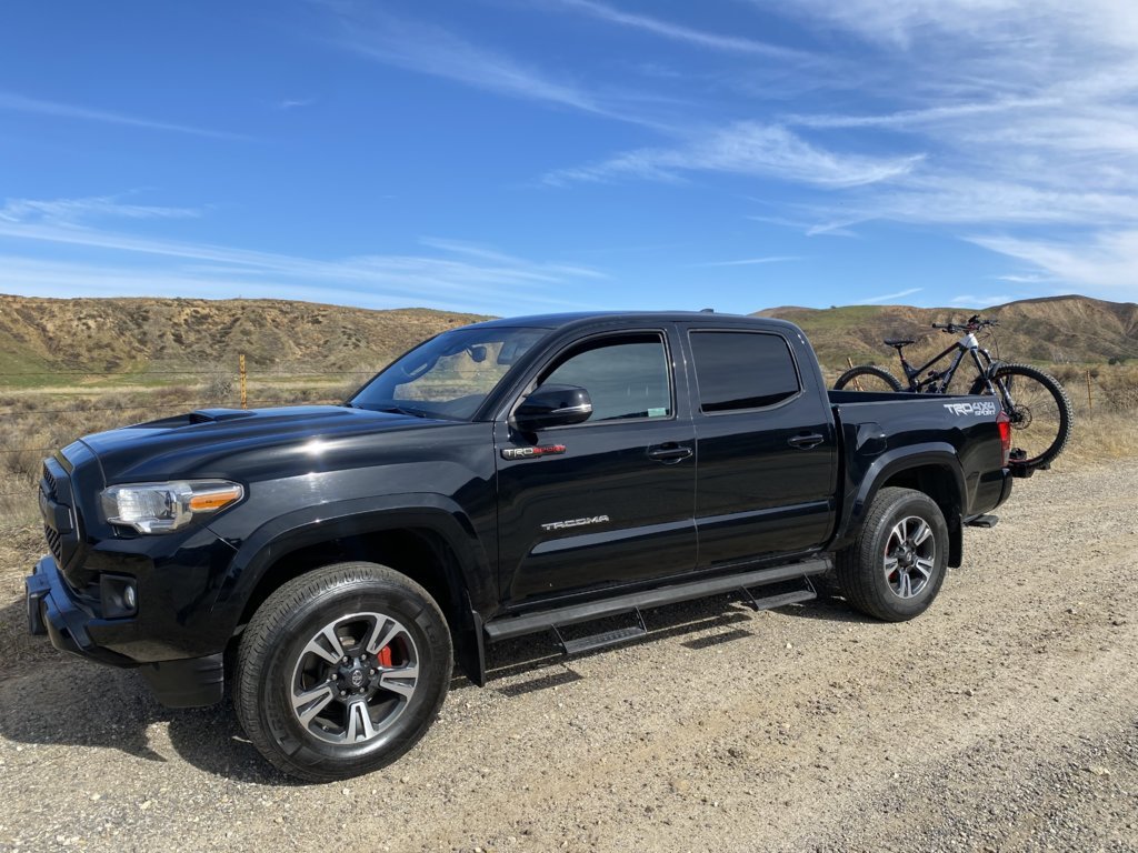

    Good call. I actually had the lift removed this weekend in case I need to take it to the dealer for a warranty claim. Hope it was a good decision.
    Sound is still there.
    Truck actually rides a lot better. Alignment is great and the ride isn’t as firm now. IMG_9591.jpg

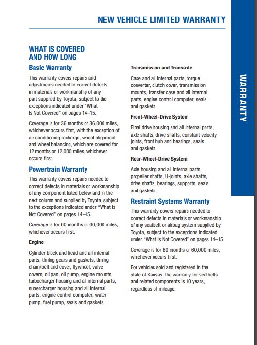

    Carrier bearings and U-joints are generally considered "wear and tear" parts, so they are not typically covered by warranty.

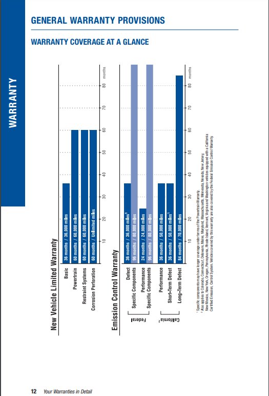

    Yes they are covered for 60 months or 60,000 miles whichever comes 1st...
