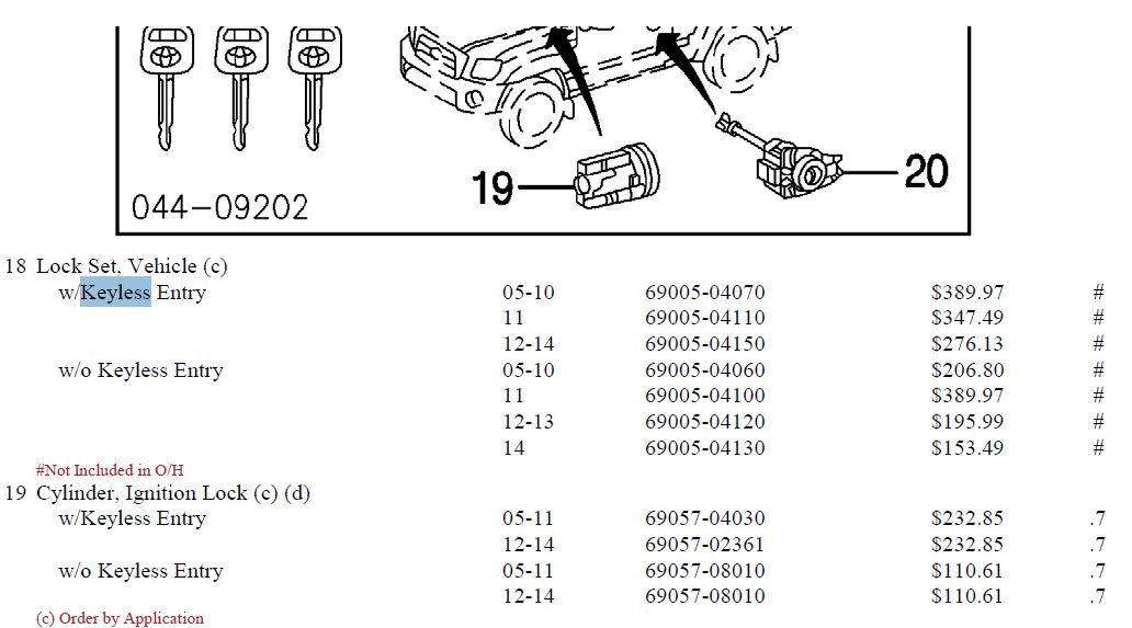

    I recently replaced two door cylinders (reg. cab) and the ignition cylinder. The passenger door cylinder was getting stuck on occasion and the ignition cylinder felt loose. It was under $200 for the new cylinders and two keys. I installed them myself.
    I bought the set (no immobilizer) with keys from the dealer.
