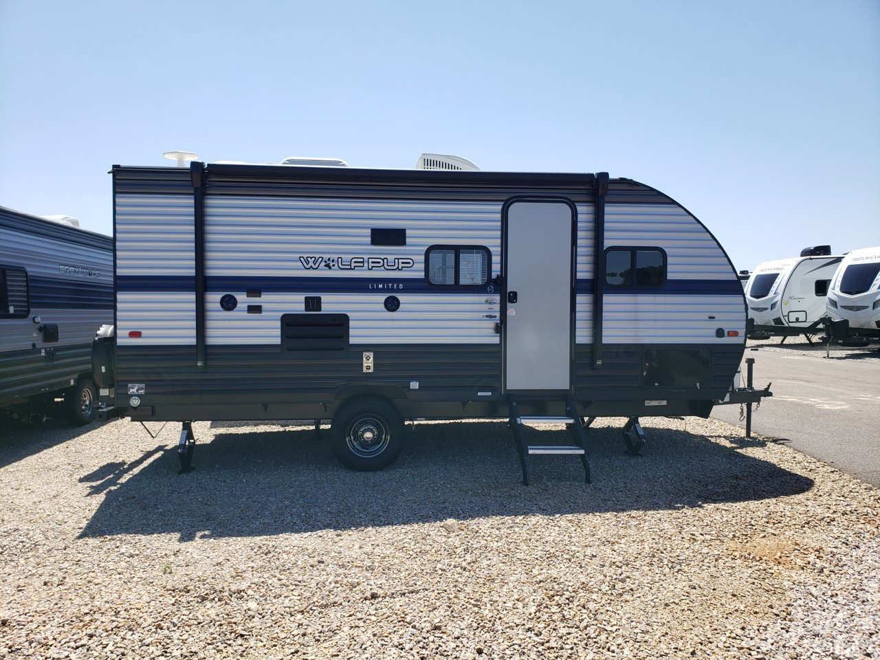

    We went back toda . I placed strict guidelines on her this go.
    We found a great 2019 Grey Wolf (new) that weighs about 3700. I'm much more confident in the Taco doing that.

    This is what we decided on.

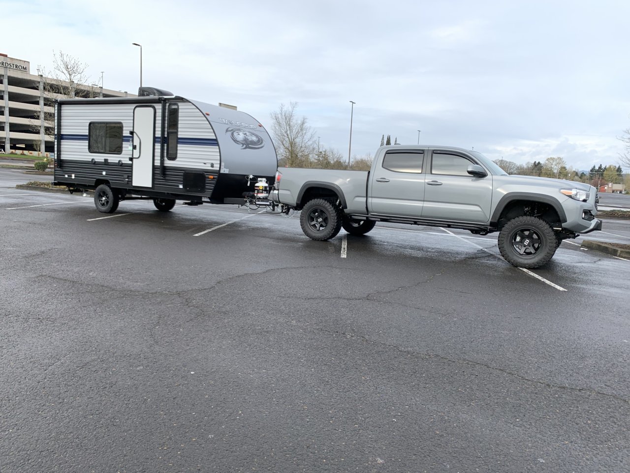

    Picked it up today!

    How did it tie for you?

    Towed great. The trip home is about an hour over rolling hills and a couple small towns. It was a bit breezy and rainy today, so with a guest you could definitely tell it was there.
    But other than that, the Taco did great. Can't wait to take a trip!
