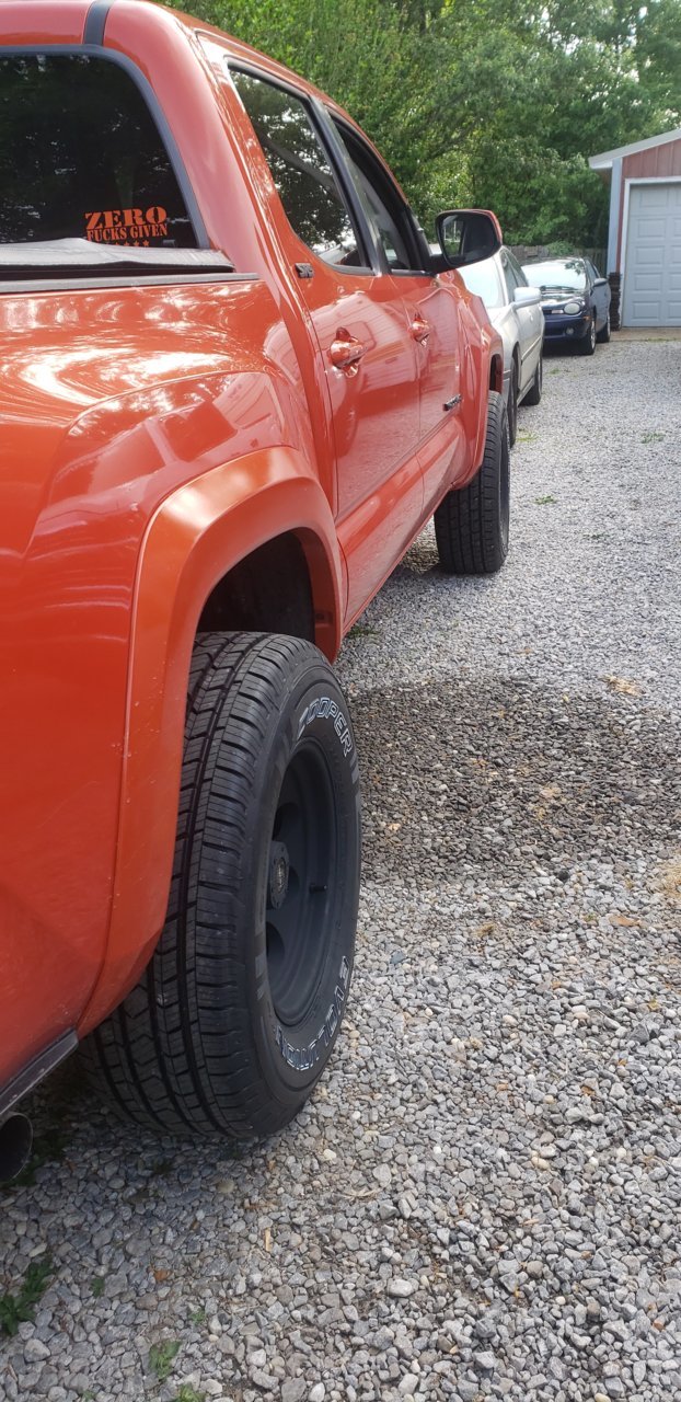

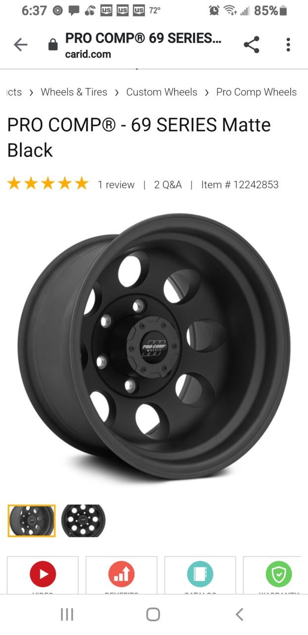

    UPDATE:
    Went with the 265/70R16's with these rims
    Taco Todd likes this.
  17. May 26, 2021 at 3:39 PM
    #17
    angry orange
    angry orange [OP] Member
    May 19, 2021
    #366188
    8
    2018 sr5 tacoma
    none
    im pretty happy with them
    rosswood, xerogs1, Junkhead and 2 others like this.

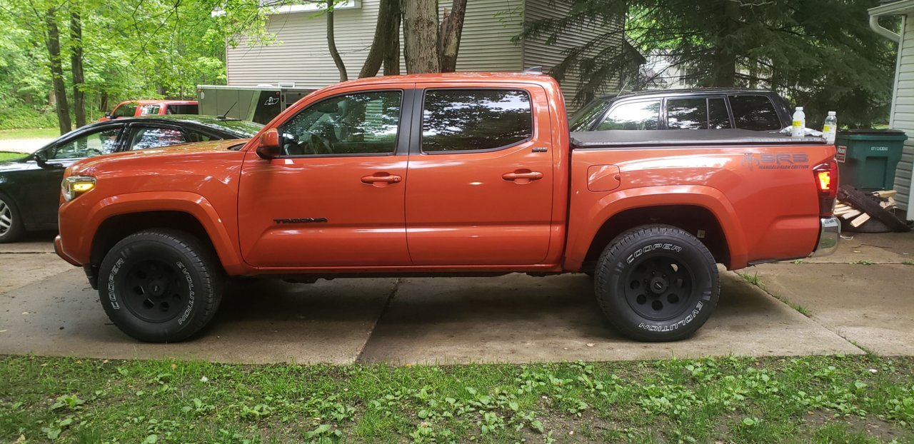

  18. May 26, 2021 at 3:40 PM
    #18
    angry orange
    May 19, 2021
    #366188
    8
    2018 sr5 tacoma
    none

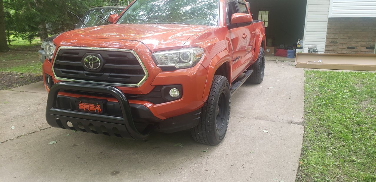

    bull bar, running boards, & rain guards.
    bull bar was a nightmare fyi
