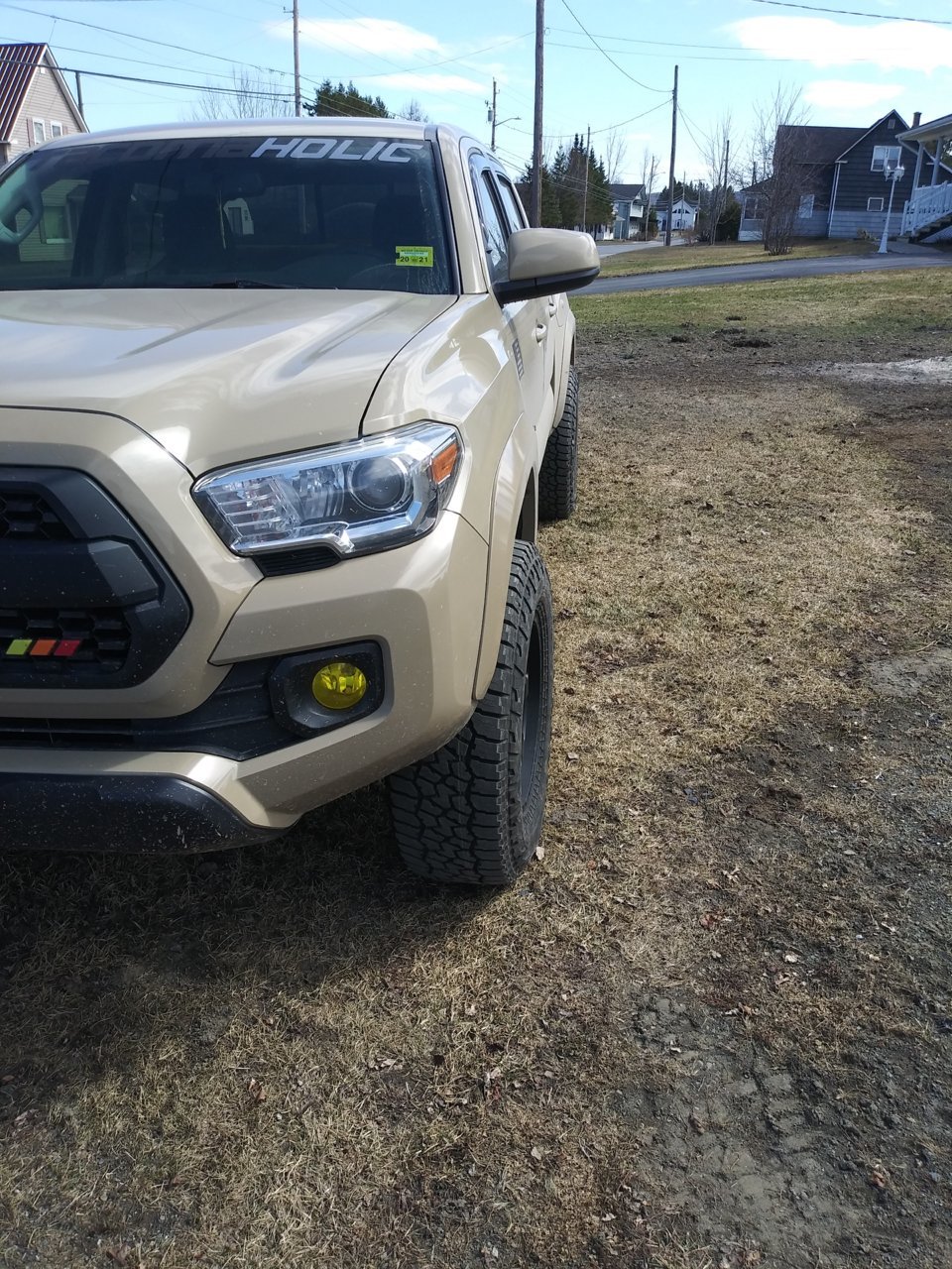

    This is the exact setup you are looking at. Very minor rubbing on mudflaps.

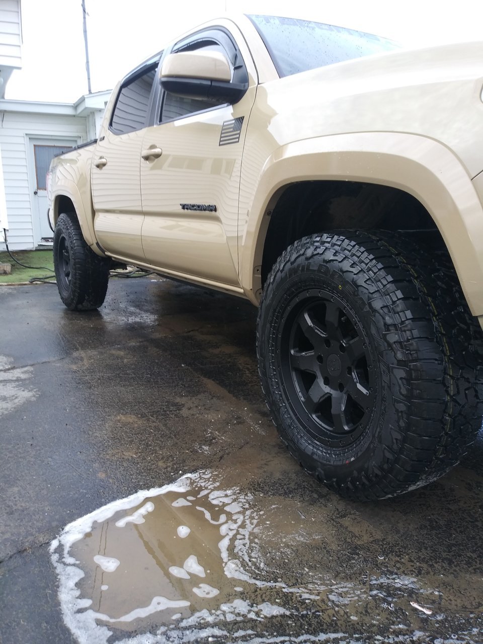

    Another picture out the poke. The tread of the tire is under the truck but the "belly" of the tire is out

    I rub with 265/70/17 (Duratracs) , 17x8 +0, even with mudflaps off.
    Only while turning and compression (eg. turning into a driveway)
    Still trying to figure out where it rubs, but it is minor.
    I am the exception though, as most people report that you will not rub.

    X2 Having the caster adjusted took care of mine. Was only rubbing on driveways. The caster adjustment moved the front wheels forward about an half inch.
