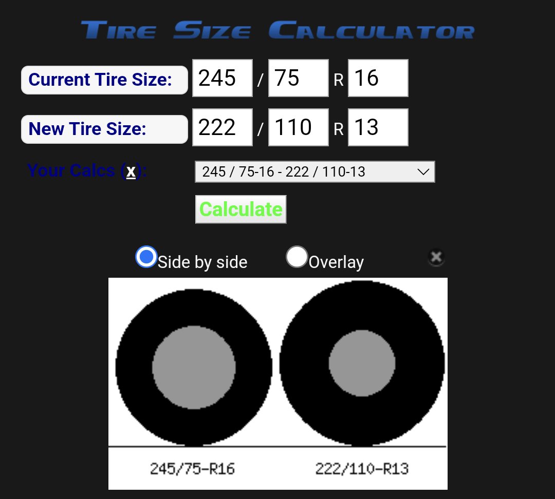

    Enter your tire sizes here to compare.

    Alternatively:
    https://www.tacomaworld.com/tirecalc
    That's actually how I found TW, long before I had a T, I used this site's tire calc while doing AutoX stuffs.

    I'm a very visual hands on kinda person and I like TW's old vs new size overlay and representative images, plus as it's a pure calculator you can enter non-existent tire sizes.
