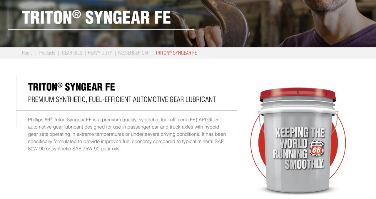

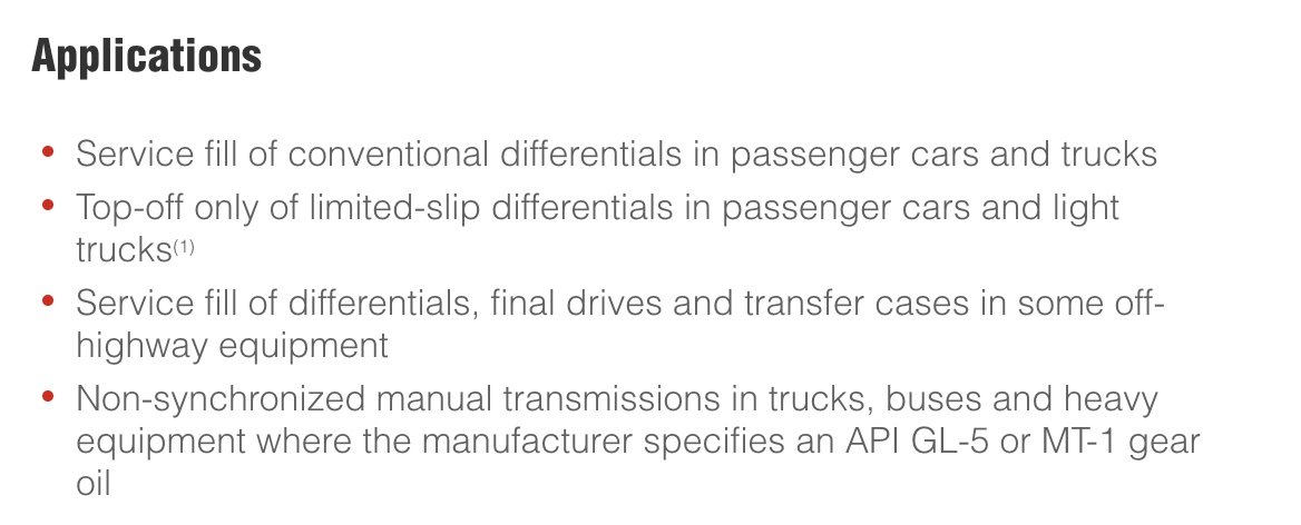

    Went to the dealer for a warranty repair of bad input/output shafts in Manual trans and the transfer case. Service advisor told me they only replaced the fluid in the transfer case but they list using 4 quarts of Trition 75W-90 full synthetic oil. Seems to me that they likely filled both transfer case and transmission with that amount of oil. I'm concerned since the transfer case uses special 75w oil and the transmission requires a GLI-4 oil. What I could find on the triton fluid clearly states its a GLI-5 fluid and should not be used in synchronized manual transmissions. Do I need to drain both and refill with proper fluid? if so how quickly do I need to do this it won't be convenient for another week or so and a few hundred miles. The dealer that did this isn't exactly convenient for me to get to either.

    I’m going to assume the dealer didn’t list the quarts for funsies. They probably drained and filled. It takes right at 3.5 quarts for both so 4 quarts would make sense. If you want to check, just dip your finger in the fill hole of one of them and smell it. If it’s super strong and feels like the smell attacks your brain, it’s GL5.
    It would be best to drain and fill as soon as possible, though a week and some miles will be fine. GL5 contains sulphur which over time eats at synchros, but it is a slow process. In the transfer case it may not even matter however I would think there is probably a synchro to help with engaging 4wd on the fly since the front driveshaft does not spin in 2WD. FWIW Jeep filled the 1989+ Aisin Warner manuals with 75W90 GL5. Later it was caught and corrected but many transmissions ended up with that stuff in it for years and years. It shifted pretty junky but not many transmissions died too badly from it. It mainly just accelerated synchro wear but like I said it takes a while. My Jeep transmission at 20 years old had the stock stuff in it and shifting was still semi decent when I finally switched to proper fluid. So a week will be fine.
    Easiest thing to do would just be order the proper fluid now and change it in a week when you have time. Ravenol sells the proper fluids for both. I would go to their website and grab 3 quarts of semi synthetic 75W-90 GL4, and a quart of their 75W transfer case oil for the transfer case.
    Although really the transfer case should not be picky at all. Transfer cases just need lube. As long as the lube doesn’t eat the synchro (if there is one), then the rest doesn’t matter all that much. You can buy the super expensive Toyota 75W stuff I do you prefer but you will pay dearly and I’m not convinced it’s necessary.

    Yes, that is the wrong fluid for both the transfer case and the manual transmission.

    There is a synchro in the transfer case along with a gerotor pump. There's been plenty debate on this but with the synchro, gerotor, and documented issues with problematic shifting in cold weather with heavier oil it just works out better to use the oil it was designed for. I use the Redline MT-LV.
    OP, you'll find a lot of shops/dealerships/people cut the corner and put 75w-90 GL-5 in everything. It won't blow anything up but it's not the best long term and doesn't go as well with synchros as a good GL-4.

    When GL-5 gets hot, like 200F+, is when it can quickly damage the synchros and other yellow metals. Long term use it will probably damage them eventually, but whether it's enough to make a difference in performance is tough to say.
