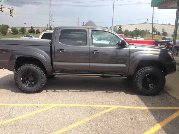

    Here's my kit:
    Suspension:
    Front:
    OME 885 Coils
    Nitro Charger Sport Shocks
    LR UCAs
    1/2" Top Plate Spacer
    Swaybar relocation bracket
    Rear:
    OME Nitrocharger Sport Rear Shocks
    Dakar leaf pack with D29XL add-a-leaf
    CB Drop Kit
    Wheels:
    Wheeler's Steelies 16x8 4.5 backspacing
    285/75/16 LT Duratracs Load E
    When I had my kit installed and I jumped into it the first time, it was noticeably taller. Even people walking past it on my way to the hardware store or Harbor Freight etc notice it's not stock height. The 33's help that but even when I was running the 265 rugged fails, they noticed.
