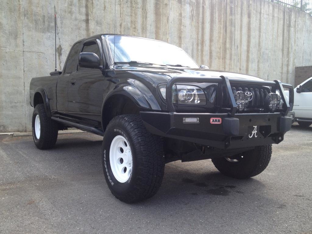

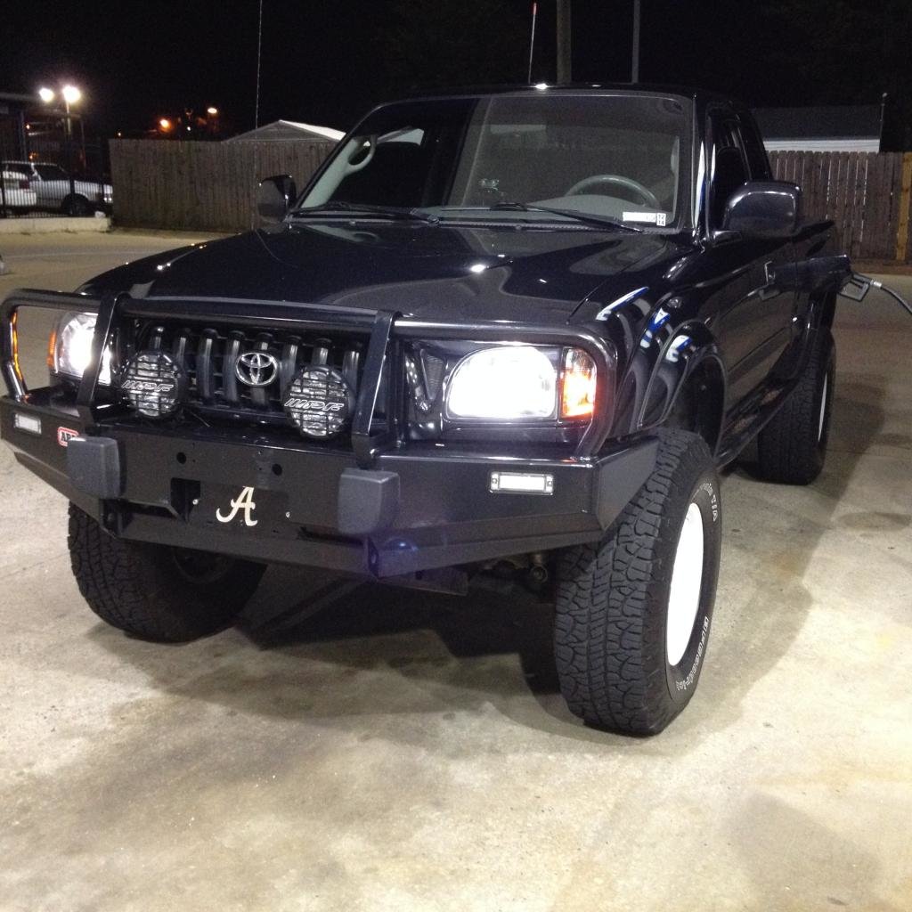

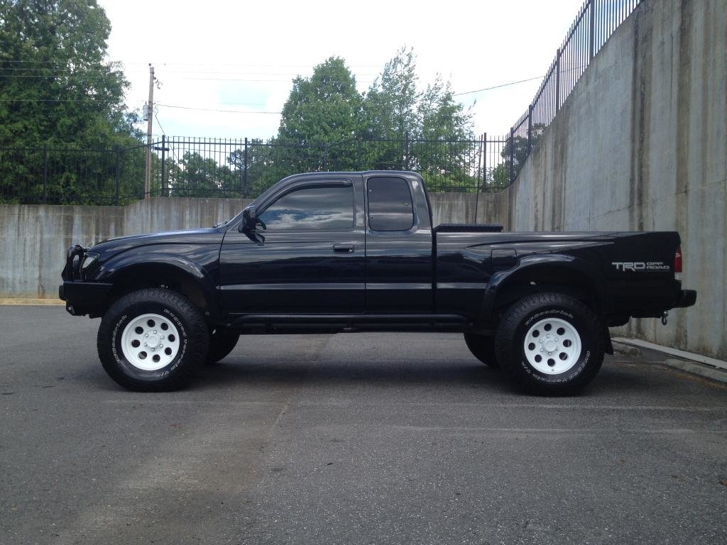

    But seriously, you need to clay bar your paint. Also, I have figured out that Dawn dish soap, as good as it is at cutting through "tough grease and grime", does not cut through wax. The only way to REALLY remove wax is to use degreaser. It's sketchy bidness, but it gets ALL the wax off. I've done it once. A long time ago. And that shit worked. But you definitely need to clay and then wax immediately afterwards. IMMEDIATELY.
    You could prob get away with using 1:10 Purple Power with water, but I sprayed water on the truck, then used a spray bottle of purple power and sprayed in sections and then spread it around with a sponge, let it sit for like 10 seconds and then sprayed it off. YOU DO NOT WANT THIS SHIT TO DRY ON YOUR TRUCK. I don't know what will happen if you do that, and I didn't want to find out.
    If anyone thinks I'm crazy, then look at this ten year old paint and tell me I'm crazy.
    I also did a couple of passes at one point with Meguiar's Ultimate compound on the whole truck. You may want to do that after you degrease (if you decide to do this) and after you clay. I also use Zaino wax. I will not use any other wax on my truck unless it's Zaino. Basically I'm a walking Zaino salesman that doesn't get paid.
