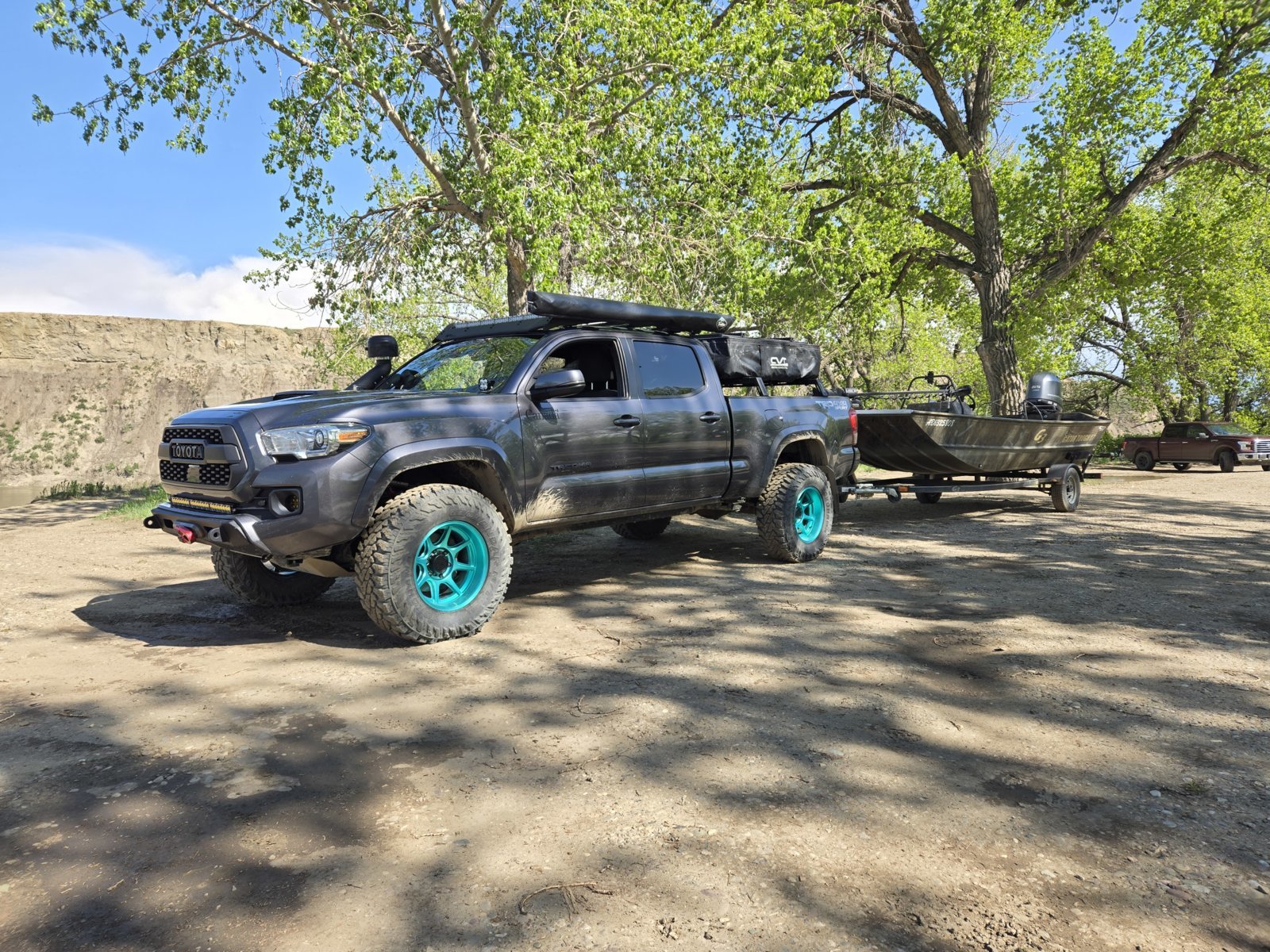

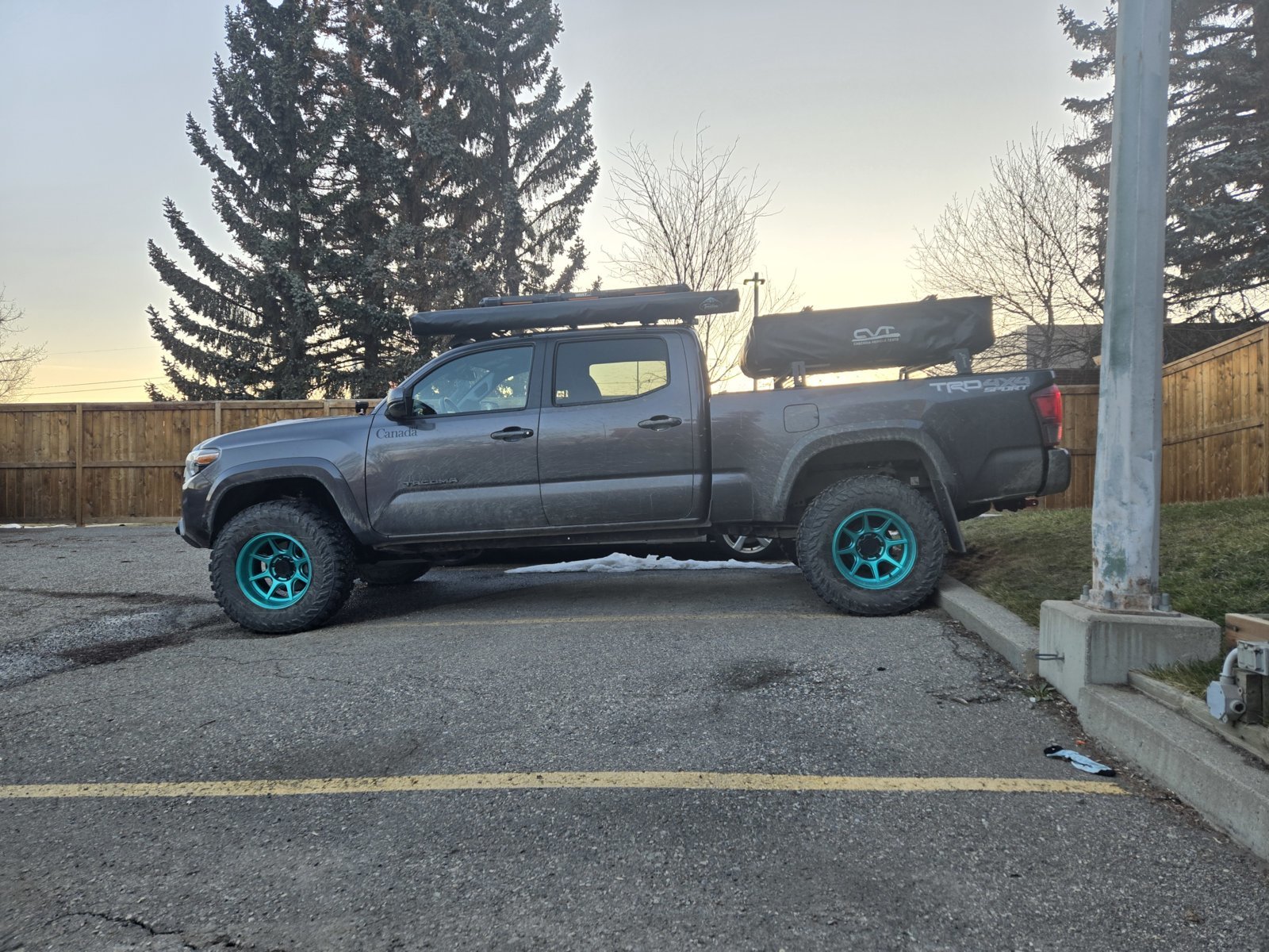

    I had ome 111's and found they flattened under damn near any weight so I swapped to dobinsons 112's and have been way happier with them. I have a tonneau and tent with a recovery bin in the back that's pretty heafty at all times maybe 350lbs total constant load and it rides perfectly fine. But when it's fully loaded for a long trip is where they shine.
    Keep some rake to the truck they honestly drive better than leveled trucks.
    In my opinion stick with the 112's
    111's cap empty bed
    112's full load
    111's height no load
    112's height with 350lbs ish load
    I personally wouldn't recommend a 111 after running a 112.
    Note dobinsons lists different carrying capacities for a long bed vs short bed
