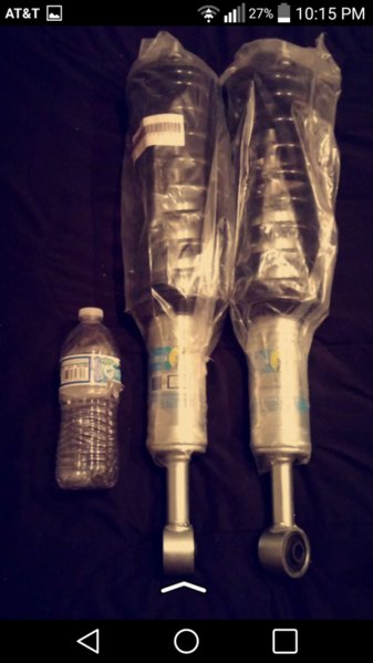

    Hi guys,
    YotaDriver631 is selling his TRD Off road suspension off of his 2015 TRD Off road and i was wondering for $300 would it be a good idea to buy that suspension and put it on my base. Will it make the ride a lot better and is it worth the upgrade over the base suspension? Or should I just save the money and wait til I do a 2 or 3 inch lift in the future?
    Link to his Suspension:
    https://www.tacomaworld.com/threads/fs-tacoma-bilstein-oem-shocks-springs.385057/#post-10576201

    Where at? Cause that guy messaged me and said he will do $275 for that TRD suspension shipped. So i was kinda wondering if it would actually be worth taking my stock stuff off my base and adding that since i probably wont put a lift on it for a few years? What u guys think, if im not going to install a lift right now?
