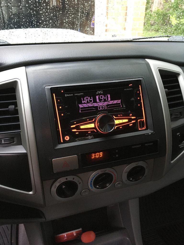

    The stock head unit in my truck was terrible, I have an aftermarket exhaust and I had to turn the volume up to 30 to be able to hear it on the highway. I also wanted XM radio which my stock unit didn't have, so I just replaced it with a JVC from Amazon for $100. It made a big difference!

    That's a good lookin head unit, and a great price as well!
