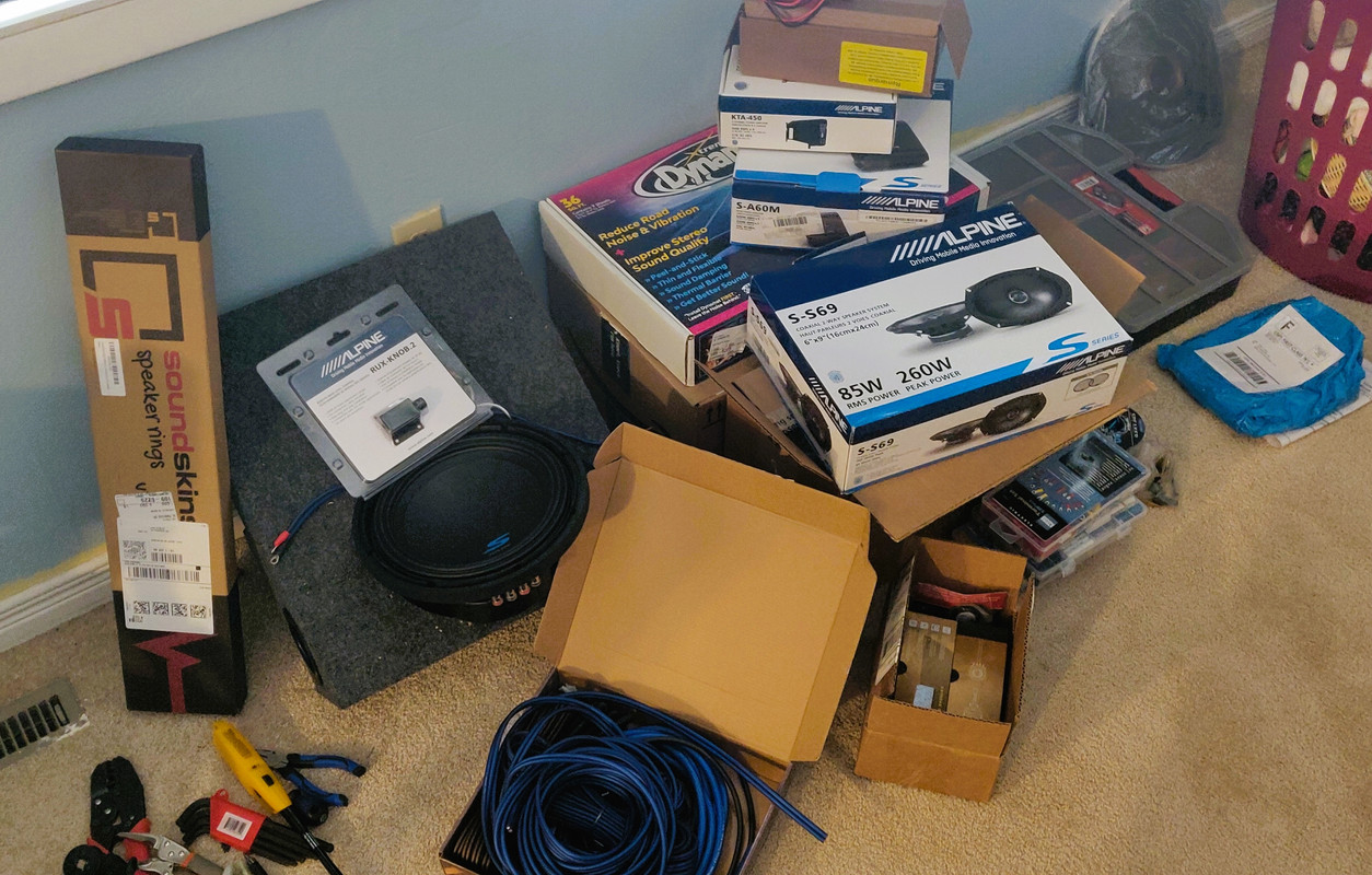

    16X9 black TRD wheels Turn signal mirrors w/ MESO sequentials (had to hardwire these as no factory harness) Full interior LED upgrade Full Taillight LED upgrade Intermittent wiper stalk added Kicker 47KSC6904 & Subaru tweeters up front Kicker 47KSC6704 in the rear (had to hardwire these as no factory harness) Alpine S-A32F Amplifier Upgrades on the horizon: Subwoofer TBD CaliRaised Molle system for the bed Hiline Series Front Bumper
    I replaced the tweeters with the Subarus and HUGE difference in highs as others have stated. I swapped the fronts for the Kicker 47KSC6704 & added rears, which I had to hardwire it being an SR, with the same. Huge improvement in all departments, but I just couldn't get much sound out of the rears. I learned, after reading a few other posts on here, that the stock HU sucks at providing a balanced output to all 4 speakers. This weekend, I'll be adding the Alpine S-A32F so everything has the same power hitting it. I'm thinking that will be fine for me, but if I need more bass.....I'll do some more research and work on that...

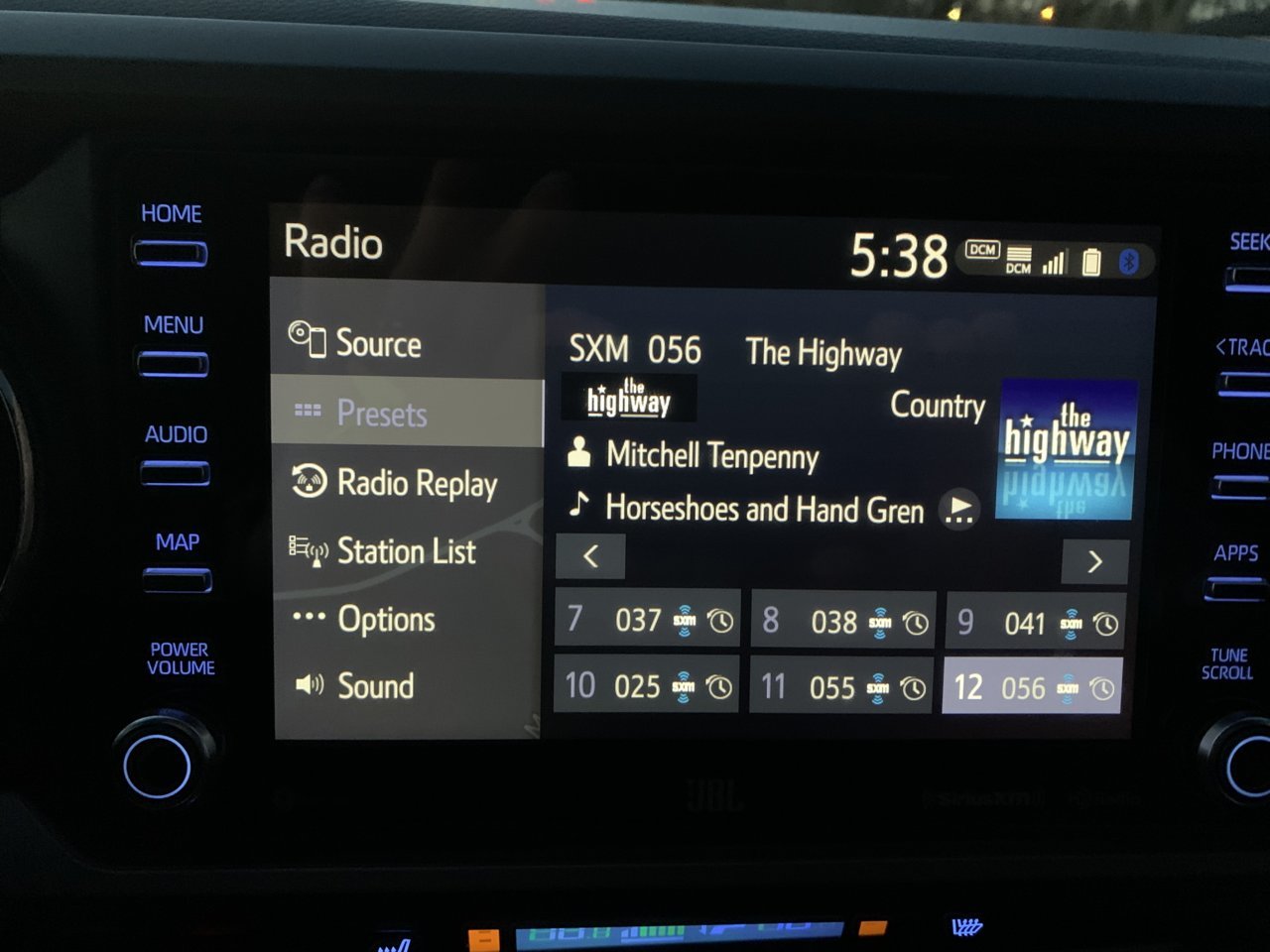

    So I was wondering about the picture on my display, as seen in the attached photo, do I have to see the column to the left of the SXM stations or does it appear there all the time. I think in my wife's Camry you just see the stations expanded and no column on the left side. Please advise. Thanks

    They are JBL OEMs, so they are just mass produced to be slightly better than the speakers coming out of the factory next door. They have to balance cost, weight, and performance. Usually performance is the first thing to get cut down to meet cost and weight.

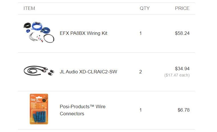

    I ordered everything from Crutchfield. They have several packages for the wiring of the amp, but I'm not aware of any single harness. The RCA to output cables are just wire on one end, so I'll be splicing those myself. Everything else is basically the same. Here's what I used. I bought my own speaker wire.
