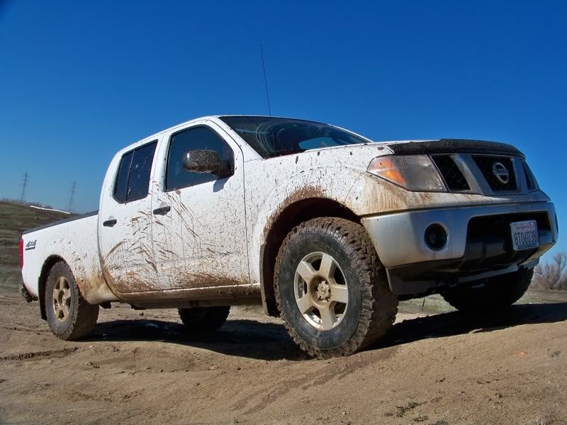

    Man what's weird, I put plus 2 size tires BFG, AT's on my old '08 Nissan Frontier 4x4 Crew Cab with no lift, all stock. No rub or trimming anywhere, truck rode nice like that too. I will dig up a pic.
    Suprised I can't do same with a 2nd gen Tacoma. Seems like a Tacoma has more room in the fenders than a Frontier. More ground clearance as well.

    This was +2 size on my old Frontier, with no lift or level. Worked perfectly, loved the look actually. Was hoping to do the same for my Tacoma. Hated that truck otherwise though : )
